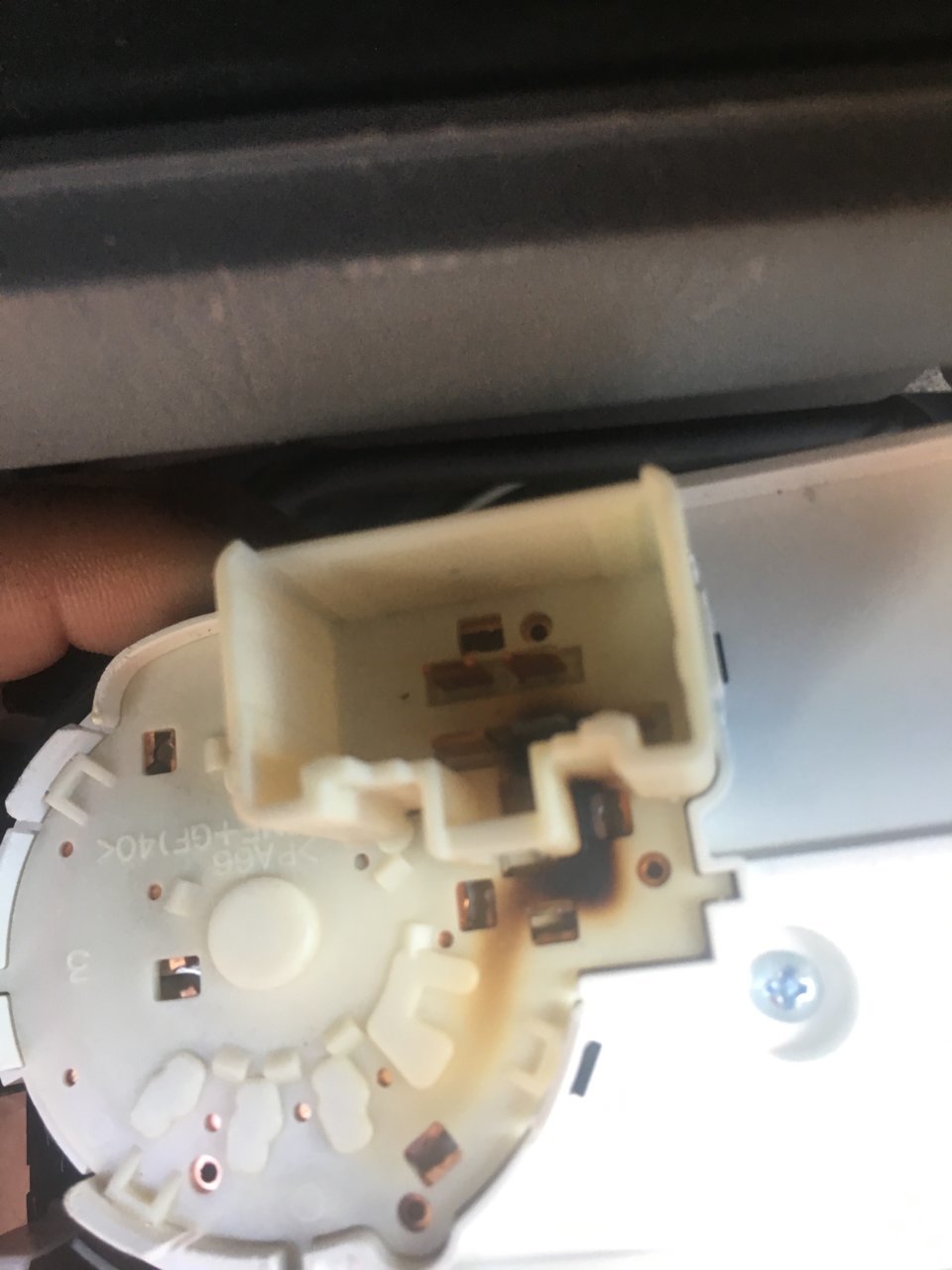

    I just went thru this whole issue. First there was only high fan. That went on for a few months. Then no fan at all. Found the fan switch and connector burned pretty bad. Blower resistor connector also burned. Blower connector not burned.
    Removed the blower motor and measured DC resistance at around .5 ohm compared to 1 ohm on new motor. Repaired fan switch and changed blower resistor and connector.
    It’s my opinion that the blower motor windings are deteriorating and causing high current draw which is frying connections elsewhere in the system.
    Check your blower. It’s super easy to pull out and a new one cost me $29 on eBay. Not factory unit but fit and works perfect at 1/5 the price.
    I hope the fix holds up long enough to get thru the summer. Way too hot here in Sacramento to go without AC.
