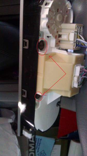

    guys take the control panel out it pops right out ith prying from bottom. Youll see 2 places on the back i think their brown their is a little slot in it quarter trun takes it out. its the led bulb go to dealership and have them order you one there speacial order be in the next dayand is about 12 bucks. when i had my 06 i thought it was the cluster but its only the little bulb

    nno soldering its just a quarter turn
    Repeat DO NOT SOLDER there is no reason too

    nope had the same problem and thought tthey were soldered to the board so a friend told me to pop it out like when u need to get to screws for radio and on the back there are 2 spots. ill see if i can find a pic

    that post has nothing to do with the problem. its not rocket science take the bulb out as i said and get a new one. theres nothing more to read into it. I just took the pic from my 11 and it is the same as my 06 they havent changed
