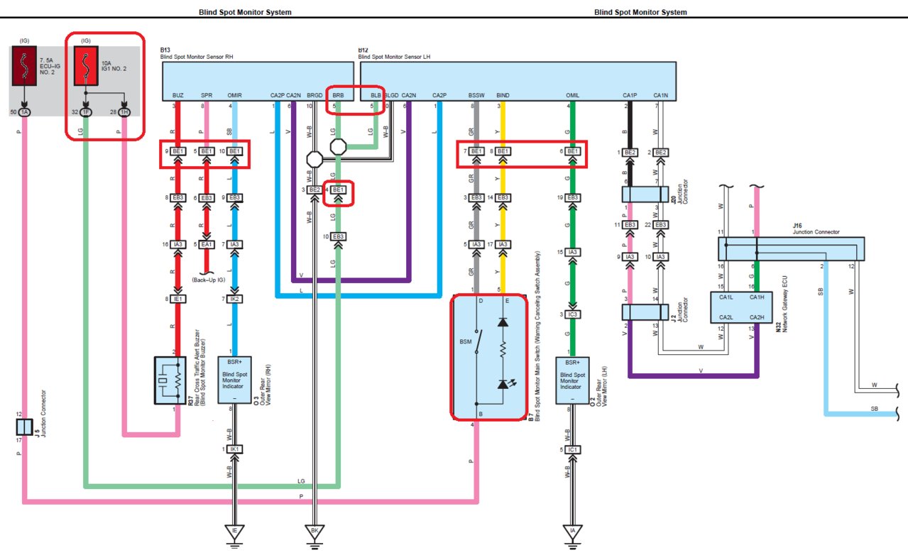

    OP, since now the added info on a non-working BSMS is fact, that points more of the problem being tied to the A/C issue. Specifically the fuse that provides power to both systems.
    Just removing the switch to the BSMS system cuts the power to turn that system on, but the fuse that is doing it's job (blowing) has a direct connection to the doppler radars at the bumper corners.

    With freezing weather, the plastic n metal (wires) changes and behaves differently. My guesstimate is it was failing and now if has completely failed (the wiring at the rear bumper)
    But I just looking at the problem flow chart and the circuit drawings.:notsure:

    At least the techs can't take you on a wild rant. You have an idea of the problem spots. Rear harness, A/C amplifier, A/C control assembly would be usual suspects for you.

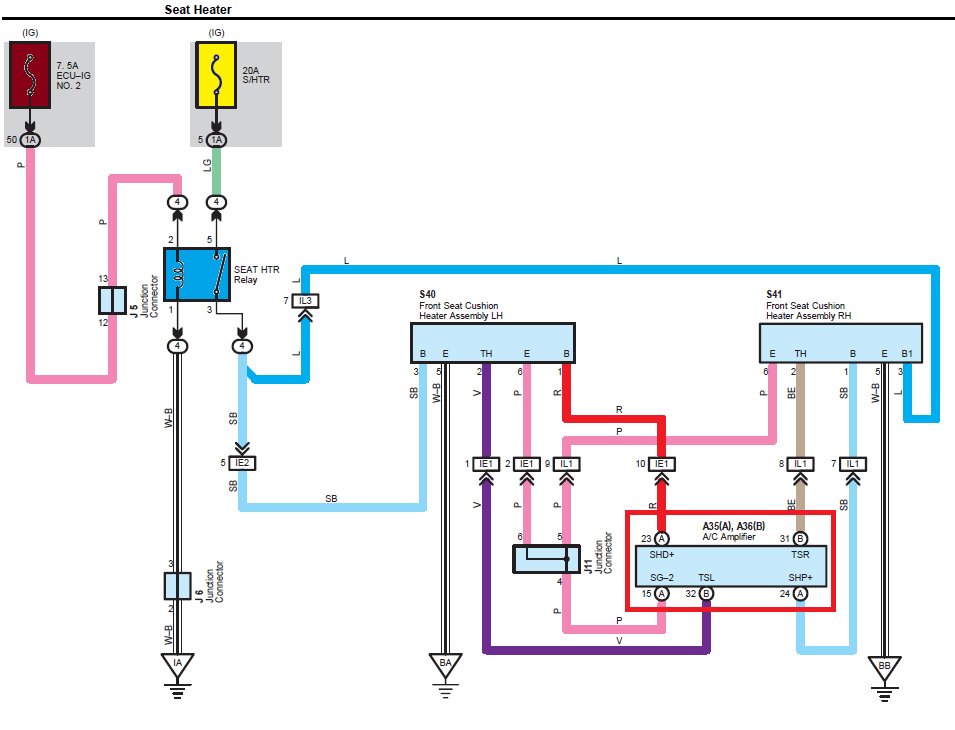

    The seat heater sends inputs to the A/C amp:
    That is why we had the fuse (20A) removed, to isolate that system.

    The fuse to the relay that provides juice to the blower is fine, the relay coil fuse is the one popping. It also provides juice to the BSMS system.
