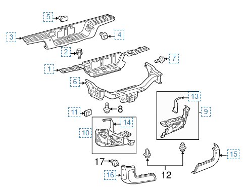

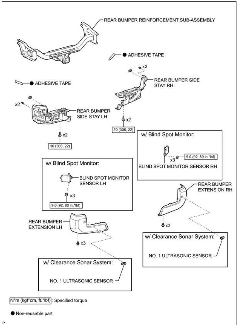

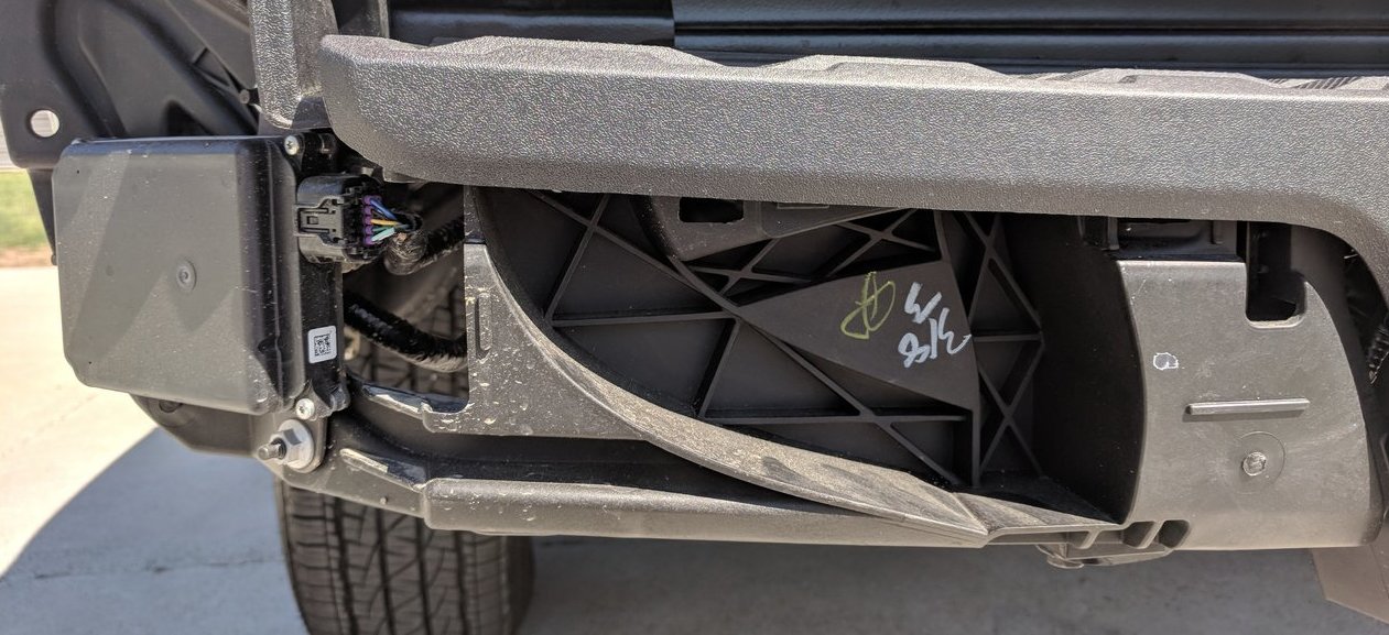

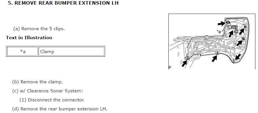

    so I’m back to square one! I am fairly convinced it’s the Blindspot monitoring system like you have suggested. I am prepared to check out the pigtails etc. on my own but I cannot find a manual on how to access them. I can see them through my rear tailgate so I could take that off or do I need to remove the bumper?

    No need to remove the bumper. Just the plastic covers.

    Where are you getting these service manual images from? I have searched a few forums for the service manual and only get one that has electrical information/troubleshooting ‍♀️

    TIS
    techinfo.toyota.com
