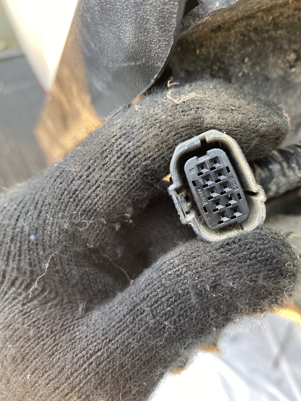

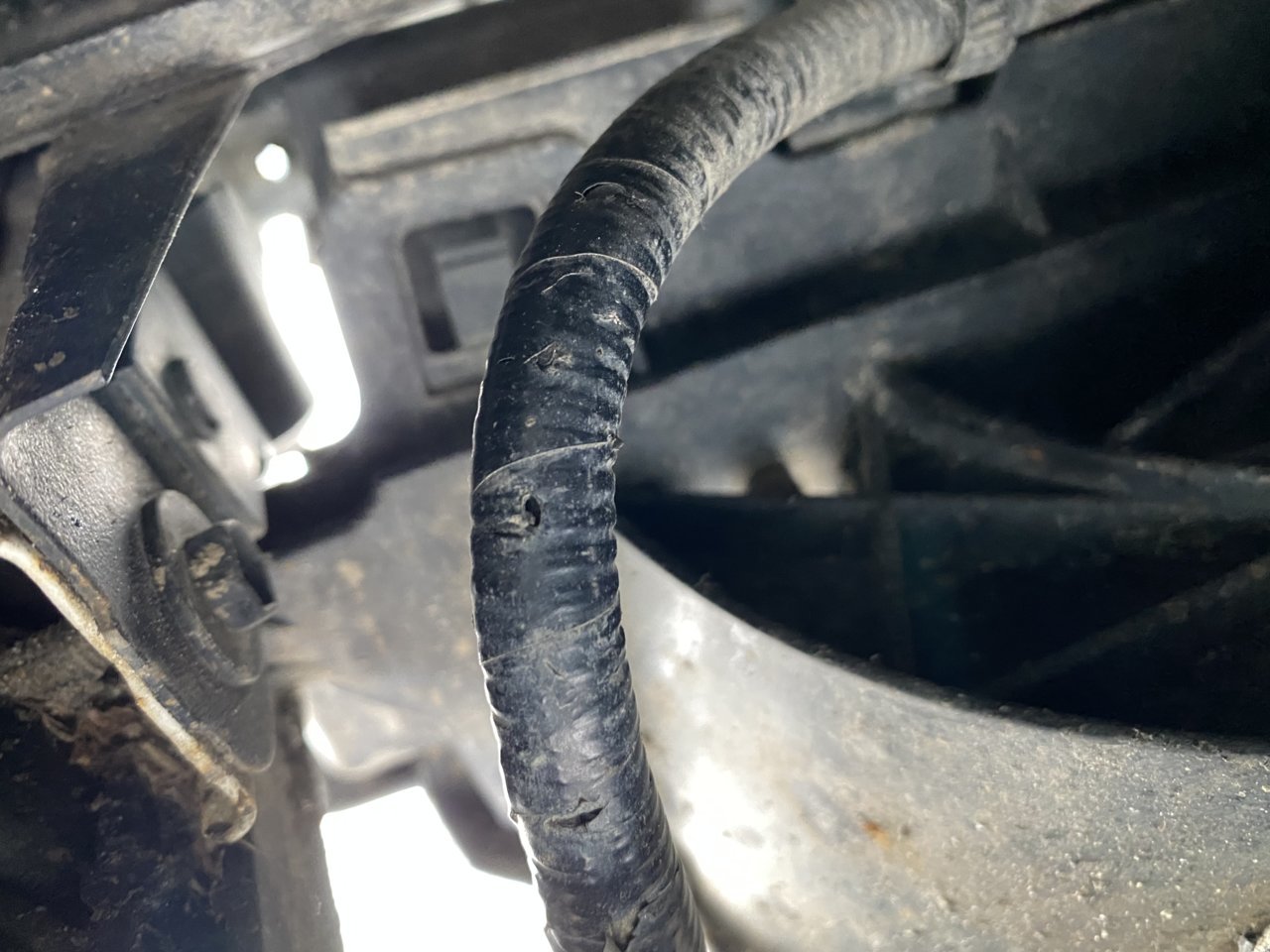

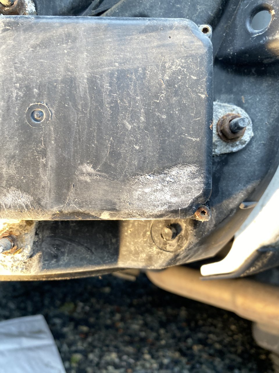

    Seems like it might be the right bumper sensor. Took off plastic panels and this one looks like it has some evidence of corrosion inside the sensor housing and a gouge to the connector. I unplugged it and replaced the fuse and everything works again.
    I wrapped the wire casing in permanent sealant tape and wrapped the exposed wires to the harness in electrical tape (well). I’m hoping water was getting into the wiring and causing an issue? I’ll see if this fixes it. If it doesn’t then I might just disconnect and plastic seal the ends or take it to Toyota for them to open the housing and take a look. I can’t open the housing. The nuts are corroded/rusted. D5518C22-1EB1-47FA-BD7A-C29B0739287B.jpg 2B7376AB-D5CE-42F7-90AC-A02A90D24C5F.jpg

    That sensor is a remove & replace deal, no repairs for it. Beaucoup dollars for replacement and "adjustment".
