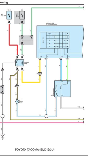

    To make it simple. First check the IG1 NO2 Fuse it is rated at 10 amperes. Check the 50 ampere heater Fuse also. If both of those are good you should have 12 VDC at the blower on a black wire with a yellow stripe by my prints. You need a voltmeter set to read DC Voltage and then verify that you have 12 VDC at the Blower Fan on the Black wire with a yellow stripe. NOTE: This voltage will be there regardless of the fan speed selection. The ground is what is regulated through the resistor block.

    I've been trying to solve a fan switch issue. I've read this whole thread, done a variety of tests and have come to a conclusion.
    Symptom: Fan / blower will not work. Not on any speed.
    I've checked the blower motor. It's good.
    I've checked the resistor, it's fine.
    I've checked the wiring harness that connects to the resistor. No burnt or discolored leads.
    I've checked the wiring lead by the resistor and there is no power at the connector.
    So what to check next?
    Where is the heater fuse located?
    - I've checked the fuses inside the cab.
    - Isn't there one in the main fuse area in the engine bay?
    Is there are relay that could be sticking?
    What about the in dash switch itself?
    - Could that be the problem?
    Thank you in advance for any help you can provide.

    Fuses? The high setting should be hot all the time ign is on.

    That' what I'm thinking. But isn't there a 50amp fuse in the engine bay fuse block?
    What about a relay? I think there is one too.
    I'm just trying to verify their locations before I start pulling on things .
    Thanks.

    Someone may have a diagram of that. I have nothing for a 2012. Pop the cover on the fuse block,it should have them listed.

    @Questor Here's a clip from the 2006 diagram.

    Yes there is a 50 ampere fuse in the engine bay called "Heater".

    I checked the 50 amp fuse under the hood and it's good. I even swaped another 50 amp to see if that made a difference. Nope.
    Then I swapped out the Heater Relay with a relay from another circuit, and the blower worked!
    I guess the relay got tired...
    I'll replace the relay, and be happy with my truck again!
