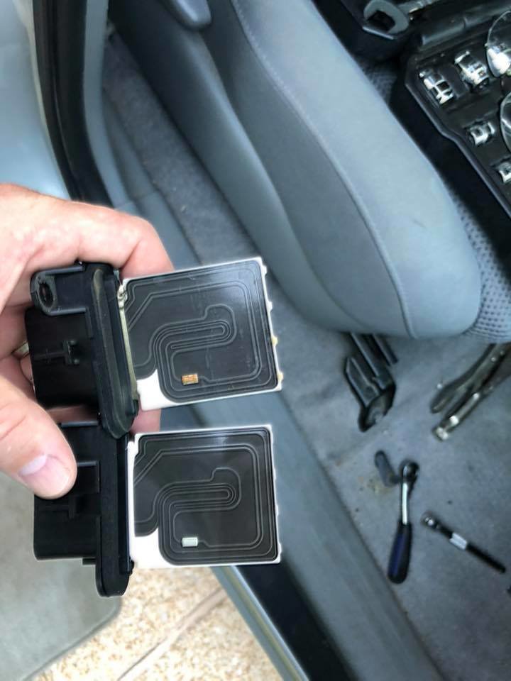

    I initially took apart the blower motor, cleaned it and reinstalled. That worked for about a week until the same issue occurred again, only working on High.
    I then replaced the resistor and 4-pin connector and that worked a bit longer, maybe a month and then same issue again. This is when I started hitting the blower motor to get it working. Did that for about 3 weeks until I started getting an electrical burning smell when running the fan.
    There are quite a few threads on this issue but glad I came across this one because it had the part numbers for the 2-pin connector and wires that connect directly to the fan. It was SEVERELY burned.
    I replaced that and so for it’s beem working fine on all speeds, no burning smell for about 2 weeks.
    I hope this is a permanent fix but I’ll keep an eye on the connectors.

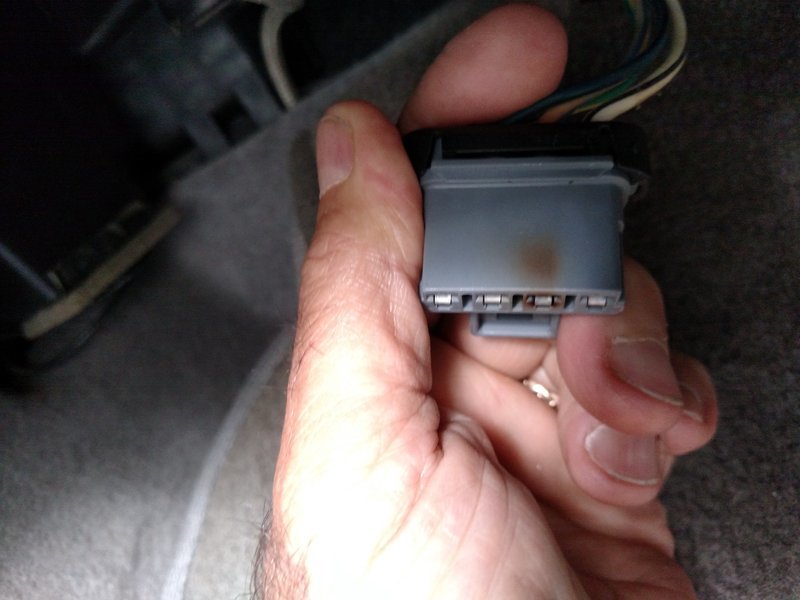

    @Jimmyh Thanks for the heads up, I went back to my guy and grilled him about the work he actually did and he admitted to just ordering the part sight unseen, my business is gone from there. I took my glove compartment off and found that the power plug is burned just like this guy....
    Look like this is the fix....
    Which you linked before. Thank you again! Need to check the resistor as well which I think may also be burned.

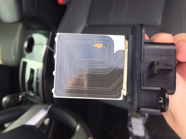

    My blower would completely stop when I had the AC working on High Max. It would come back on if I operated the fan switch a couple times.
    I replaced the resistor. I didn't have any burn marks on the plug, so I didn't replace that. The old resistor had brown marks in a couple spots, so I assume it was bad. So far I haven't had any further issues.
    37033829_10155463237097377_2537298865514_c898b0eb7f1879ab35c73d587ca11a5a7df2dcd5.jpg
    Replacement was easy, however took some patience to get screws back in. Could they have have placed the resistor any closer to the fire wall? Rear screw was a booger to get back in since you can't see what you are doing.

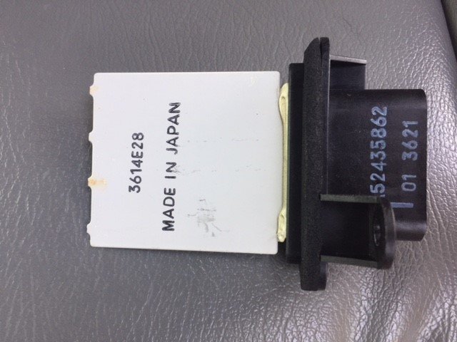

    Seconded. In my 2013 the plug had no burn marks but the resistor did, as @brianscha4 has pictured. I replaced my resistor with this $24 one from Amazon (https://www.amazon.com/dp/B00G6FDT7E). This is not a ten minute job thanks to the location. OP's 10 minute expectation turned into an hour twisting and turning trying to remove and replace the two screws and keep the back screw from falling behind the carpet. Also, I used a 7/32" socket.
    You can see the burn marks on both sides of the resistor.
