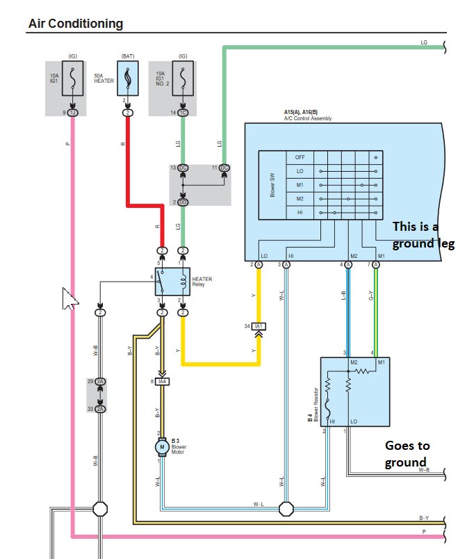

    But the diagram I made gave me exactly what I was looking for, a relationship between the speed settings with a DC motor load(exact dc motor settings don't matter) to help one understand why Toyota might have used a larger wire for the low speed on one year and M2 on another year. I can't help it's not worth anything for some people.

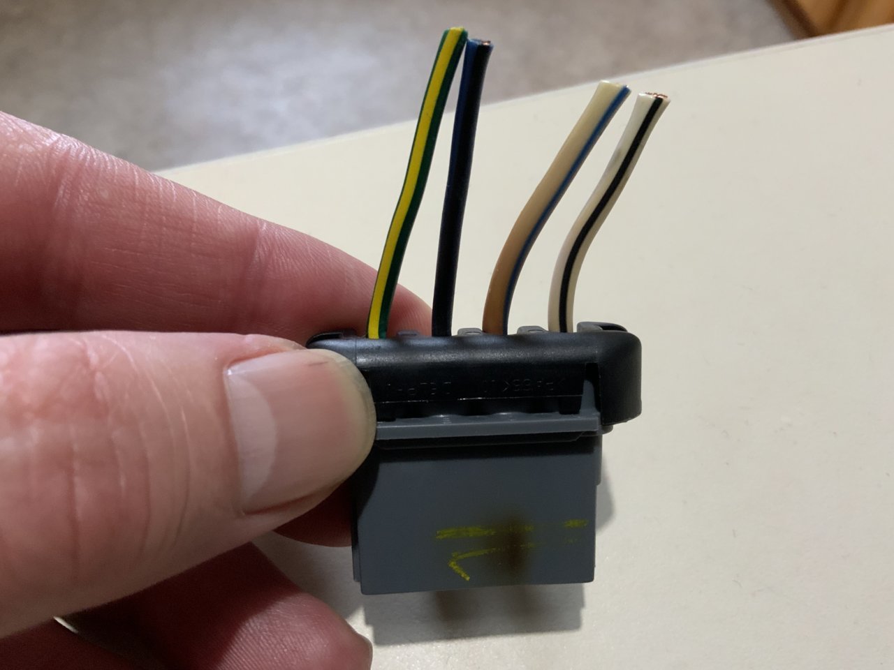

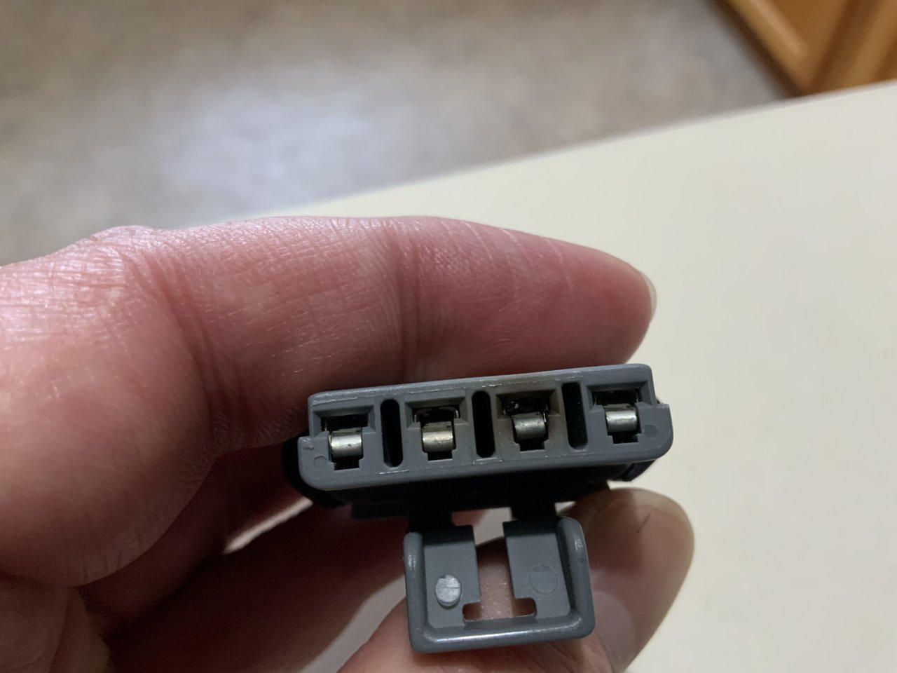

    Yup, happened to me as well. Discolored the whits wire and melted into the connector. Ordered the Dorrman kit off Amazon. Got to be careful with the back screw as if you drop it, it goes behind the carpet. Works like a champ now.90F86ADC-32FA-4887-9E1E-2F4841ADCBC6.jpg9151735F-F5B8-4223-BC24-055ECC4751BB.jpg

    This is what you need for the connector that plugs into the blower motor:
    Part number 90980-10916 Connector
    Part Number 82998-12380 Wire and terminal
    Not sold as a kit, sold as each. So you will need one of the plugs and two of the terminal and wires.
    Connector:
    Terminals:

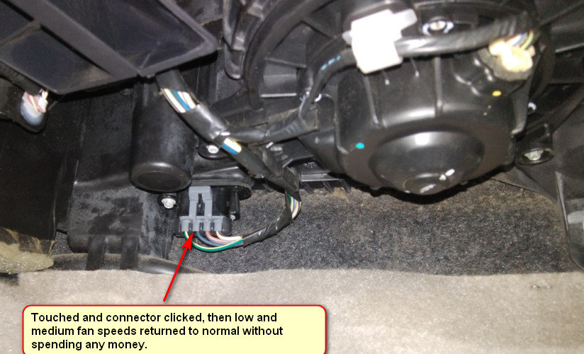

    I touched the connector and it clicked, then the fan came on normally on the low and medium settings. We'll see how long this lasts. This happened on my wife's 2006 Toyota PreRunner, I showed her where to touch the connector in case it happens again. No cost so far.2021-07-30 Low and Medium Speed Blower Fix, Toyota Prerunner.jpg

    The reality of the issue regardless of whichever connector is burned/over heated is a loose connection between the male and female connection points. It boils down to this as a simple explanation:
    A heating element in an electrical circuit is just a wire with a higher resistance. This resistance when current passes through it expends energy. This energy is converted into heat. This heat is what is burning the connection. The heating cycles hot, cold, hot, cold... causes the metal to weaken and the resistance increases, heat increases... until you end up with what you have now.
    Some people think this is due to too much current, but that is untrue. An overall over current condition would heat the entire wire not just a local heating.
    Replace the connector with new terminals and clean up the motor connector and you should be fine. Just make sure the terminals fit tight when pressed together.

    If it clicked it wasn't pushed on completely.

    The Motor has 12 VDC at the connector all the time regardless of what speed it is running. The resistor works by changing the resistance of the ground leg.
    The Short answer: Yes it could be the A/C Control Switch or the connector in the rear of it that may also have a burned connector. Pop it out and look at the connector first.
    12 Volt Battery >> 50 amp heater fuse >> Heater Relay >> Blower Motor >> AC Control Assy >> Resistor >> Ground.
