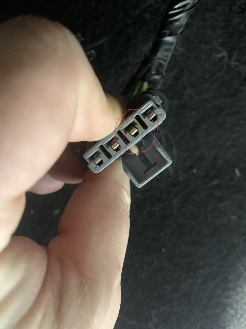

    The main issue is the parts are supplied by (Delphi) General Motors.
    Loose connector brought on by a build up of tolerances causing a loose fit. I have seen others use your method of twisting the male terminals and I have used solder tinning on the male terminals to tighten them up.

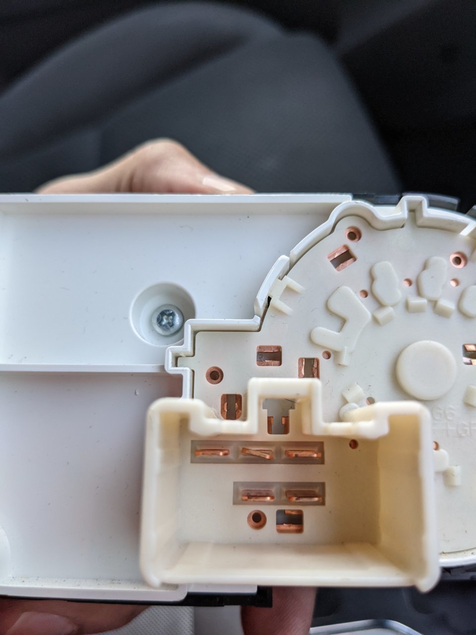

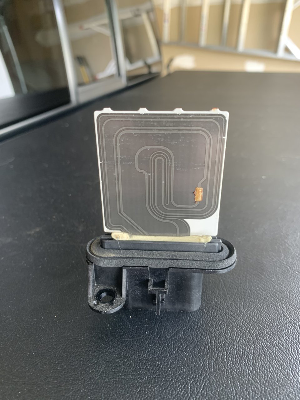

    Here is a photo of the modified climate control unit on the 2012-2015 models. You want to make sure you tweak the full blast pin otherwise risk burning up the climate control unit and the plug.
    I did this a while ago and left the connector as is. No issues or further damage to the connector pin from today's observation.
    The resistor connector, however is starting to heat up a little bit past the norm and slightly affecting the connector. I'm going to remove the resistor and tweak the pins as well and then blast some Deoxit D2 in there to prevent further complications.

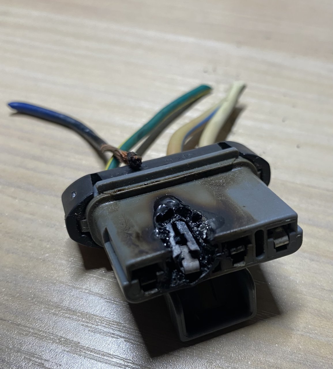

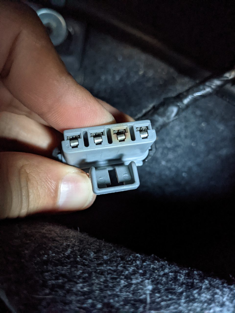

    upload_2022-8-7_21-31-15.jpg upload_2022-8-7_21-31-15.jpg If your part of the “wiggle” wire crew and procrastinating a fix, keep a close eye on your plug. This is how far mine made it before it finally failed completely and my fan stopped working.

    If you know this is a problem, don't wait for there to be a fire.

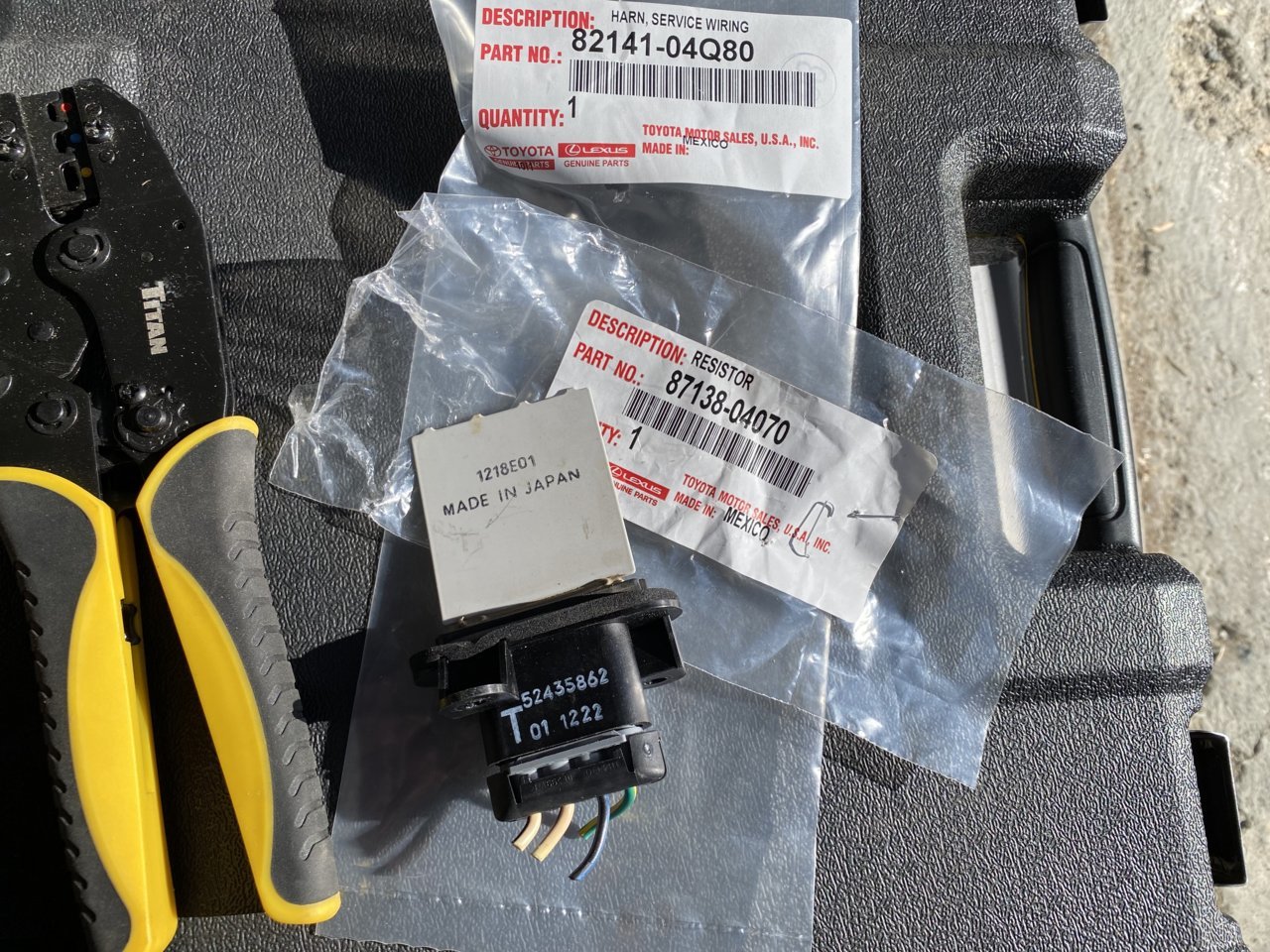

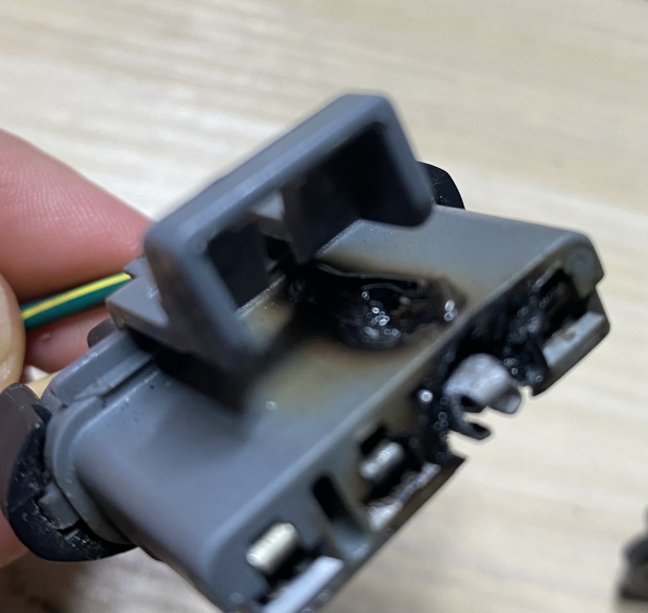

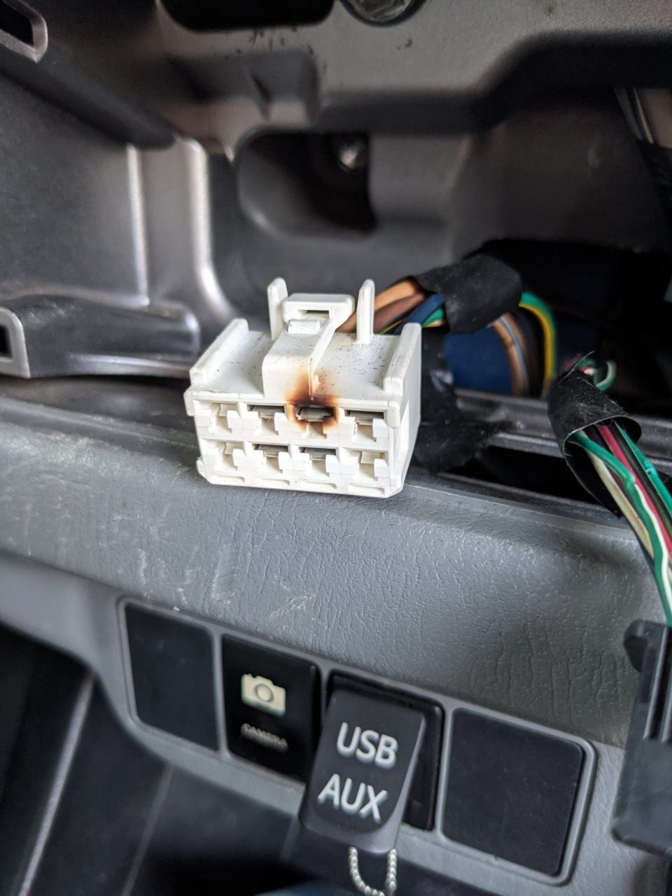

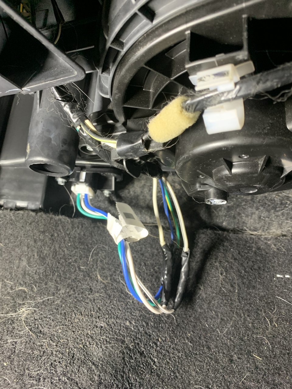

    So I pulled mine and this is what mine looks like…a little burned section
    This is the only one I see that I can pull based on the pictures from the thread

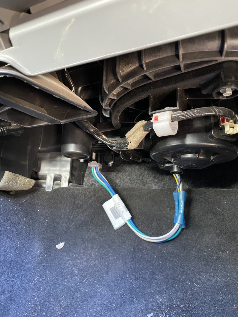

    So I followed the wiring diagram(color-to-color) from the forum. Installed the new parts, rewired, buttoned up and everything works good again! I zipped up the wires so they don’t hang down like in the picture. Seems to work just fine on all settings. Thanks again to this forum.
    And tomorrow… I start the GMRS RADIO installation…and yes that’s dog hair everywhere. Trust me I vacuum every Sunday but Golden Retrievers make it hard.
