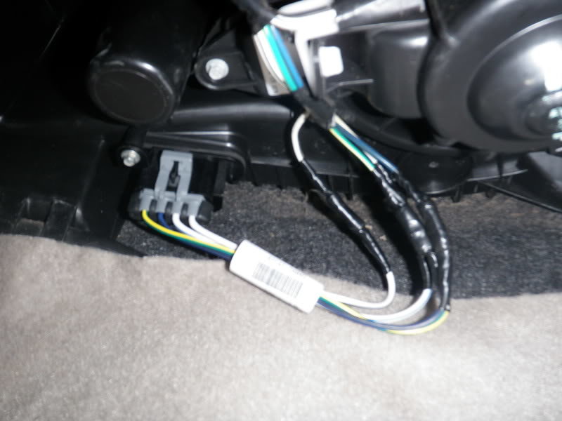

    My fan only works on high now, too.....but it worked correctly intermittently for a while; now it only works on "high"...Where is this resistor?

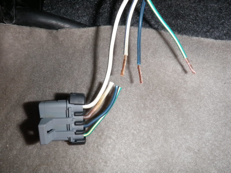

    Passenger front kick area, under the dash, just a little to the left. 4 wires in a connector. Wiggle that connector and see if your fan works again.
    If you disconnect that connector the resistor is sitting in the top of it, hidden from view when connected underneath the fan box.

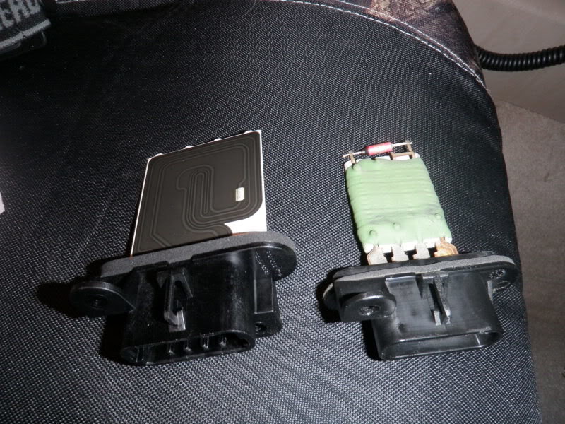

    Having been on here for a while as only a bystanding reader since I bought my '11 AC, I have done a bunch of searches and found lots of help. Thanks to all!
    On this topic, I learned all about the resistor, the bum plug and lead wire, the upgraded blower and all the related stuff to know. Having experienced the same "noisy on high, only, and nothing else" symptoms a few weeks after buying my used Taco, I delayed taking it in for warranty service. Before going down to the stealership, though, I pulled out the cabin air filter and found it clogged with cottonwood tree seeds! I suppose the PO parked under one with the engine and fan running at work or something. I pulled out all I could and inserted a new filter, but I am guessing a bunch of that junk got into the blower motor and caused the resistor to, um, resist, and burn out.
    When I got it down to Toyota, they found some bits of seeds I had left behind and noted "rodent infestation" in heater assembly, so no warranty joy for me. I know mouse nests when I see them, nd there were no feces in this clump, so I am confident it was just sucked into the air intake. They even told me they found evidence of similar rodent damage in the engine air intake. Duh! Why would mice only nest where high velocity air is sucking in past them?
    So, their bad assumption made me ineligible for the warranty resistor replacement and I just ordered up a new one, plus the blower/fan assembly. I'll do the work and know it was done right.

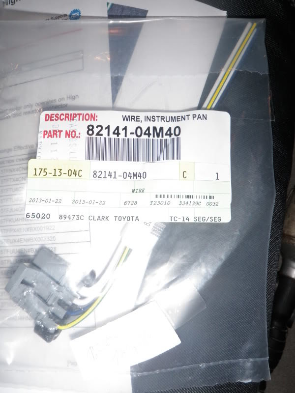

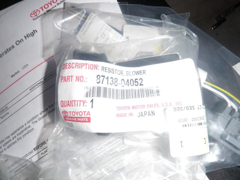

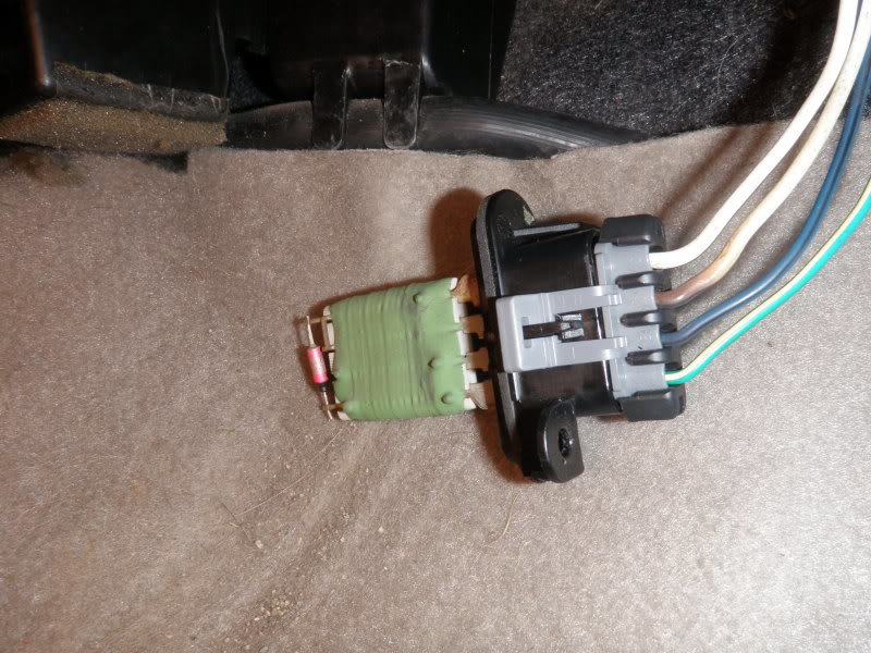

    Nausetnuts, EXCELLENT find regarding TSB-0149-11. The connector, White/Blue supply wire, and resistor are heat damaged/brown on my '06 ride. I will order the harness and updated resistor and be done with it...already installed the upgraded fan motor and it's been noise free for over a year. :cool:

    I found the resistor very easily and the white/blue wire was a little brown right by the connector. But I simply sprayed electrical contact cleaner that I got from Home Depot onto the connectors (both the wire end and the resistor connector, re-inserted the connector several times, and its been working fine since....

    I got mine to work by just replacing the resistor. So far so good and did not have to cut and splice any wiring. I do have the new wiring if ever needed but so far just changing the resistor did the trick.

    I just ordered the resistor and wire harness pigtail from E-bay for considerably less than my local Toyota dealer wanted. Reading through the long history of this thread, there doesn't seem to be a lot of mention about the role that a dirty or neglected cabin air filter plays in the equation. I see some posters mentioning they were unaware that a cabin air filter even existed. I think this oversight might also be playing a part in the failed/noisy blower motor problem as well.
    I plan to remove the blower motor, clean and lubricate the output shaft/bearing, then start with a fresh air filter. I think this should be standard procedure when replacing a failed resistor, but that's just my opinion.

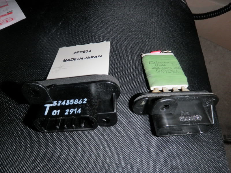

    Those of you who have replaced the resistor more than once, Did you use the OEM part number, or did you use the upgraded part number from the TSB? (87138-04052)
    Specifically, I would like to know if the upgraded resistor is solving the problem or not. How long between failures?
