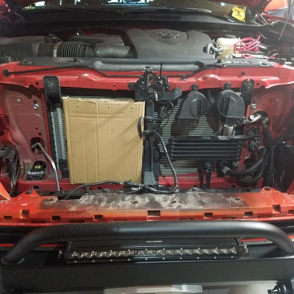

    So are there benefits to pusher fans vs puller fans? I ask because I'm about to upgrade my trans cooler to a larger unit and will be able to fit a 10" fan on the new trans cooler.
    For the discussion let's assume were comparing identicle fans with the same CFM rating and both installed in the correct orientation. I should have plenty of room the mount the fan on either side of the cooler.
    I would guess that a puller fan has an advantage since it keeps the face of the cooler open to the air forced in by driving. I'd also think since the fan is mounted on the back of the cooler there would be less turbulence of the air exiting the fan and potentially help to add some cooling performance to the radiator?
    This is just speculation by me so I'd love to hear if anybody has the facts?
    Thanks!!

    Thanks for all the replies! It's really appreciated. I'm looking at hayden cooler that's about 11"X11" I made a cardboard mockup and shouldn't have any issues getting a fan in the puller orientation.
    So could a puller fan mounted on the trans cooler also improve radiator efficiency since it's pushing more air over the radiator in tandem with the oem mechanical fan?

    I'm talking about putting a puller behind the trans cooler (in between the the radiator and new "cardboard" cooler). The fan will be affixed to the new cooler. Overall airflow would be pulled through the cooler toward the engine and on through the oem mechanical fan.
    My explanation is probably convoluted but the new cooler will be mounted similar to the small OEM transcooler on the core support and not directly to the AC condenser. There is plenty of room there.
