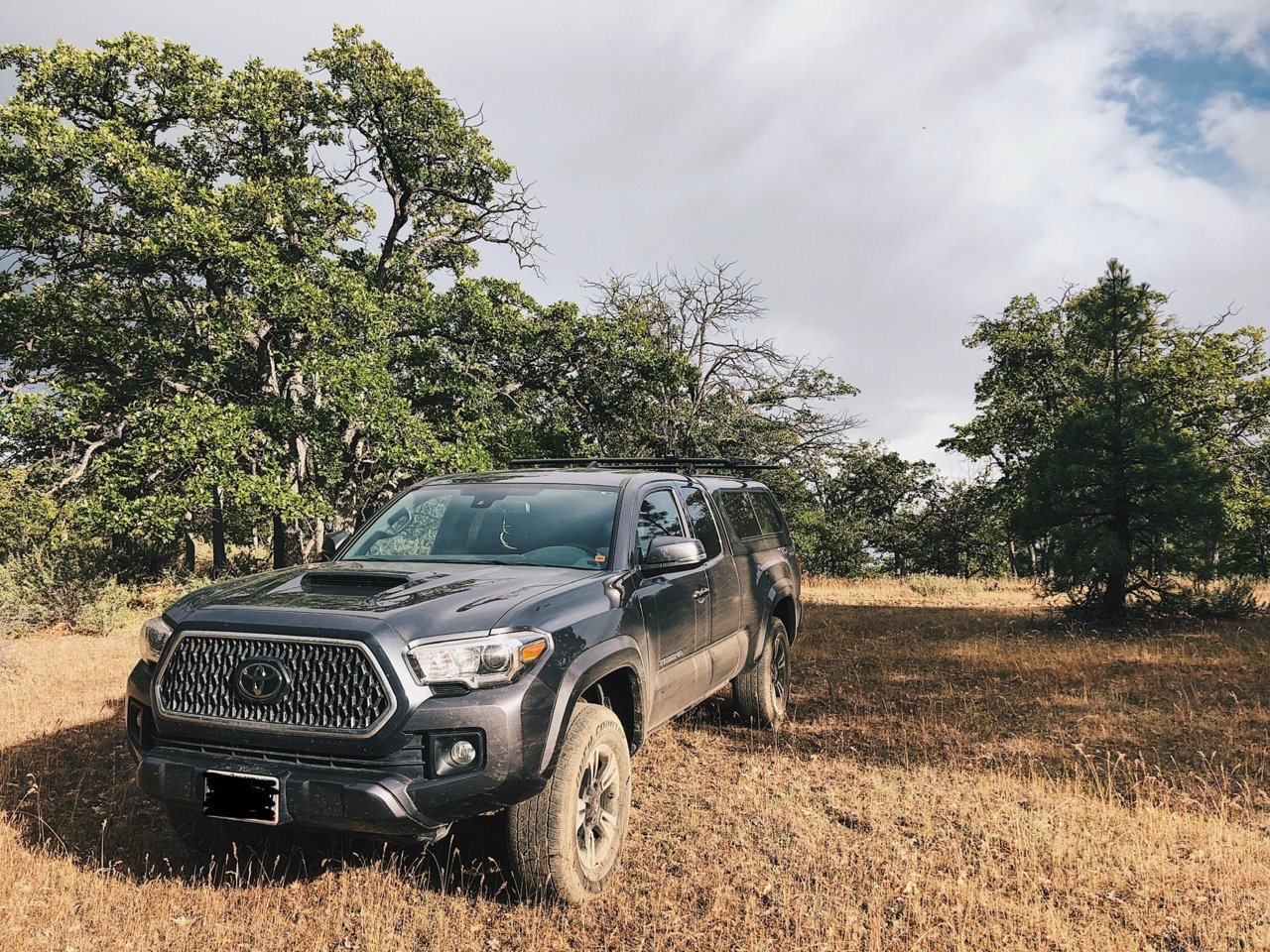

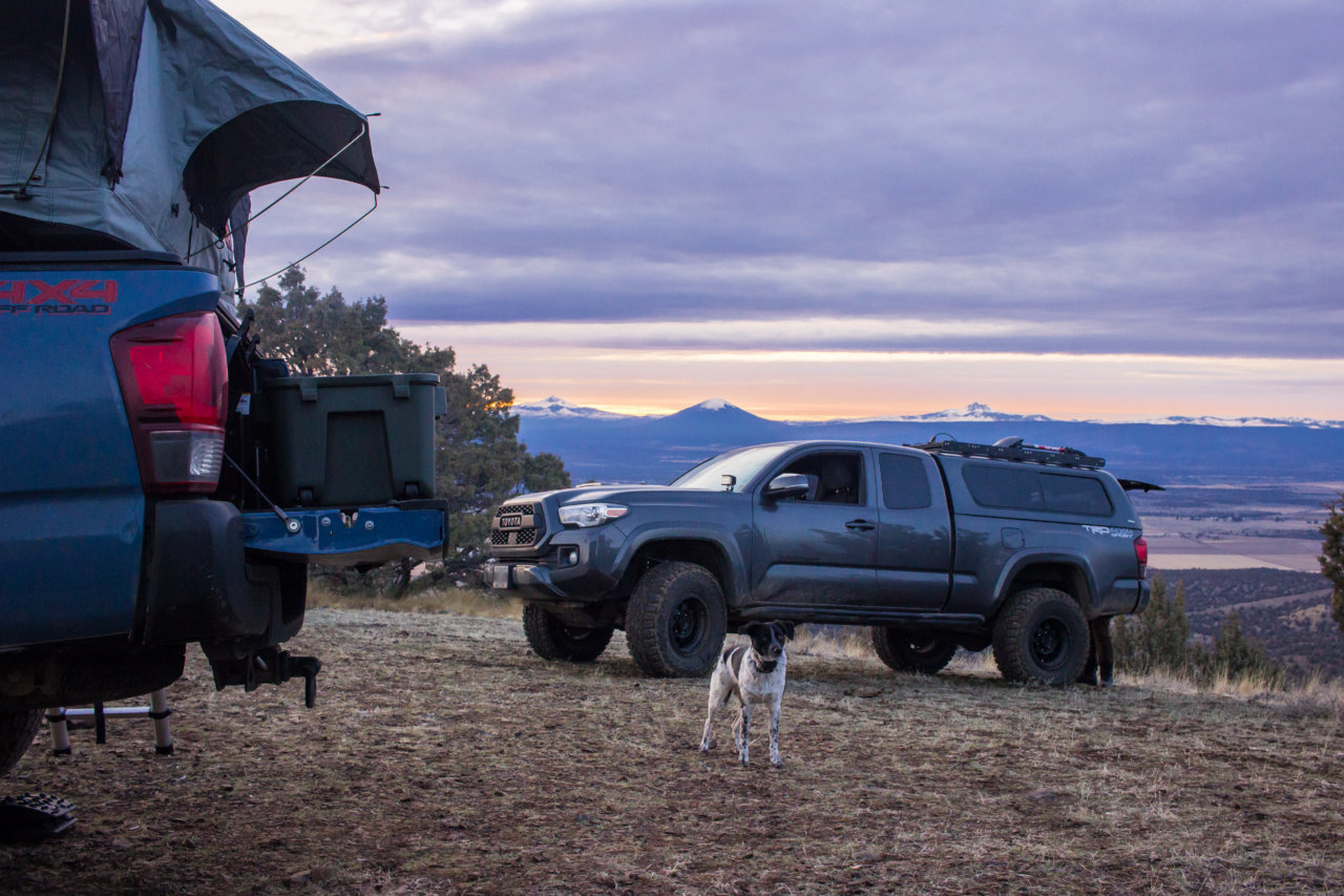

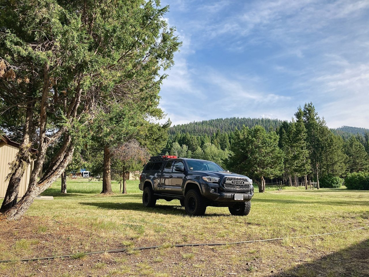

    My build is an attempt to follow a function-over-form, bang-for-your-buck approach, which was slowly broken down by browsing too many sweet TW builds.

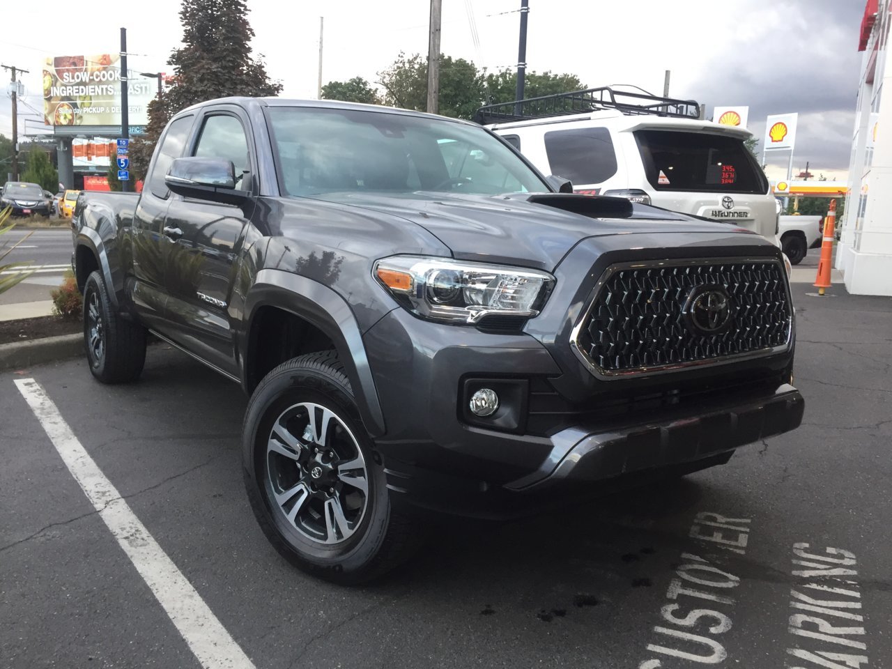

    2018 MGM TRD Sport Access Cab 6MT

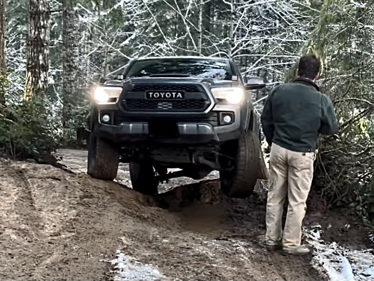

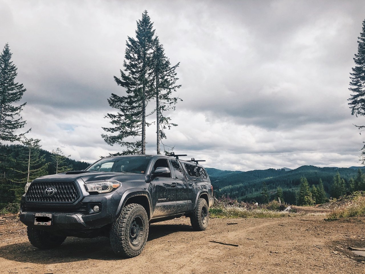

    Today:
    Day I got her:
    The elephant in the room: TRD Sports are trash, you suck…Manual and ACLB were non-negotiable. Plus I do suck:
    USAGE
    80% Fly fishing
    Bowhunting
    Camping/Extended Trips
    20% OHV Wheeling
    100% Daily Driver.
    I wanted a long bed to camp in (I'm over drying out tents) and swore I’d never wheel my +$30k truck hard enough to need a locker. I held out for a year just doing forest roads, but once you get a taste of wheeling…with the family/friends hookup I got, I figured the money saved from that + poverty cab + manual could go towards a locker later if I ever felt I earned it.

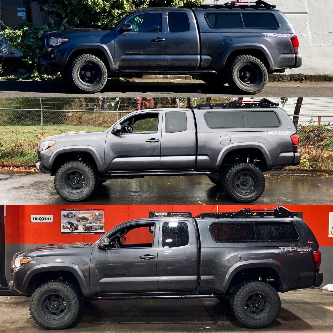

    SUSPENSION
    Bilstein 6112 w/650lbs coils
    - Bilstein is just solid value and I liked the 2.65” body, plus I needed to fit 33’s. Chose 650lbs coils because of upcoming bumper/winch plans and 0.5” more lift (let’s be real). Figured nothing could be harsher than taking Sport suspension offroad - turns out it’s true.
    I went 4/5 setting (access cab) and netted 2” of lift after settling.
    Bilstein 5160 w/Fox Roost Shields - I like the shiny remote reservoir, glad I have them for long trips loaded down and blasting through washboards without worry. Overkill? Probably. Still need to install my Fox roost shields.
    Ironman Constant Load Leaf Springs - Overestimated my weight and underestimated these springs. I got 7” of lift from these (rated 440lbs-GVWR, I was only 50-100lbs under 440lbs in the rear) and had to pull 2 leaves from each side, still netting 4.5” of lift (1.5” over my target). Might pull an overload later:
    (previous 265/75/16’s pictured)
    For learnings: Ironman 4x4 Foam Cell Pro

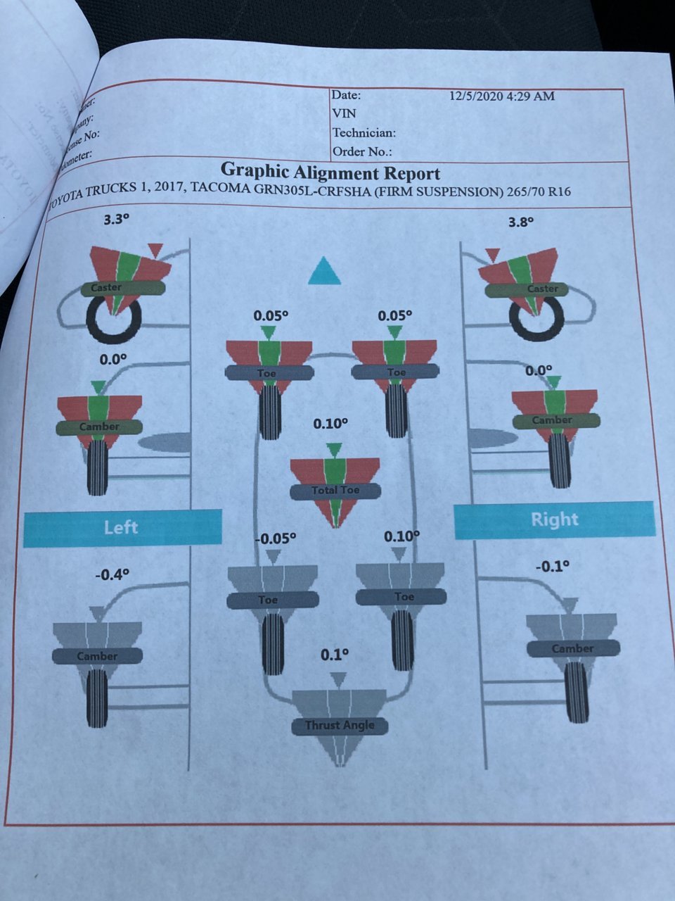

    SPC UCAs - Low maintenance ball joint UCAs for improved alignment and clearance for 285’s. Caster maxed out at 3.8 degrees with some cross-caster. Handles noticeably better with new caster.
    Thanks to @TacoTim85 I had them move my wheel forward with the LCA bolts first and adjust from there.
    OME CB Drop Kit - Solved my driveline vibes.

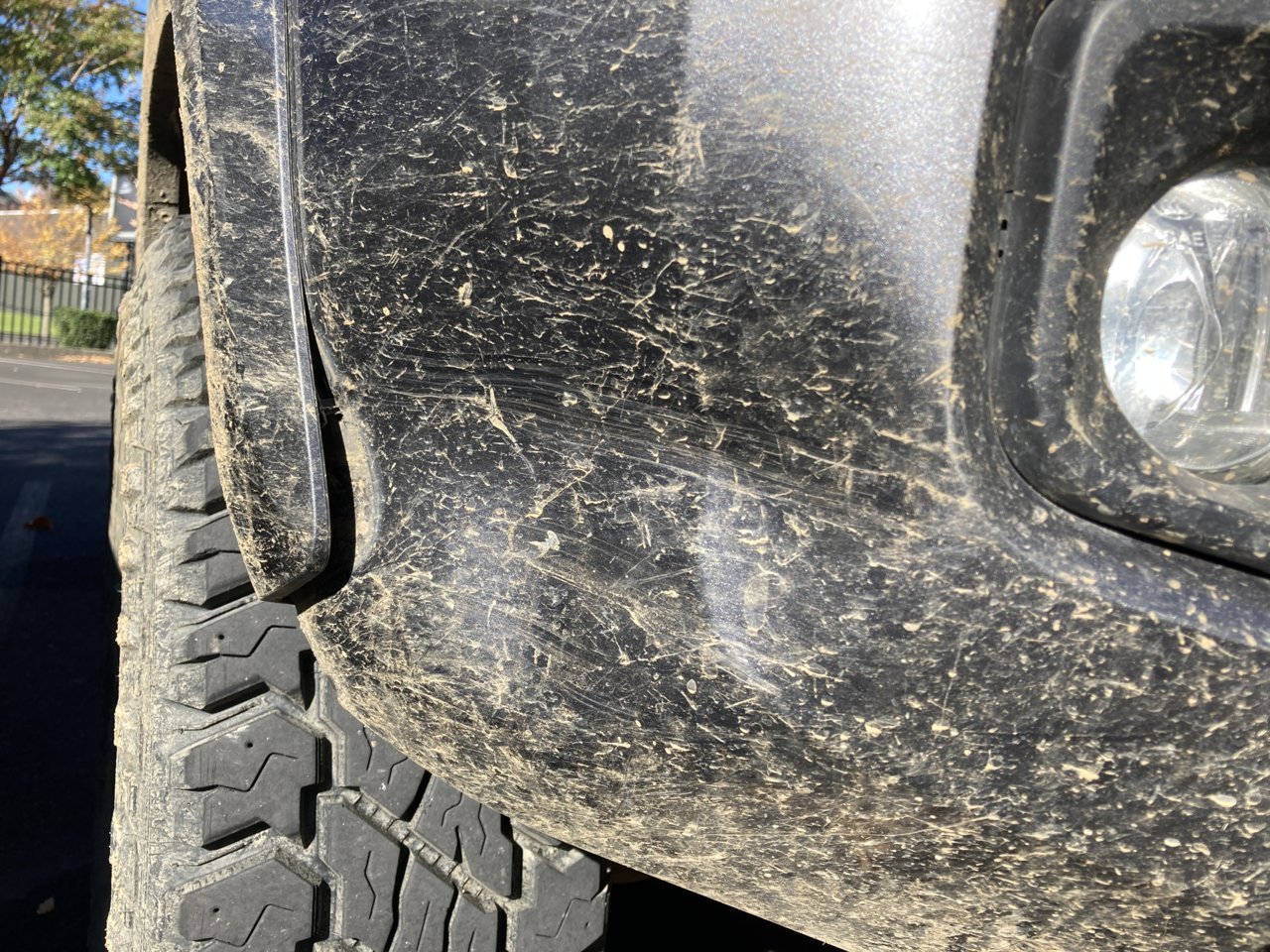

    Cooper ST Maxx 285/75/16

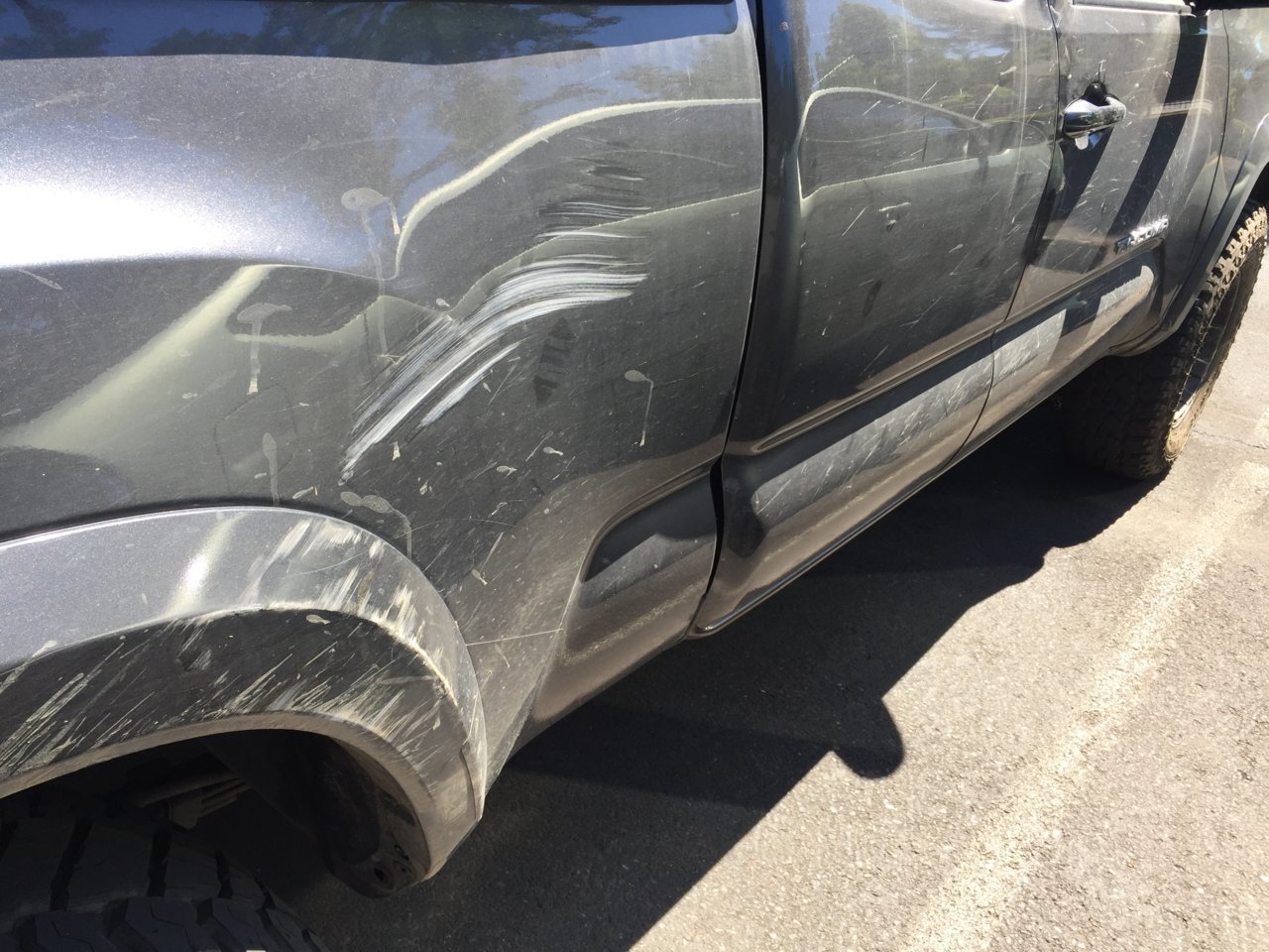

    - This video swayed me, plus all the positive reviews from TW. Rubbed like crazy with 285’s but a CMC, plastic trimming, and maxing out caster solved it.

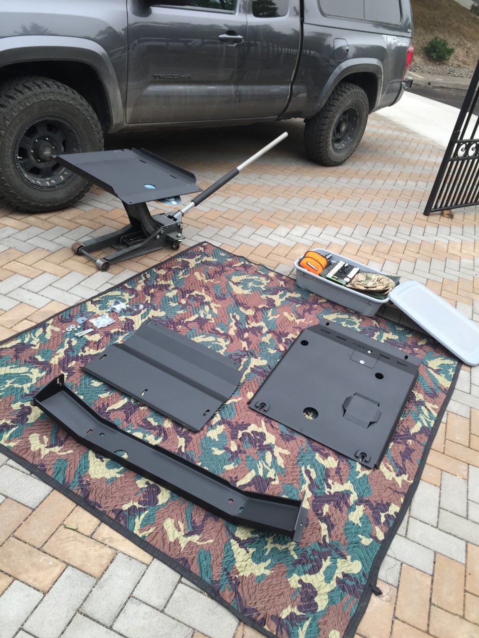

    CBI Sliders w/kickout
    - Shipped raw, painted myself, grip tape on top, and touched up with brush paint (highly recommend). This should be your first investment - paid for themselves their first time out. Looking back, I should’ve just gotten them powder coated.
    RCI Steel Skids x3 - Best bang for buck with powder coating factored in.

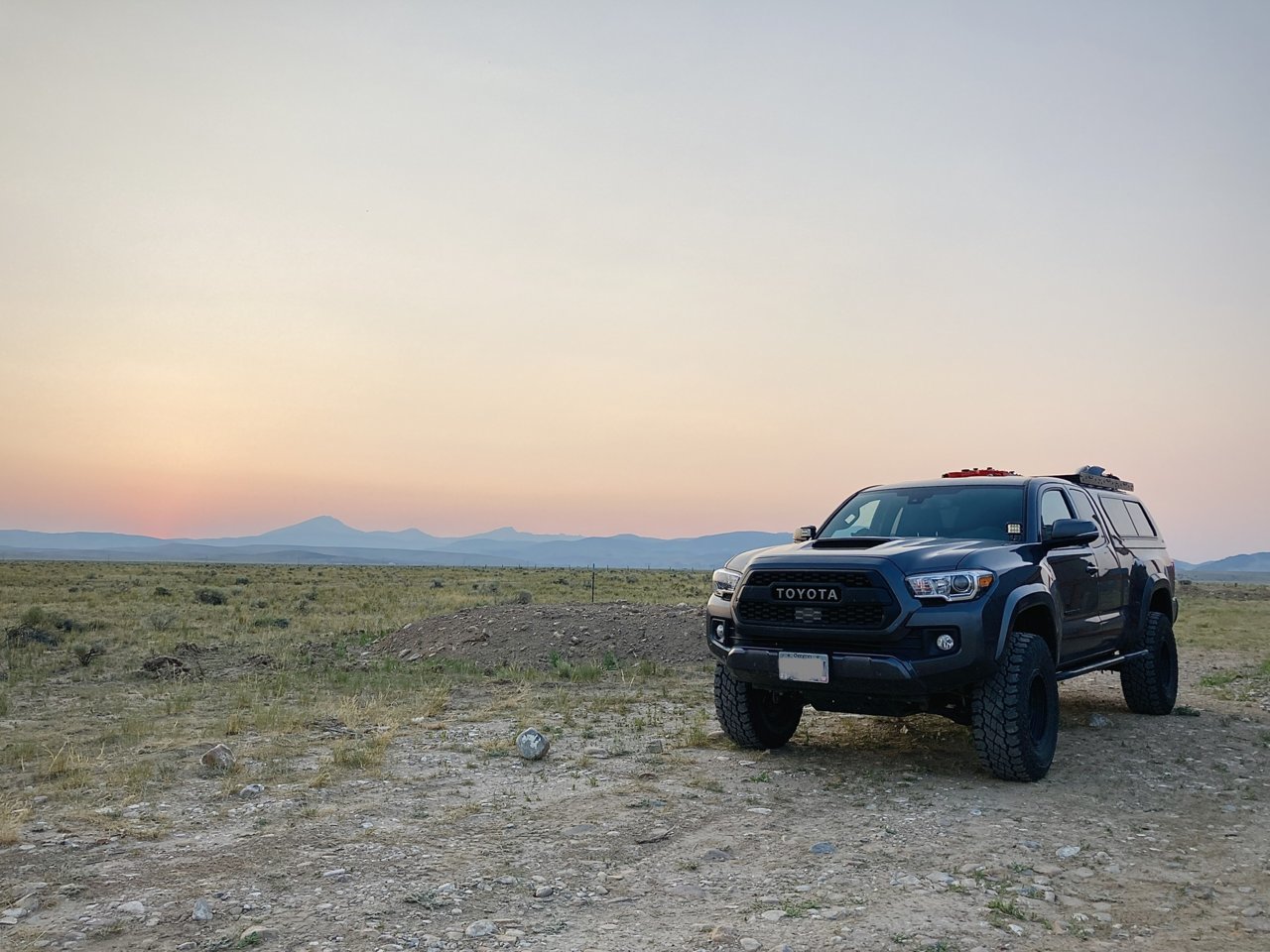

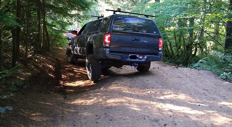

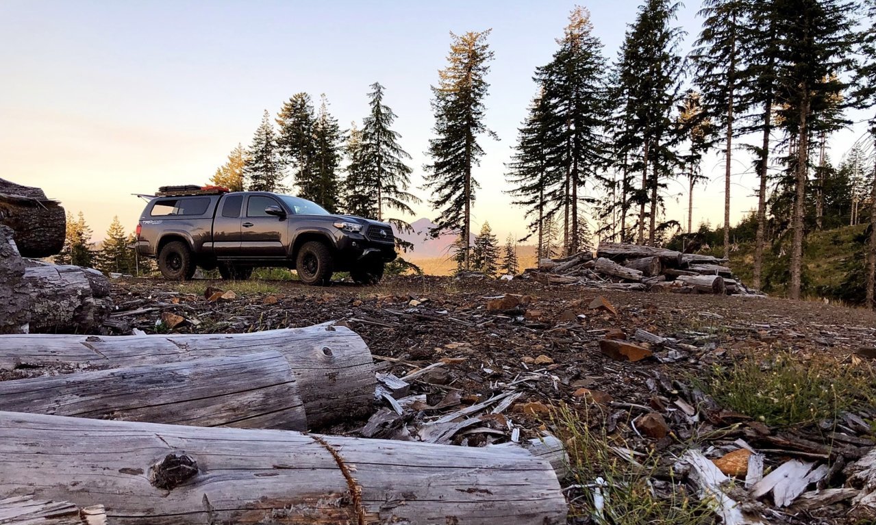

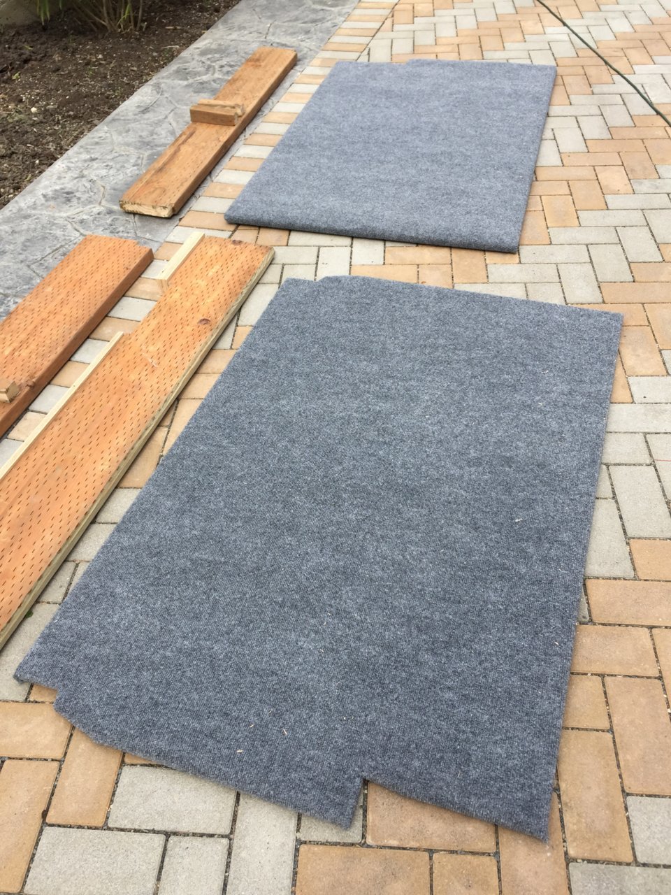

    SnugTop Rebel - Carpet headliner for condensation, sliding side windows w/pet and bug screens, fold down front window for cleaning, USB ports, frameless rear window for less leakage.
    Old man vibes but super functional if you’re outdoors a lot. Secure, waterproof, dust-proof, and windproof. Unlike RTT’s and ground tents, you don’t have to dry it out afterwards to avoid mold (it’s wet in Oregon) and wind is no longer a factor. Zero deploy/tear down time - having a rolling camp is a game changer for fishing/hunting. You can also stealth camp easily on long road trips.
    Make sure you have the bed sealed well during installation, especially the front.

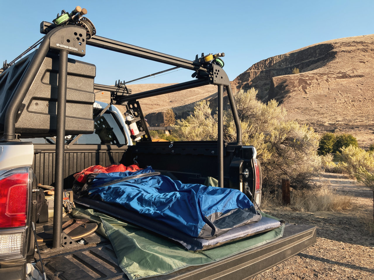

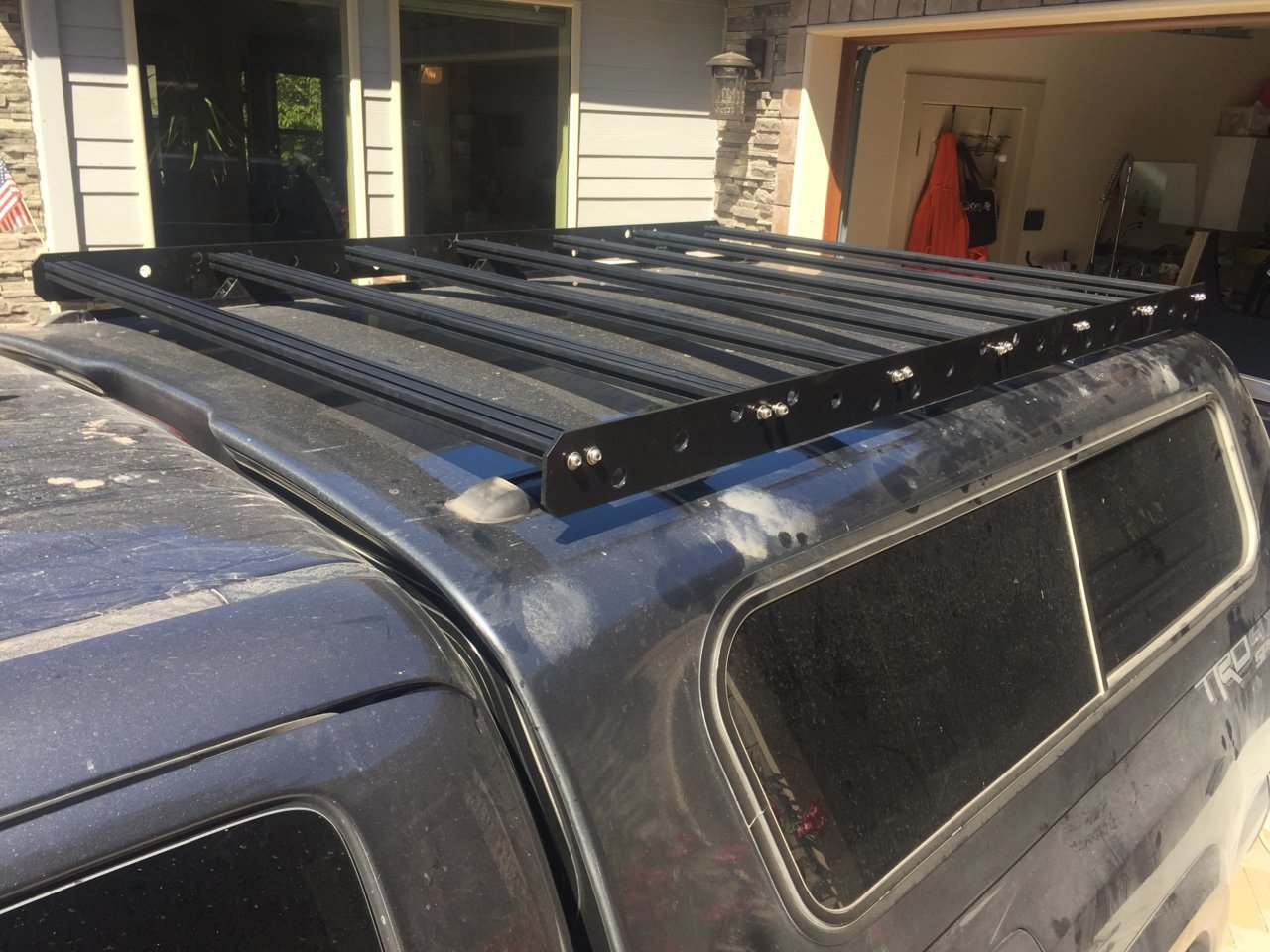

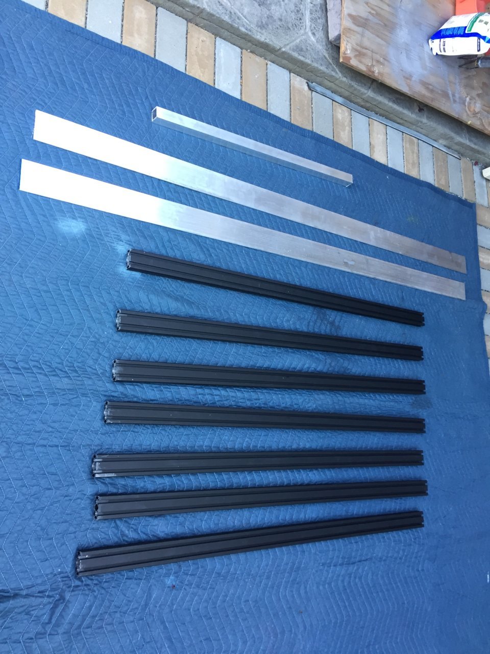

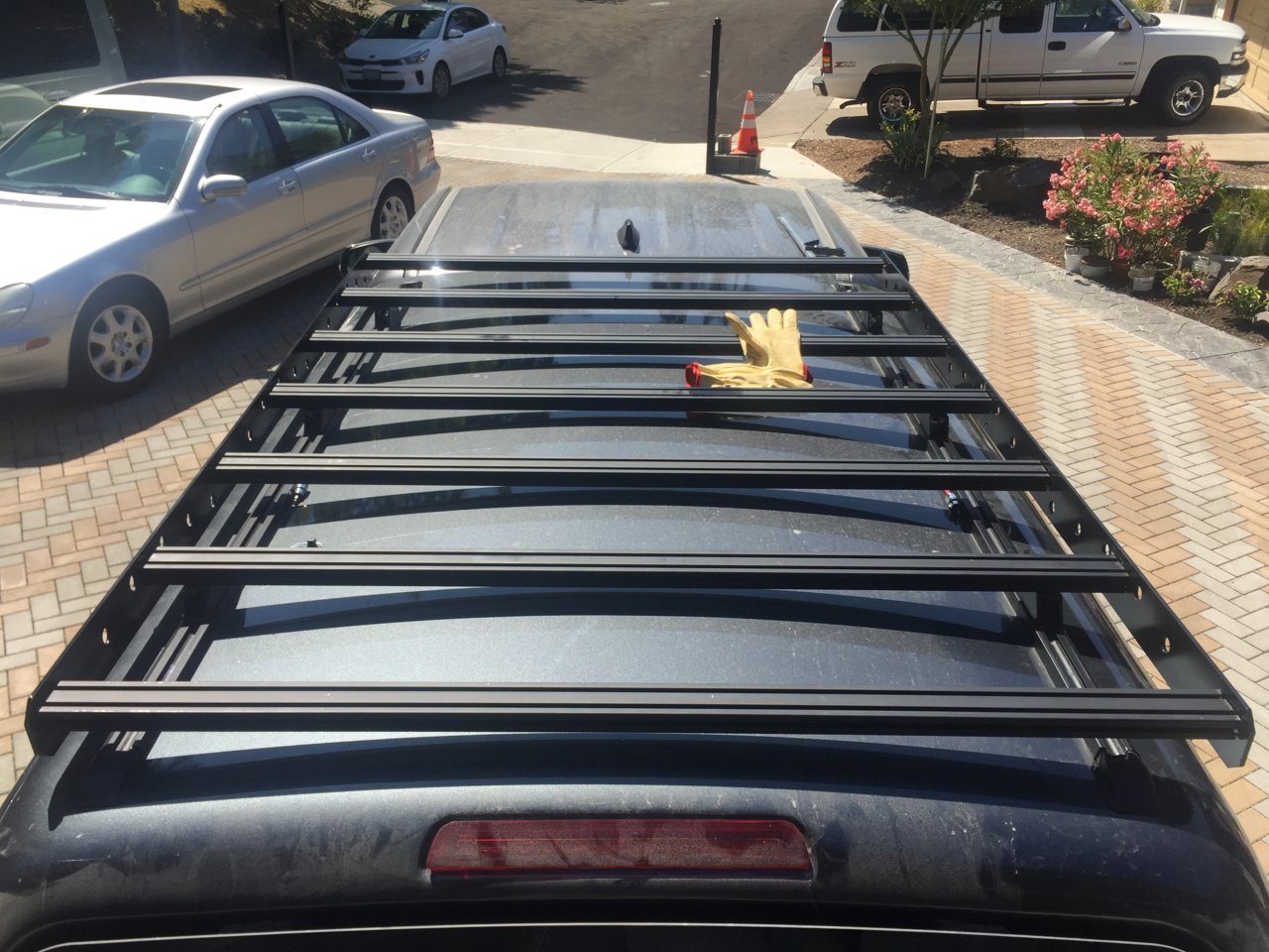

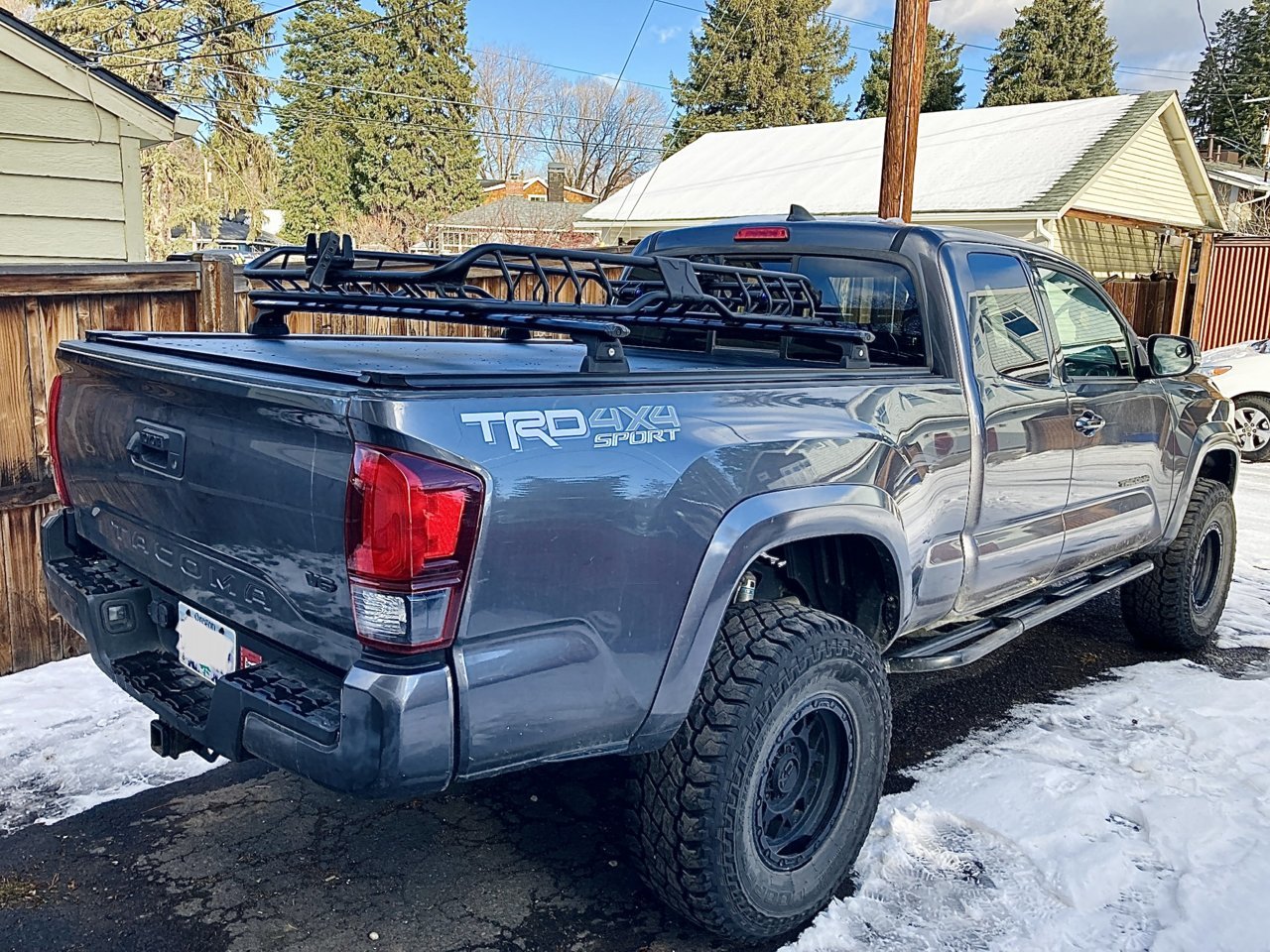

    DIY Prinsu Rack (rotopax mount, DIY traction board mount, Rhino Rack MPHU) - $236 total for rack materials thanks to this thread by @paranoid56. Started with Rhino Rack crossbars but needed more mounting points at varying lengths and something more low profile.

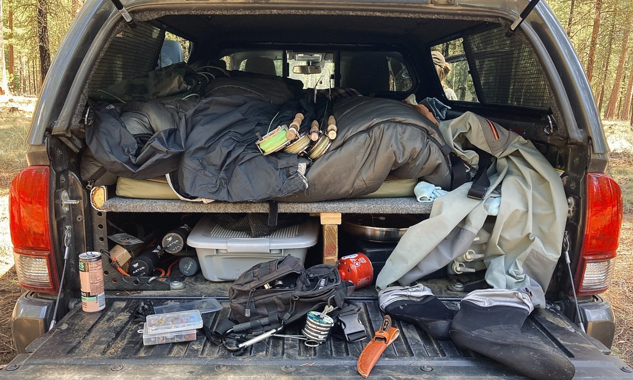

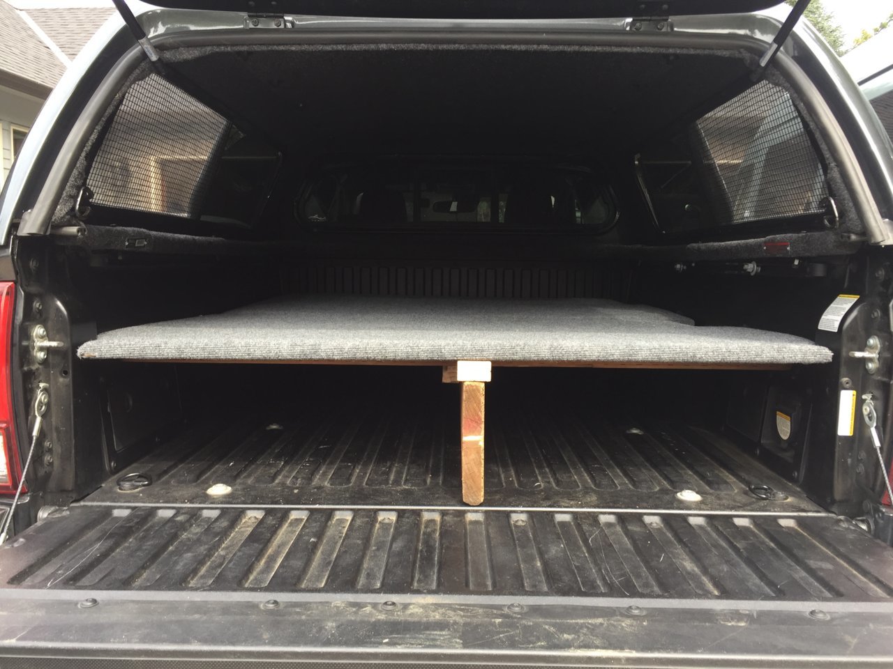

    DIY Sleeping/Storage Platform - Thanks to this thread. I went with horizontally cut panels to stack them if I needed to haul something cab-high without completely removing the platform. Hidden storage underneath is my favorite part.

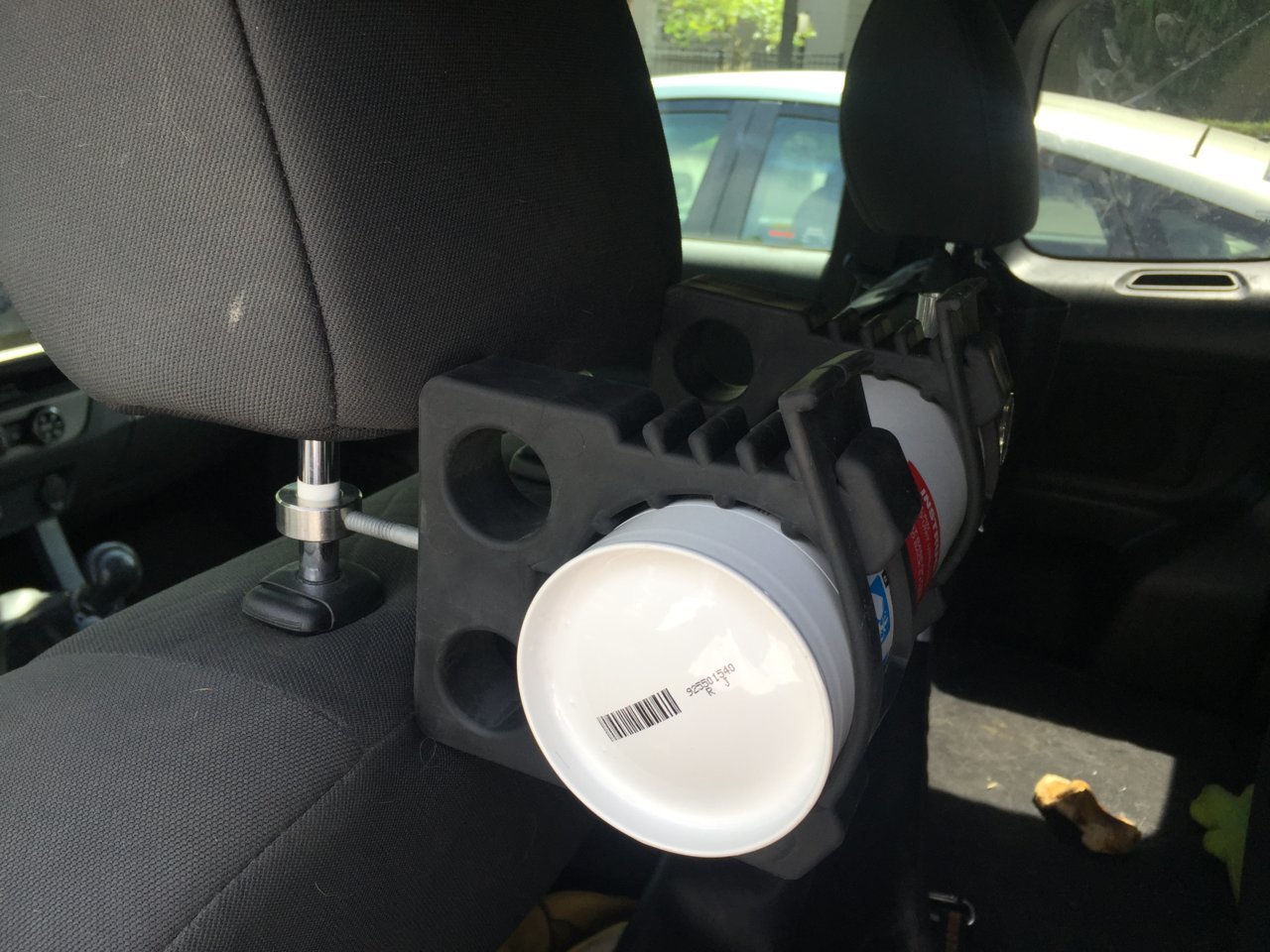

    Fire Extinguisher Mount - thanks to this thread by @StillNoPickles

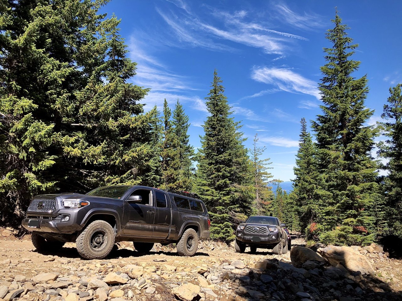

    Photo dump from some of this year’s adventures

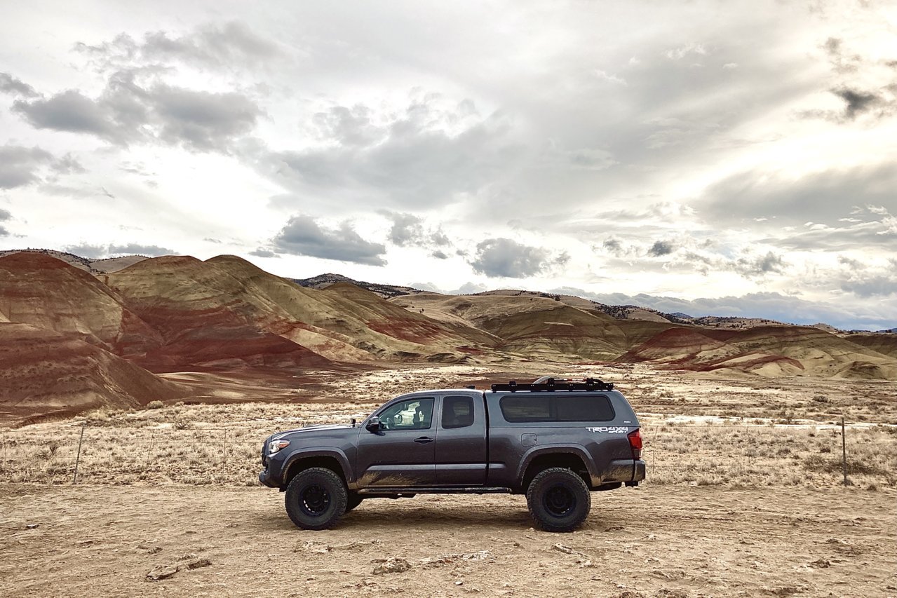

    Painted Hills area:
    942A2729-8E88-4826-BA5C-0135A7519D39.jpg 780C0EC1-3685-4103-B2A9-571B115A46B9.jpg

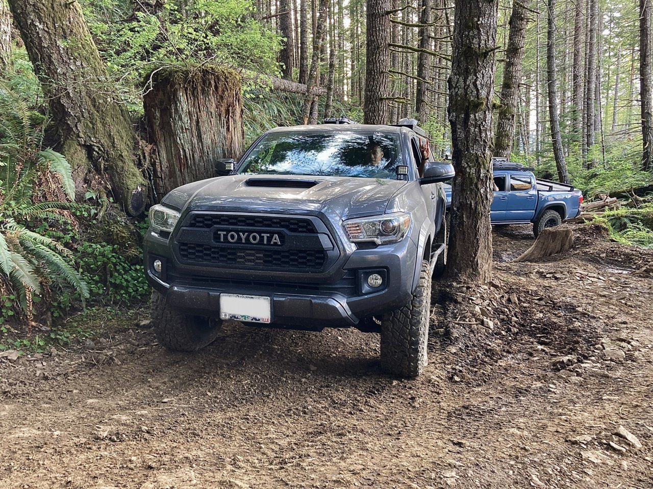

    Cedar Tree trail with @TacoTim85 @Astr0Aar0n and others:
    AB440479-C115-45CB-8B94-06A29706DD0B.jpg 78FF250D-41BA-4F85-A798-25D68115A590.jpg

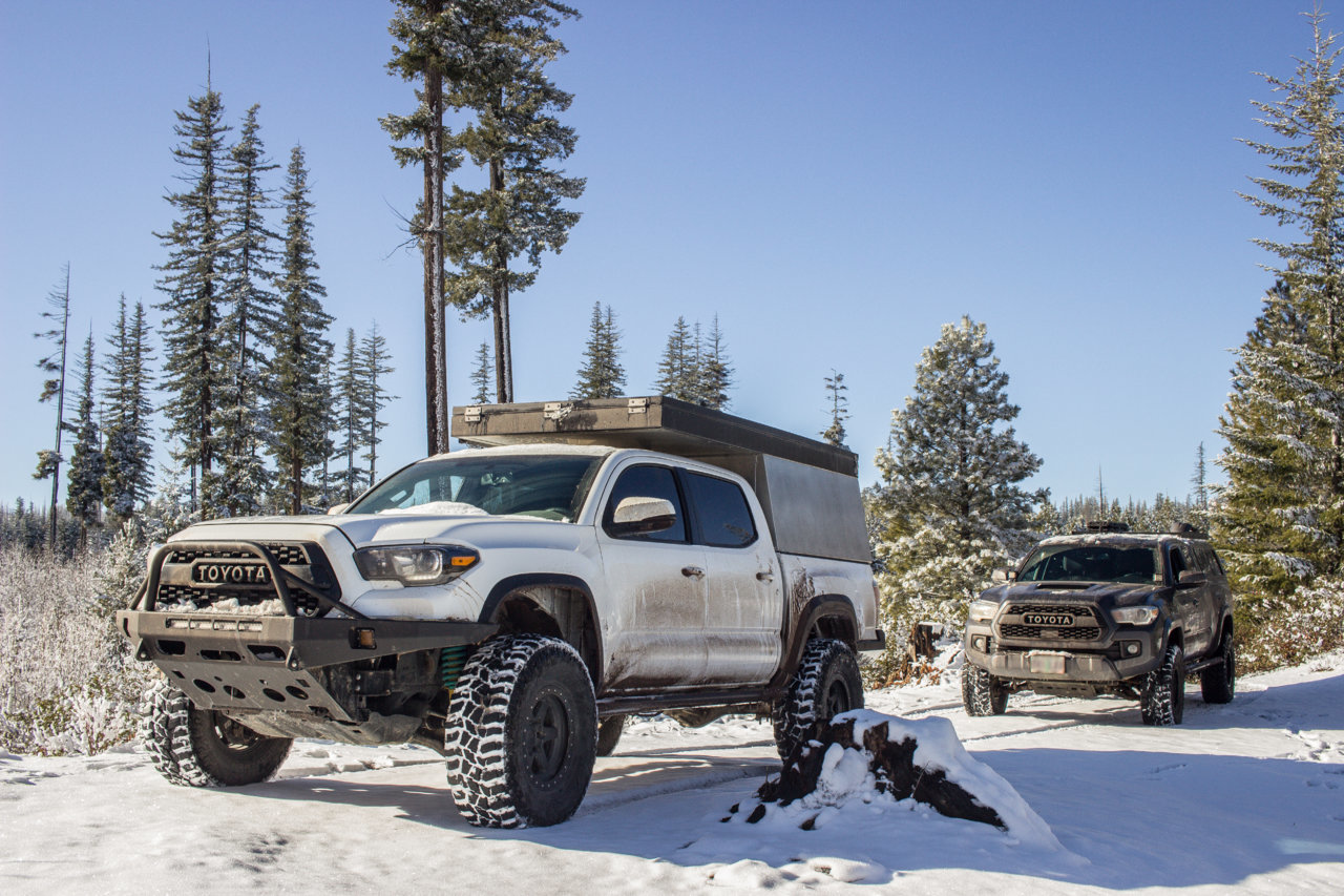

    Snow wheeling with some previous TW members:
    7A88ABA7-975B-451B-A944-426BD2B624B5.jpg 6D2045DE-B0D6-4FCE-B229-9CF229100D41.jpg 9FD31DD8-AEE5-47C1-9E6E-1153434E3793.jpg

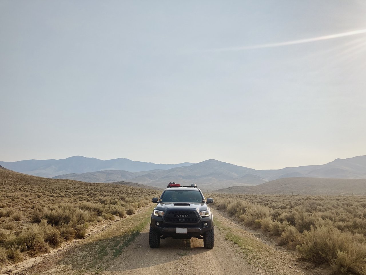

    Other random outings in Oregon, Montana, Idaho, etc:
    BB51719E-2D21-43F3-B208-BEEEDD35B7A3.jpg B77AC969-0E9D-4C8A-998D-071FD08D3362.jpg 741F097F-9B35-4E73-884C-C59F2FE8C29A.jpgDC9F6BE5-FB2A-41FD-9F8B-4270627C7A2D.jpg FE7CF0CB-E562-4C56-85C1-D1A3152087C0.jpg E6355182-E389-446C-9130-6CFE80CADF3A.jpg 1C021B2C-8BDE-4A24-A2AB-3CAD56EA463C.jpg

    After I sold the shell I ended up adding a prinsu cab rack for gear mounting. Also did a retrax retractable tonneau cover for lockable storage and it also had tracks on the cover that I could quickly add/remove crossbars and a basket as needed. It was nice having open bed access again but I did miss easy camping in the bed.
    I never wound up installing, I still have them in storage lol. My friend had them on his 5160’s and they fit. He’s the one I got the idea from.

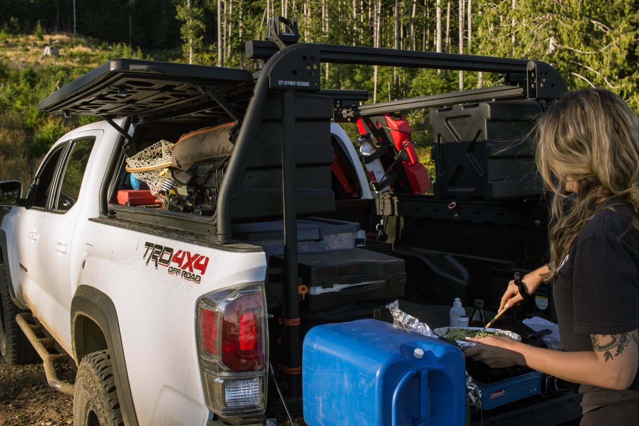

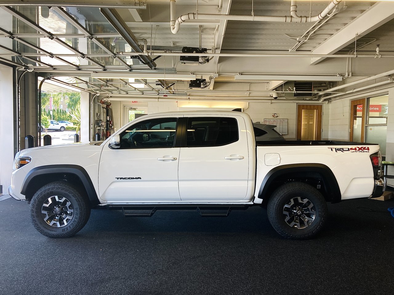

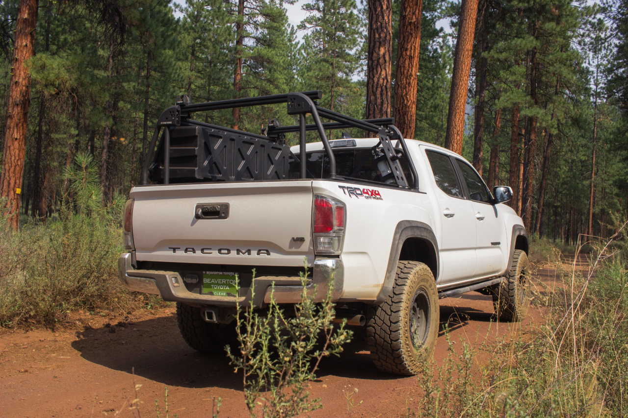

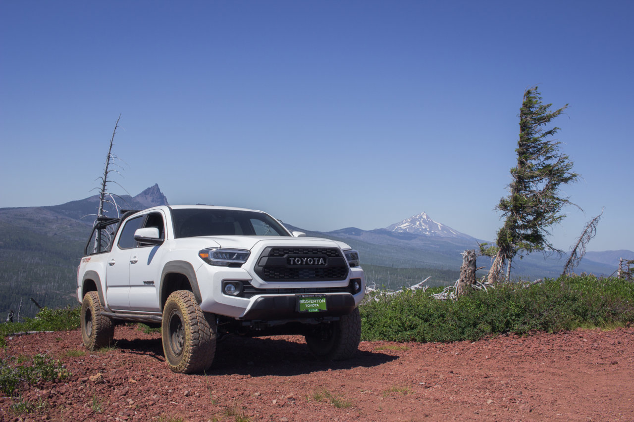

    And here’s my new truck for anyone interested.
    I was able to transfer my sliders, skids, wheels/tires, ditch lights, etc.

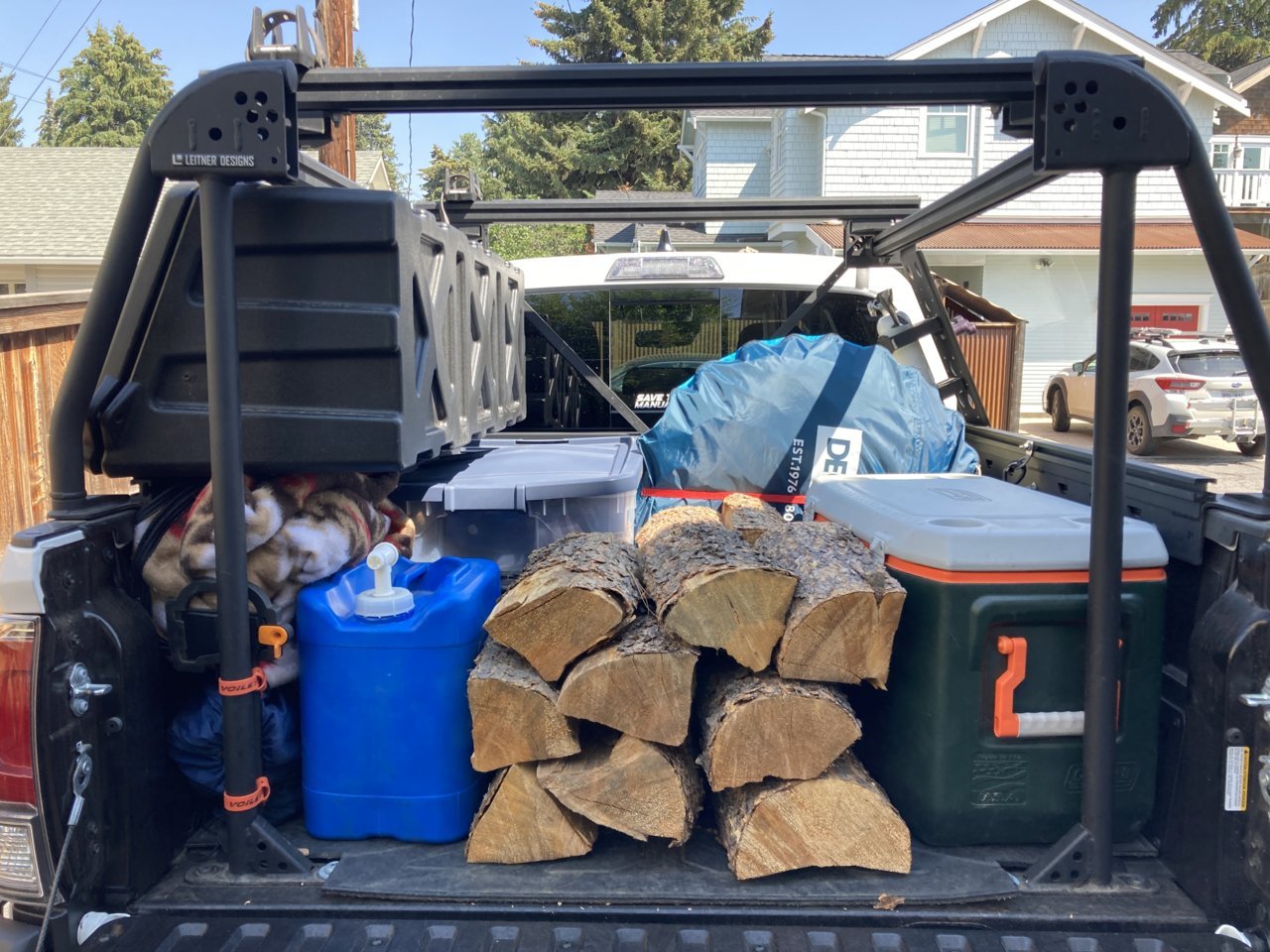

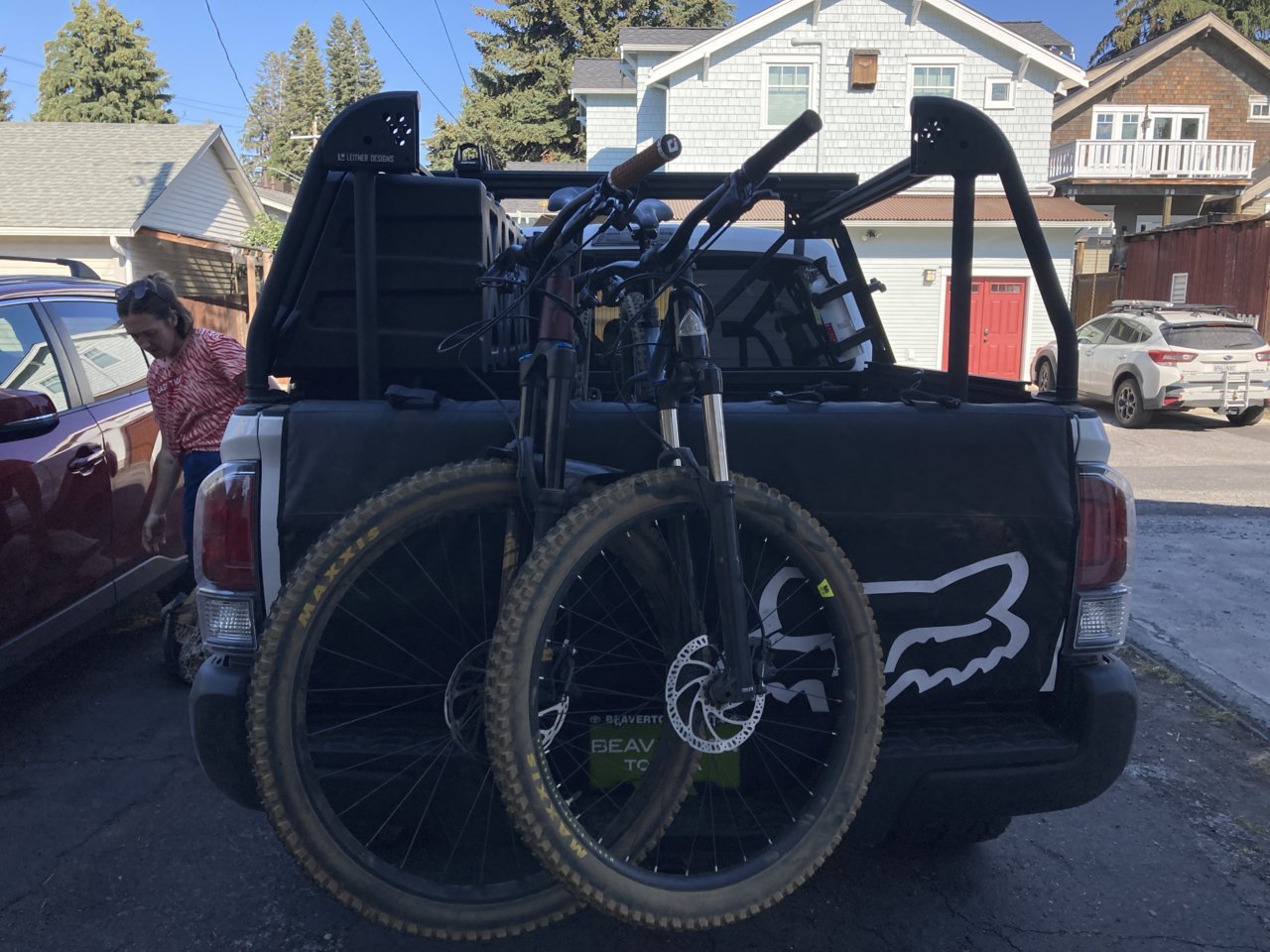

    Had a hard time getting used to the short bed at first. Ended up getting a used leitner rack and I really like it - lockable dry storage box but with full access to the bed and the rear load bar slides forward to haul taller items easily without removing the rack. Also threw up some fishing rod holders. It’s nice for taller loads with the shorter bed too.
    it’s also really modular and gives nice flexibility. I can remove the boxes and mounting plates or add more within minutes, depending on the trip we’re taking.
