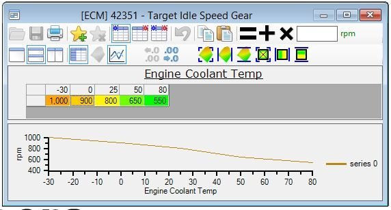

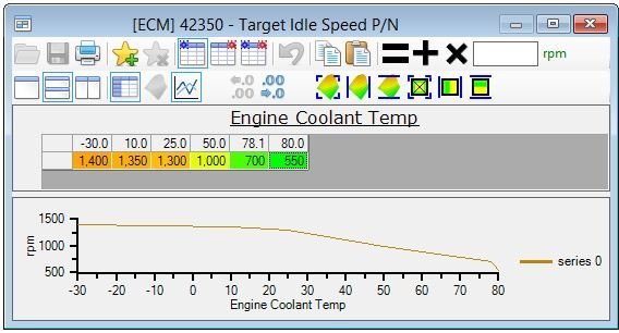

    Here is the stock desired idle/temp tables for the 4.0l that @JustDSM posted in the HPTuners thread, IDK how they compare to the 3.5l maybe he will chime in with them. I'd be curious how they compare.
    Park/Neutral
    In gear
    That's typically part of the anti-stall strategy, whenever the PCM gets a load input such as the transmission being put into gear or A/C compressor turning on it opens the throttle slightly in anticipation of said load, once the engine speed stabilizes it goes back to the desired idle lookup tables for current conditions.
    No-Hyperbole[QUOTED] and joba27n like this.
