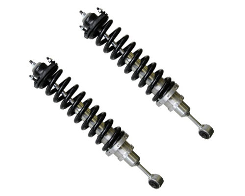

    I haven't found a thread dedicated to this specifically so I thought I would throw it up for discussion. There appear to be a few people running these but not a lot of discussion or detailed reviews. So anyone with personal experience or constructive opinions please chime in.
    They are a 0-3.5" lift coilover for 2005+ Tacomas for $499 assembled. I emailed FBG for info and this is what I found out. 600lb coils with a free length of 16.25" (413mm). Shocks are designed after a Bilstein 5100 in both valving and finish. For an additional $100 they can actually be ordered with 5100s. As per their web site they carry an 18 month warranty.
    Coil seems long, as a OME 2888 is 405mm(15.945") but it all really depends on where the spring perch is on the shock body. I'm thinking longer coil means less pre-load needed for lift. Suspension gurus correct me if I'm wrong.

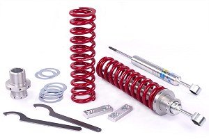

    The way I see it the closest competitor is the "Toytec Adjustable Coilover Kit" that comes unassembled for $619. Not much more if you plan to go with 5100s on the FBG coilovers, unless you consider the cost of assembly would be anywhere from $0 DIY reuse stock tophats or $100+ if you want someone else to assemble them with new top hats. Maybe a little less reusing the factory gear.
    These are what I'm talking about.

    Here is the TT Kit.

    This is what I’m thinking. That’s why the coil length has me confused. With a 16.25” coil I don’t see how they would manage 0” of lift. On a regular 5100 at the lowest clip that should still get around 3” of lift.

    I do not think that it is 0" of lift, I think that is referring to setting the spring seat at 0, or the lowest setting. Same as with the 5100's and the OME springs. Set the spring seat (clip at lowest setting and get the springs for the amount of lift that you are looking for.

    Nope. They specifically told me it is adjustable from stock height to 3.5” of lift.
