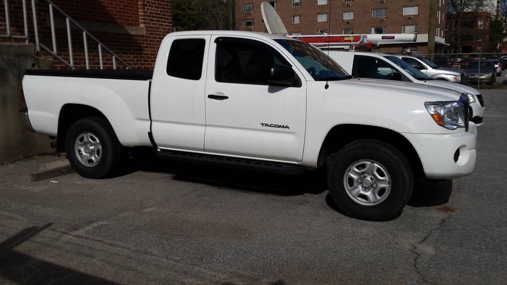

    As she sits now, sorry for the cell phone picture. I measured it next to my co-workers 2013 Pre Runner and his truck is about one inch taller than mine. I can make that up with my next set of tires. I'm very pleased.

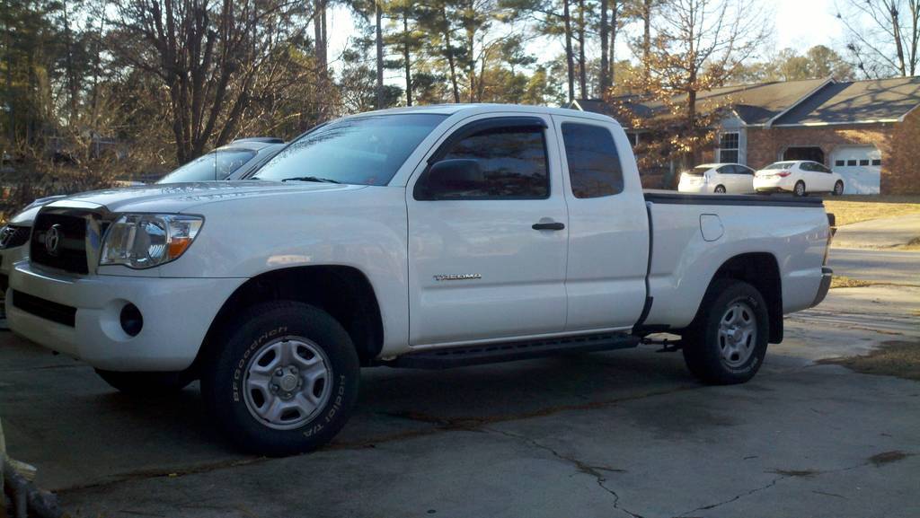

    2011 Tacoma SR5

    Wait did you get bigger tires? How big were the BFG Radials? They seem smaller than the Wranglers you have on your most recent pic
  19. Mar 4, 2015 at 5:34 AM
    #39
    ivel
    ivel [OP] Well-Known Member
    Jul 21, 2012
    #83078
    147
    Columbia, SC
    2011 Tacoma SR5
    Yep, they were 235/70/15. Looks much better.
    Odd fact though, according to my GPS, with the factory size tire my speedometer was 3-4 mph fast. With the 235/70/15s it was spot on ???
    These 235/5/15s read 4 mph slow
