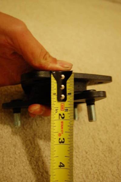

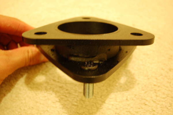

    Here are some pics of a front spacer that I did not install yet:

    Well guys, can somebody that has installed a Fat Bob's lift tell me what they did when it came time to reinstall the strut with the spacer attached.
    I followed the instruction and the brake hose retaining bracket on the strut is causing issues. I don't see how any spacer would fix this problem since no matter what space I put on, the bracket is still facing the wrong way.

    Well the problem is the spacer itself does not have a part # stamped on it. Actually nothing has a part # on it.
    The only thing I can do is to measure the dimensions of the spacer...
