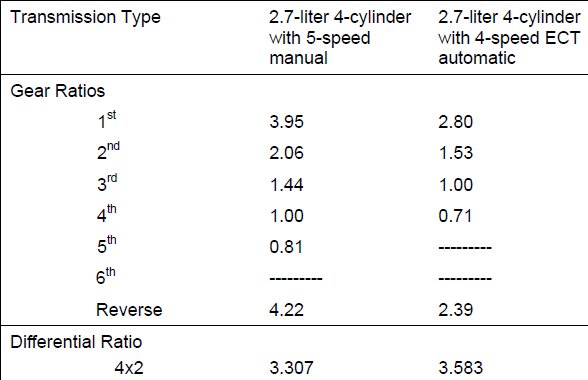

    I think this chart will help you there. It's a snip from the specs for the '13, but I suspect yours is the same.
    Just doing simple math shows the difference of trans gearing / diff gearing makes things pretty different.
    You can also test your trans to the auto diff. IF that gives you adequate 'regear', then you're up for a more cost effective axle swap.

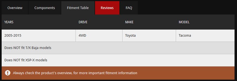

    These SPC UCA's appear to be 6-lug only. Non-compatible with the 5-lugs.
    http://performancelifts.com/spc-toyota-tacoma-upper-control-arm-25470.html

    Under fitment table it says only 4wd (6 lug). 5 lugs get no loving we only have spacers (Fatbobs / Readlift/ Ebay) and Total chaos UCA's (Costly and getting harder to find)
