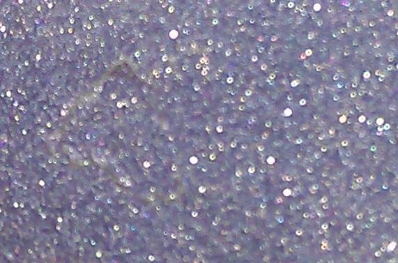

    I live in Hawaii on Oahu and own a 2009 Tacoma Extended cab in metallic gray since March of 09. It has about 15,000 miles on it. A couplemonths ago, while waxing the truck, I noticed 6 small rust spots, all on the roof of the truck. I am not sure if they are caused by rocks chipping all the way to the metal of the roof, or a faulty paint job. The reason I think it might be a faulty paint job and not damage from rocks is
    1) All the spots are spread out from each other onthe roof, and there are no other rust spots anywhere on the body.
    2) Two of the spots are showing webbing marks underthe paint.
    3) They all appeared about the same time.
    4) There is an indentation about 0.5mm deep on the roof that has a layer of paint over it (it looks as if a previous layer was not applied and painted over).
    It seems statistically improbable for rocks to only hit the roof of the truck with enough force to chip all the way through to the metal body. I do not recall ever hearing a bunch of rocks hitting my roof while driving, and the truck has never been parked along a street with rocks. I also previously owned an 03 extended cab Tacoma in black for 6 years that had no major problems with rust (sort of gave it away to my brother in March of 09 with about 35k miles on it when he joined the marines and got stationed in California). There was only two rock damage spots, both on the hood of the truck when it was shipped to California in 09. I recently examined my old truck again (my brother and his truck areback home in the islands), and despite being driven for an additional 50k miles, there is only one additional rust spot on the body, and again on the hood.
    When I took my truck in for a routine maintenance to Toyota, they claimed all the spots were caused by rocks. I had a friend who works in the auto body business and some other friends who are familiar with auto body work and carsa nd trucks in general look at the spots, and they all said some of the spots look like it was caused by faulty paint. They also said in general, rocks should not damage all the way to the metal unless they are large or hit your vehicle at a high velocity, so the rock chip damage spots could still be due to faulty paint job. They all agreed something is not right with that weird paint covered indentation.
    What do you guys think? Has anyone else with an 09 Tacoma experienced rust spots that might notbe due to rocks?

    the first pic is a rust boil. the webbing effect is it spreading. your three year warrenty jut ran out too. dang i think you would have had a claim on that. yes the paint prep prob wasnt done right. but you live in constant salt air. it may just be par for the course.

    ^^ this. Pretty hard to tell by the puctures but I agree on the first picture. Question is why caused the initial chip. Although unlikely, a single chip in the roof is possible. I know you said you had several so this might not be the case. But I don't have any rock chips in my hood yet but I heard one hit the roof last week! Hard to tell what the second picture is from my phone but its too bad you have all these chips. But the good news is, iirc, that there are good cut off lines if you decide just to get your roof fixed and paint it. Rather than blending a bunch of panels for color match

    Secondly your paint is fine.
    Finally you need to keep up with the chips much better then you have been doing. Inspect your truck monthly and fix the chips as they appear. Your one chip must be at least a year old. Being in a salt water environment you need to take much better care of the truck if you expect it to last.
