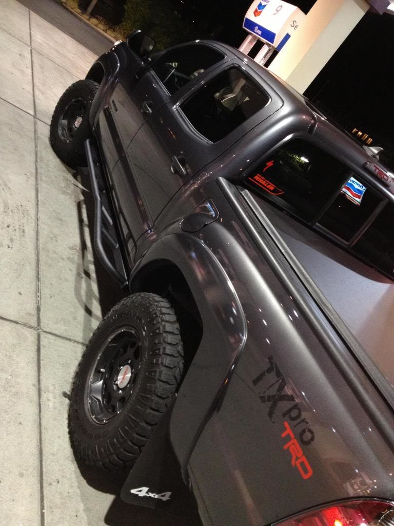

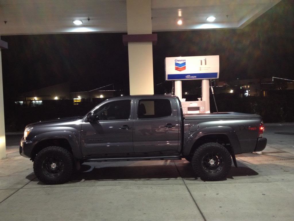

    So I removed the fake bead locks off my rims. The screw holes are bare metal obviously...do I need to worry about rust?

    why dont you spray it with some sort of sealant/protectant just incase?

    Put the bolts back in. If they're too long then acquire some shorter ones... :)

    this.. and paint them black if you want to color match

    Yeah, they are too long. Not sure where I will find such a short bolt...are they stainless?
    Any sealant recommendations that will be clean and not leave residue all over the rim?

    Oxidize yes, rust no. Cut your stock bolts down or get new ones, paint and reinsert.

    It's most likely an alloy wheel, aluminum that will not rust but could oxidize as a previous poster said. Don't just put any screw in there as that can lead to bad things. Using the wrong type of metal could cause bad interactions between the metals, for example aluminum doesn't like stainless steel and the two could have a chemical reaction -- galvanic corrosion. Best bet would be to find a plastic screw or plug you can use to cover the holes.

    Whats crazy is, how much better that looks without the fake bead lock

    LOL. The more I look at it the more I like it. Makes the rims look bigger too.

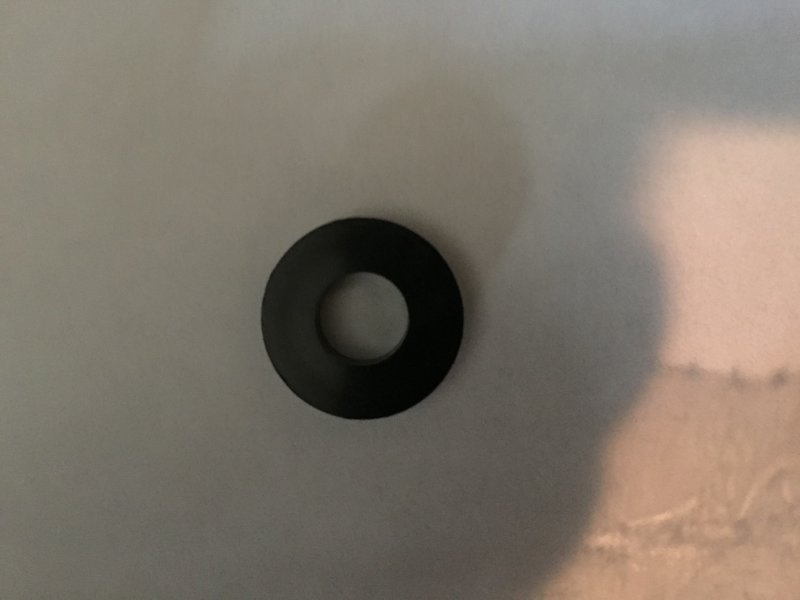

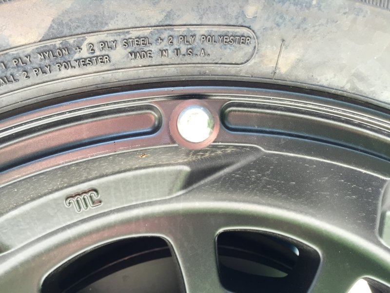

    Here's another option. 5mm black plastic spacers.
