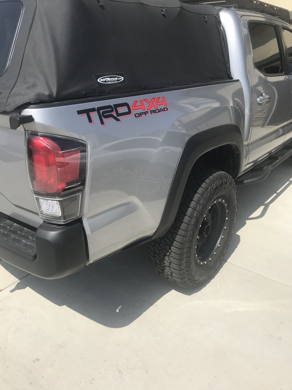

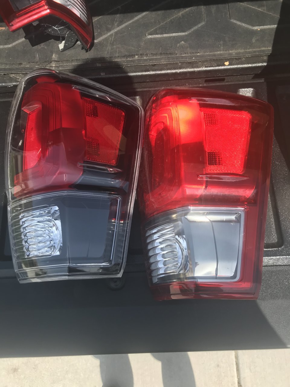

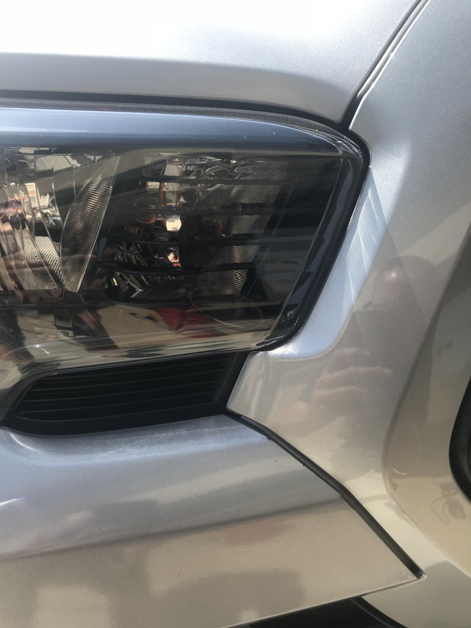

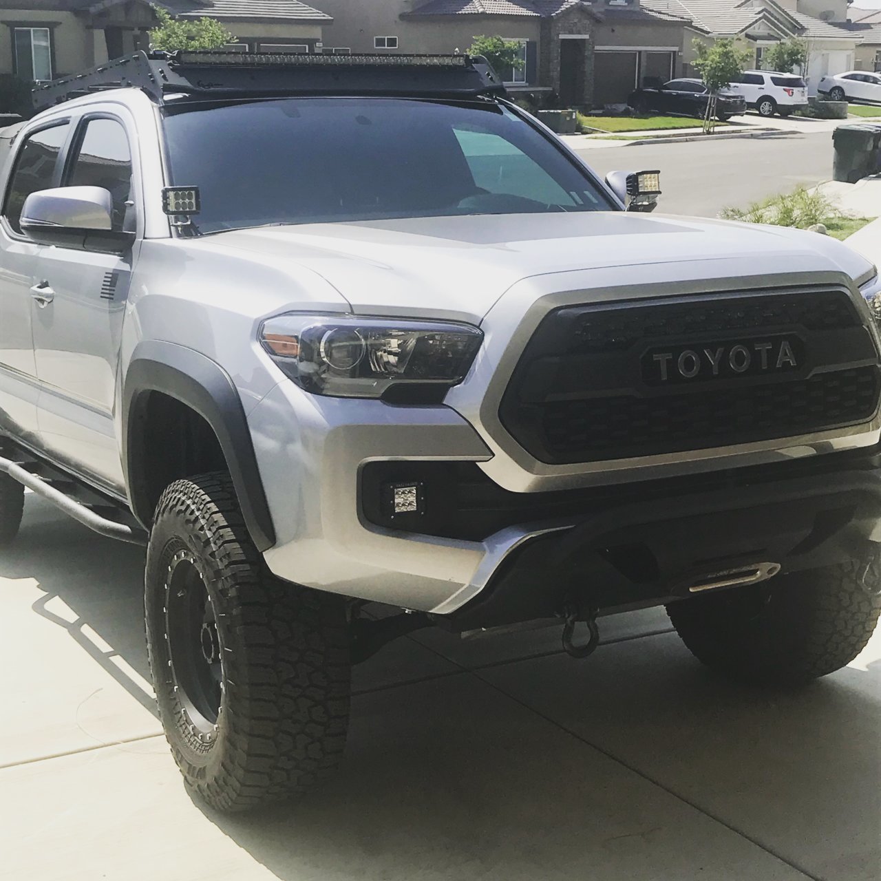

    Whats up TW. I just got in my set of faux pro headlights/tailights from www.uniquestyleracings.com on sale. Since ive come across a few recent threads of people asking about them I thought I’d post it up.
    I wanted the blacked out background after seeing it in person and found this as a great option.
    The headlights and tailamps I purchased are manufactered by depo and sold through the above website. From what I have read in articles and user feedback is Depo is a great aftermarket brand.

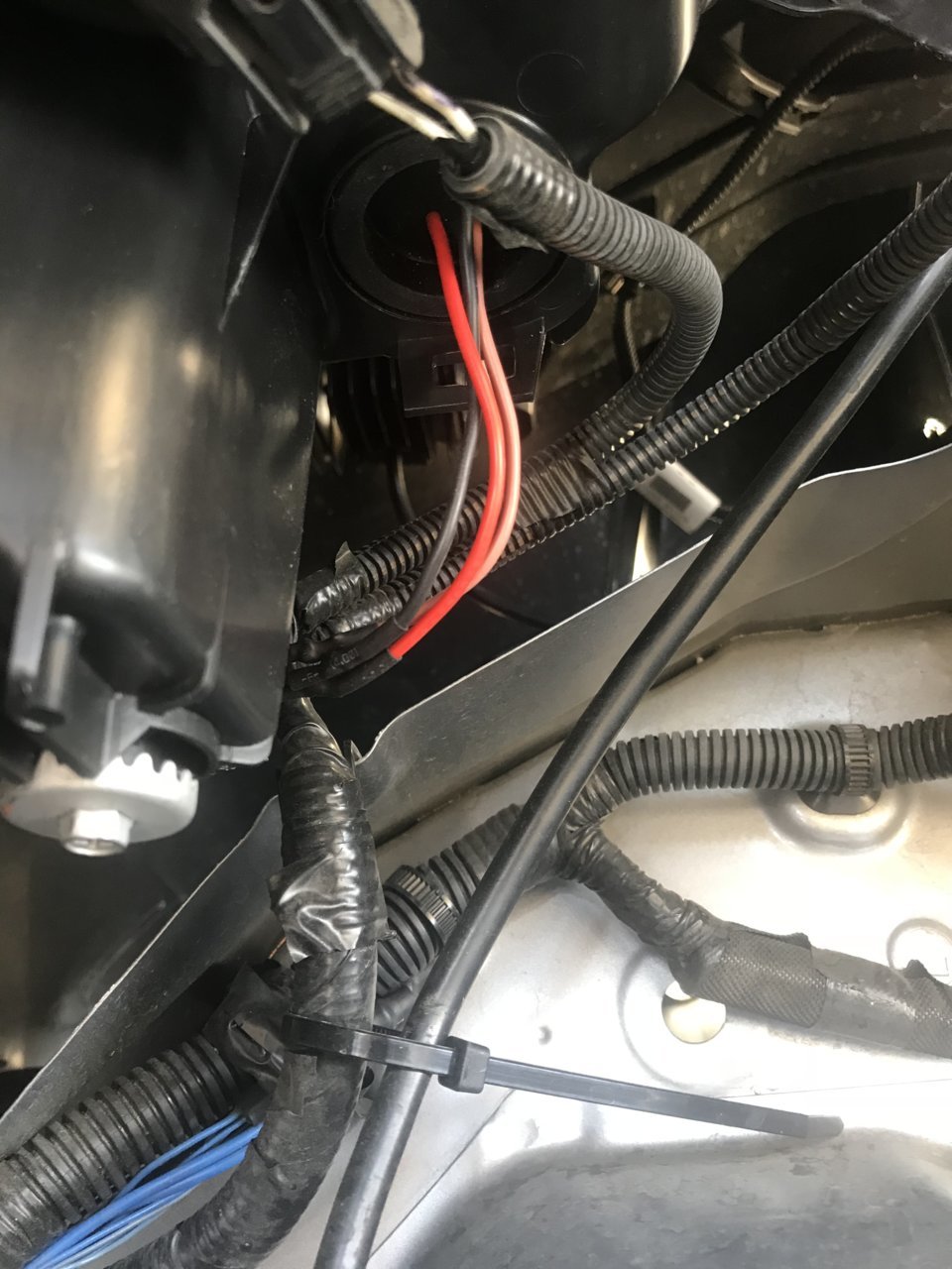

    So these headlights are marketed for SR5’s who want the LED strip. They come with a plug n play module so sr5 owners get those cool lights. I got it for my offroad for the black housing. The info says they are sr5 but they work for all Tacomas. All i had to do was take the three factory DRL wires and attach them to the three aftermarket drl wires. Took about 5 min per light to do. (Attached pic of wires).
    The tailamps are completely plug and play. Overall I’m very happy with them and its made a huge difference in my trucks look even with the small difference of the black housings.
    Not sure how long their sale is good for but I used offercode mtntaco and the set comes out to just over 500$ which I beleave is a fair deal considering oem pros from what Ive seen are 1k plus.
