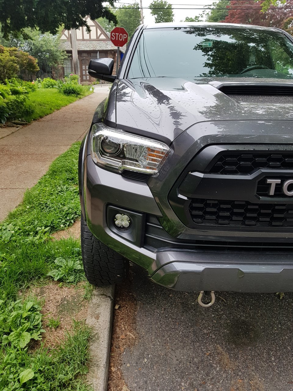

    done .... I did the solder thing - was easy I have a soldering station all set up and ready.
    Soldered, Shrink wrapped and taped old connector to new headlight.
    Only PITA was getting the fender flares off. Broke one tab. The vid says reach in and pinch the tab well 1st there's not a tab that needs to be pinched just push to 1 side. You have to be Japanese size to get arm in there. I'm not a big guy but there's no fucking way to reach those tabs. Just need to go easy when pulling the flares off. After that piece of cake.
    I installed a set of Hikari LED heads and high beams while there. The whole setup looks pretty nice. Getting low on chrome tho... all good.
    Before - OEM lamp
    After - Bro Pro Headlight
