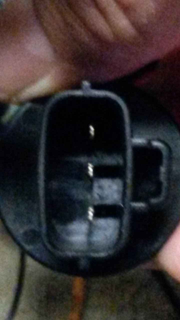

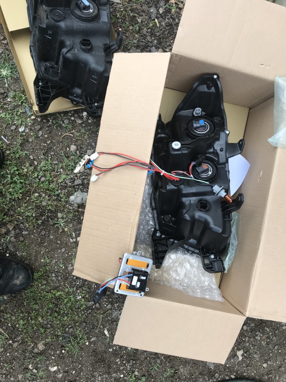

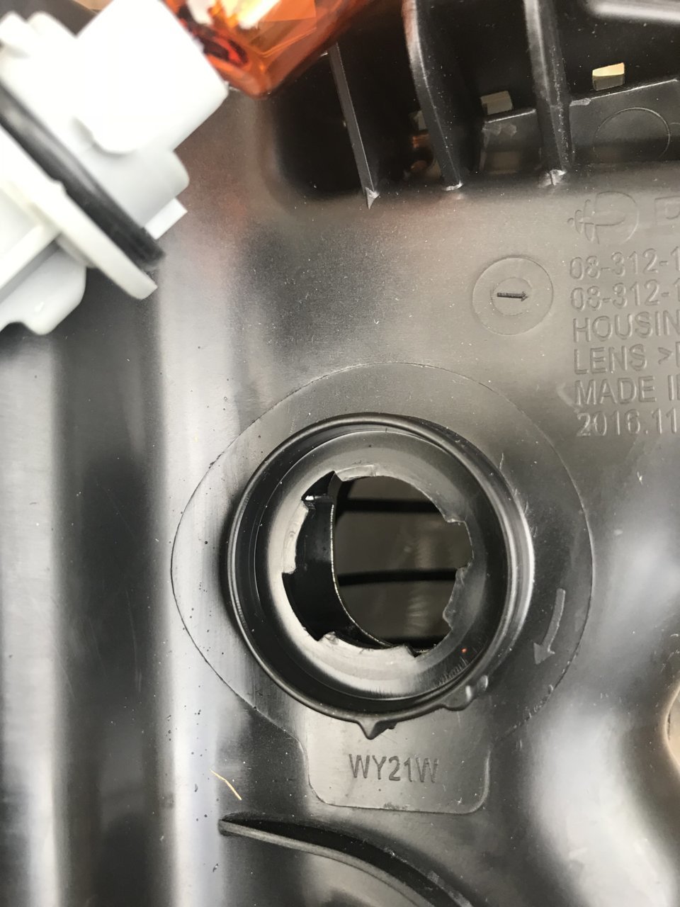

    Ok so what a day got my lights not sure if I got the right ones or not ? I have a sr5 these are supposed to be plug and play but the turn signal light is not correct . I’ve included two pics . Did they send me the ones for the TRD models ? AA21A1DC-9259-4491-991C-18B5F481AF0E.jpg

    The lights and wiring are the same for all vehicles. You do not use your old parking lights. You plug in the new amber light on the attached new harness into the socket on the new lights. The 3 pin plug that connects to your old existing amber light now connects directly to the new 3 pin connector on the new harness.

    42
    lights I got on the sr5 are two prong ? That’s why I’m trying to confirm this

    I thought the amber drl on SR5's had a 3 pin connector. The Sport has a 2 pin because the amber is not a drl on the Sports.

    I just put the headlight back together... I tried plugging it up and it only looked like 2

    @GLL40 said the new male plug would not fit in the existing female plug. If anyone had this issue, and resolved it, pm him to see if you can help.

    Where is everyone mounting the resistor ?? I got them in

    Did you guys figure out where to mount those resistor plates? I'm probably gonna use mine to do LED's in my Depo Pro taillights. Tail-As-Turn mod is a must have IMO!
    If u just want the resistors to wire in call these guys & tell them what you're looking for
    https://www.diodedynamics.com/resistor-kit-6ohm-50w.html
