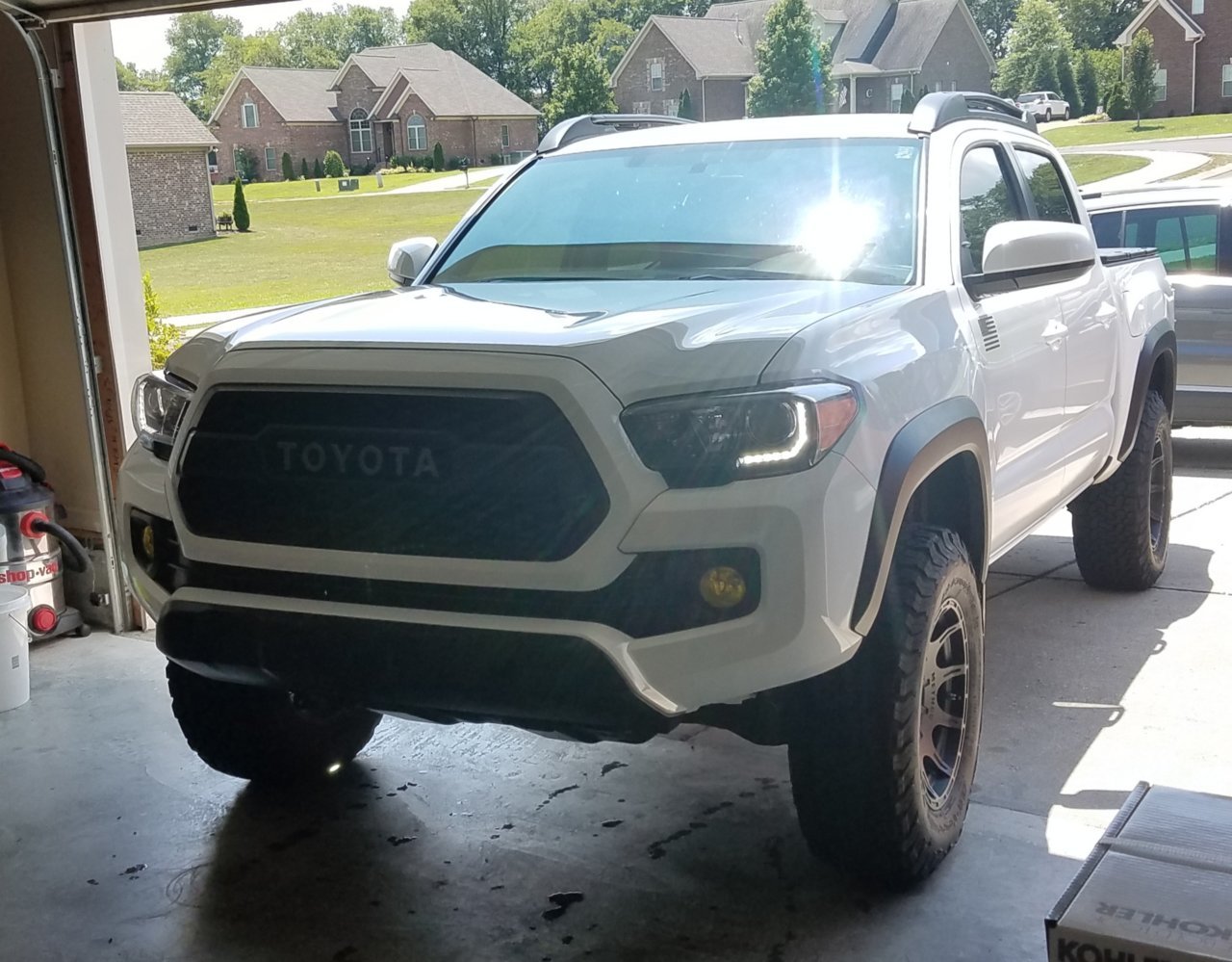

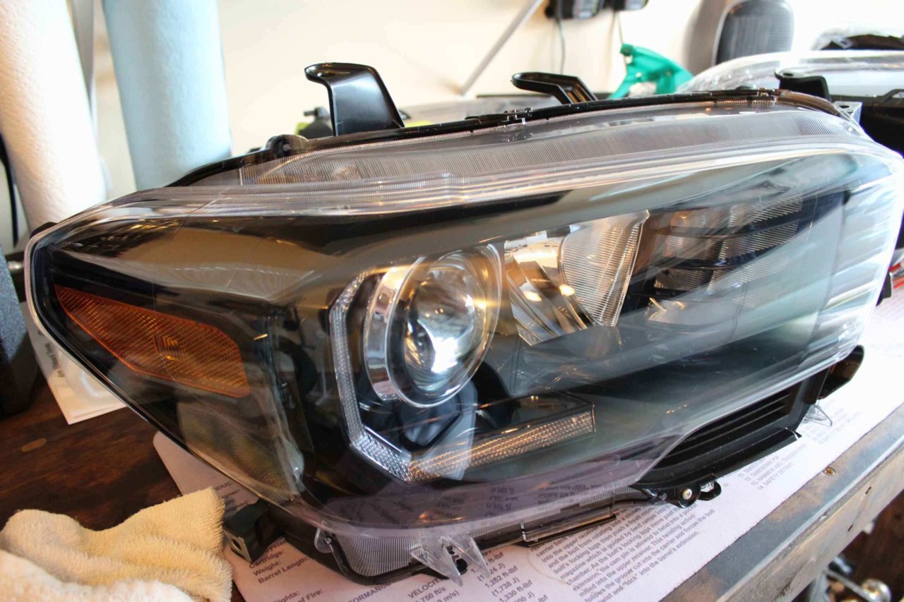

    Put my set on my SR5. Overall I think they are worth it, for blacked out look and to get LED DRLs.
    Couple things I noticed:
    • Quality of plastic does not feel as solid as oem
    • I could see some chrome peaking through on the corners of where gloss black is
    • I found a chrome plastic shaving inside headlight
    • SR5 modules get kind of hot and mounting option was limited
    • Did not have to adjust projectors as they lined up exactly where my oem ones were (taped garage wall)
    • LED DRL are bright and look equivalent to TRD models
    How did everyone else with SR model mount the module?
    (Shaving mentioned)

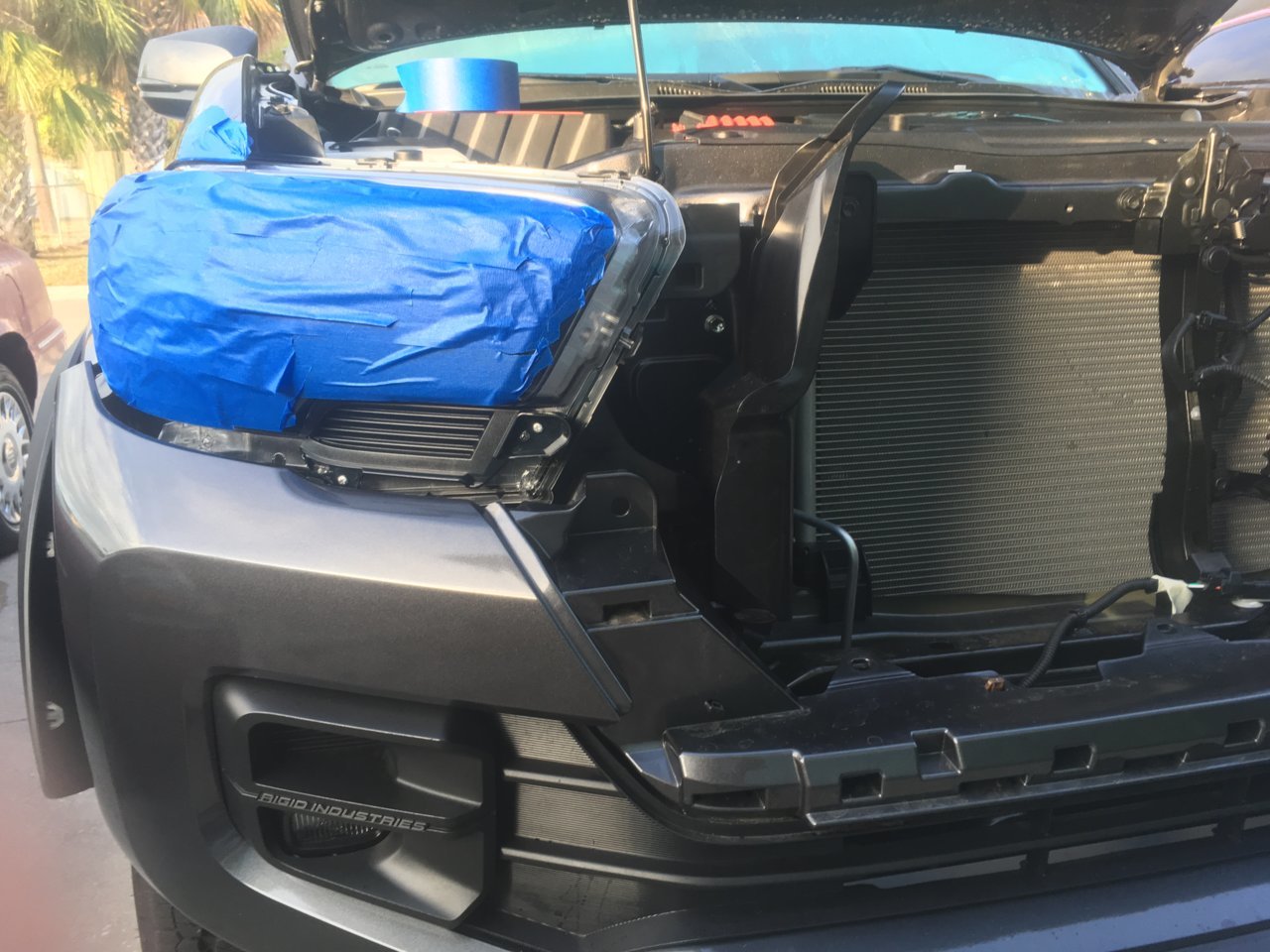

    When installing my OEM pro headlights I placed 5 layers of tape on the entire lens to protect them from getting scratches. Worked out good. Hope this tip helps with installing the headlights.

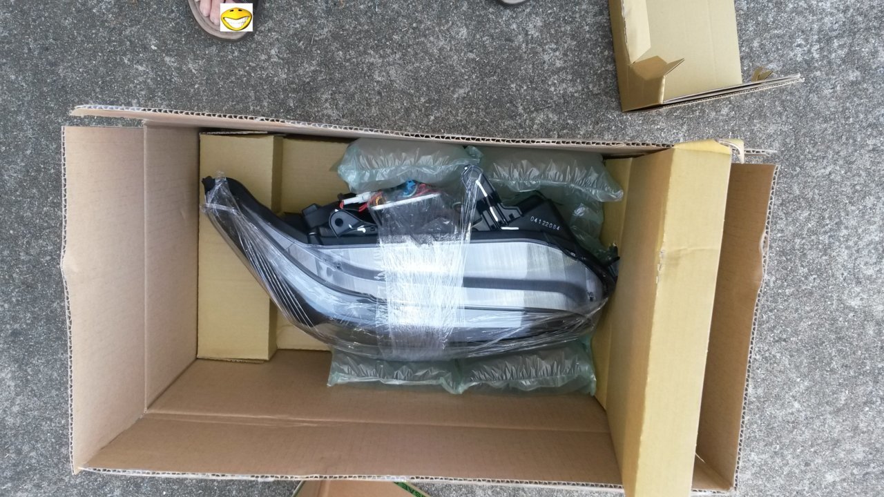

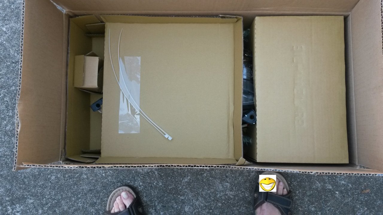

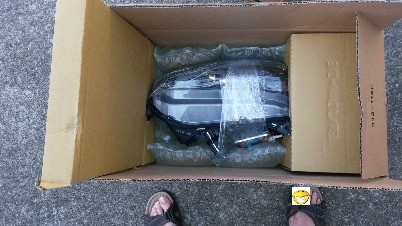

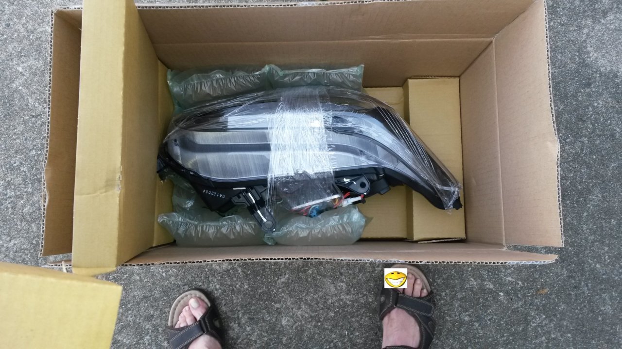

    These may help a little

    Oh sure, go pointing it out.... now every time I look at these photos, THAT'S ALL I SEE!
    Thanks @mrproduxn! (No, really... thanks for posting. I'm sure it helps.)

    Well I quickly realized somebody would notice that and say WTF. Sorry. I should have edited those first.
    EDIT: I FIXED IT

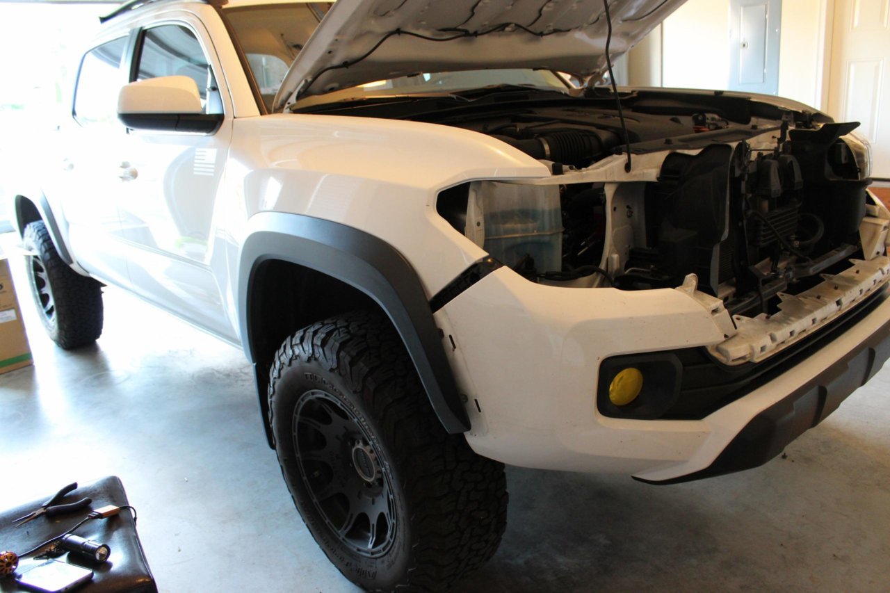

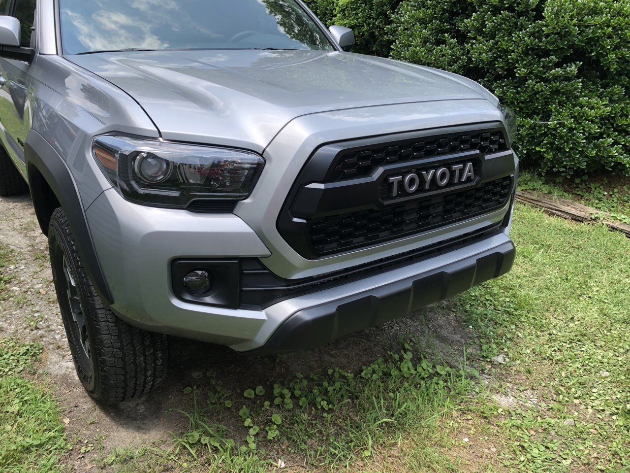

  14. Jul 14, 2018 at 12:12 PM
    #294
    Brutus241
    Brutus241 Well-Known Member
    Mar 6, 2018
    #246500
    49
    Brett
    2017 Tacoma TRD off road

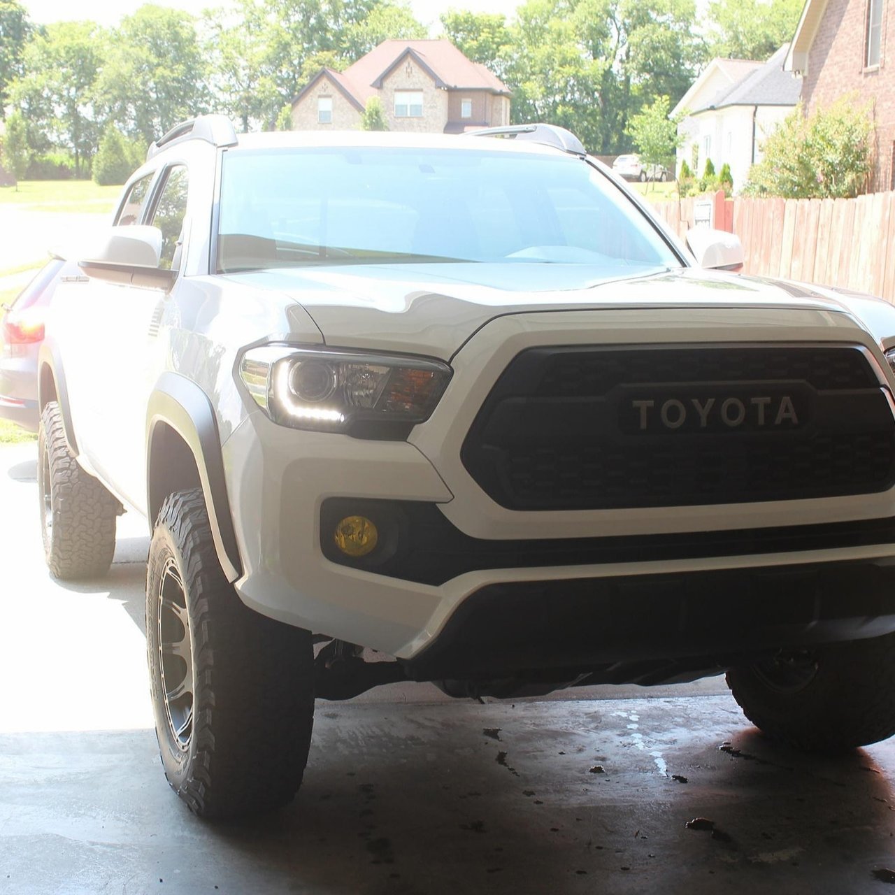

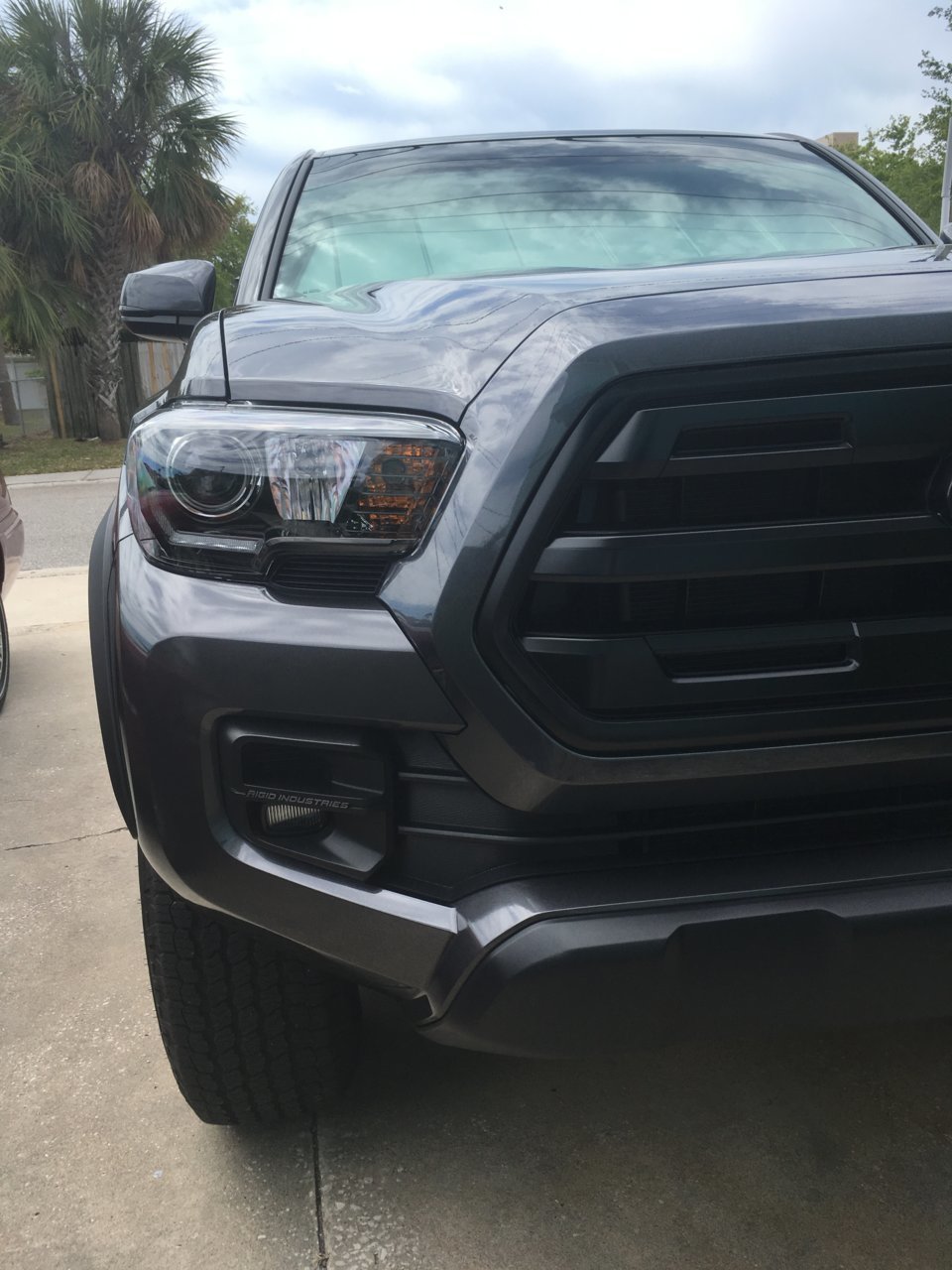

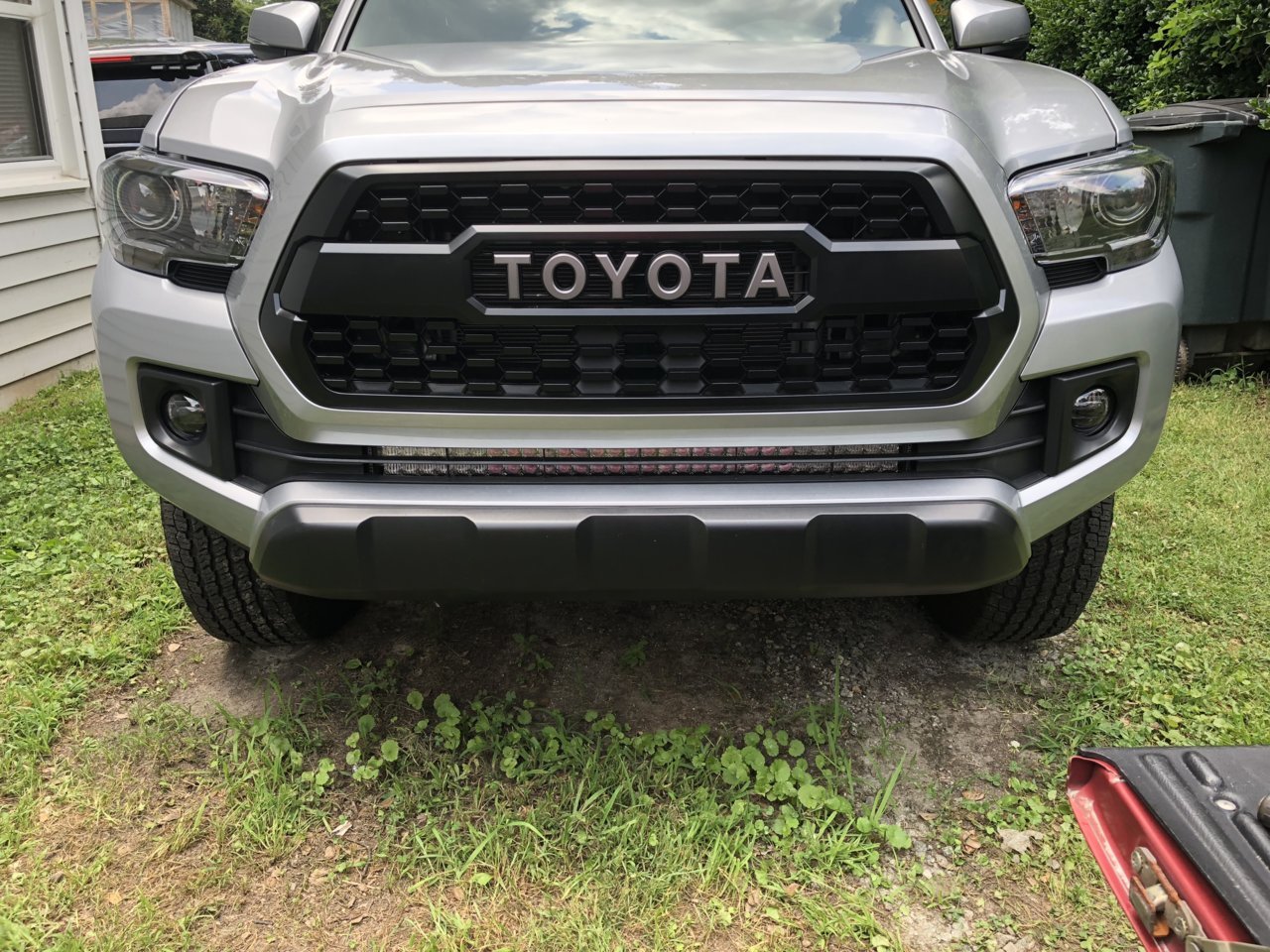

    Just got mine put in today nothing to it. Here are some pictures of the finished job.453E4C4E-EA0C-49BF-BB2A-BC585CCBD5FE.jpgA5788031-BF4B-4E2C-818D-F61EEA556807.jpg 5235469E-143E-4FBD-A459-6F6FF15D1A13.jpg
