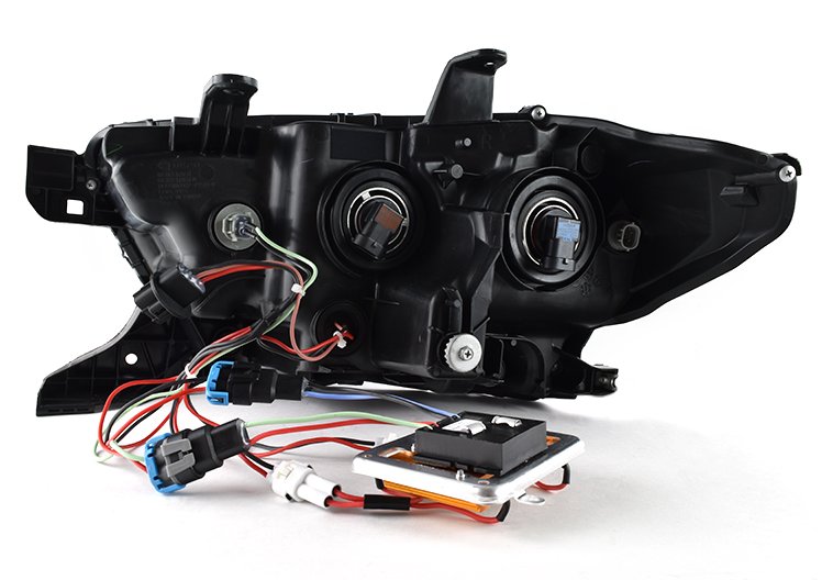

    With those of us with DRL, they supply an added module, but where would you tuck this away and how would it with stand the elements...thats my main concern...
    And if you're going after market, these seem cooler for the same price due to the fact there is no added module for DRL and the DRL doubles as an amber sequential signal, then super white other wise for the same price, and also blacked out:

    I think that entire module gets set aside and bypassed. Hence the cutting of wires they reference if you already have factory LED DRL.
    What I don't get is why similar 'Depo' headlights without the module go for $1200+ on ebay. The LED strip is a take it or leave it thing with me. I keep it off and it's only on when the lights are on.
    Those lights you linked are H7 bulb required and if I remember right, the housing has a sealed cap on the back side which limits what bulb style you can run (no LED). Especially since I already invested in LED bulbs, I'd like to reuse them so the Depo units are better for me.

    So the Depo instructions have you cut the DRL plug off of your OEM headlights to splice them onto the Depo units.
    It appears in your photo you just tapped into the existing wiring, but left the connector intact? Down the road this would definitely be something I'm adding to the truck, but I'd prefer not to hack up the factory wiring if possible.
    I'm not usually a fan of replicas, but the Pro headlamps out far, far too pricey. For $1,500+ they should be OEM LED / HID, so these are a good compromise.

    Honestly i wouldnt be concerned mine are shrinkwrapped and appear to be factory the way they were done. You could always add watertight shrinkproof male/female connectors to trucks drl wires and new kit so if u swap back to original u wouldnt again have to cut/splice. To me this wasnt an issue.
