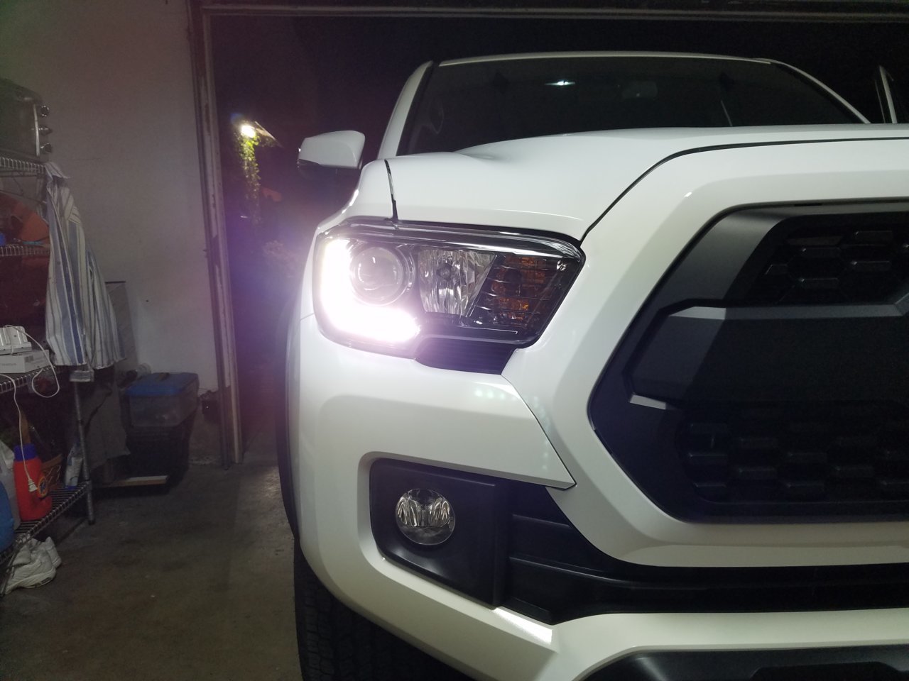

    I received mine today, pretty happy with it. LED strip is as bright as the oem one. Fitment is perfect as well. Took me 40 minutes. I opted for the extra $20 so I didnt have to cut into my oem harness for the LED strip.

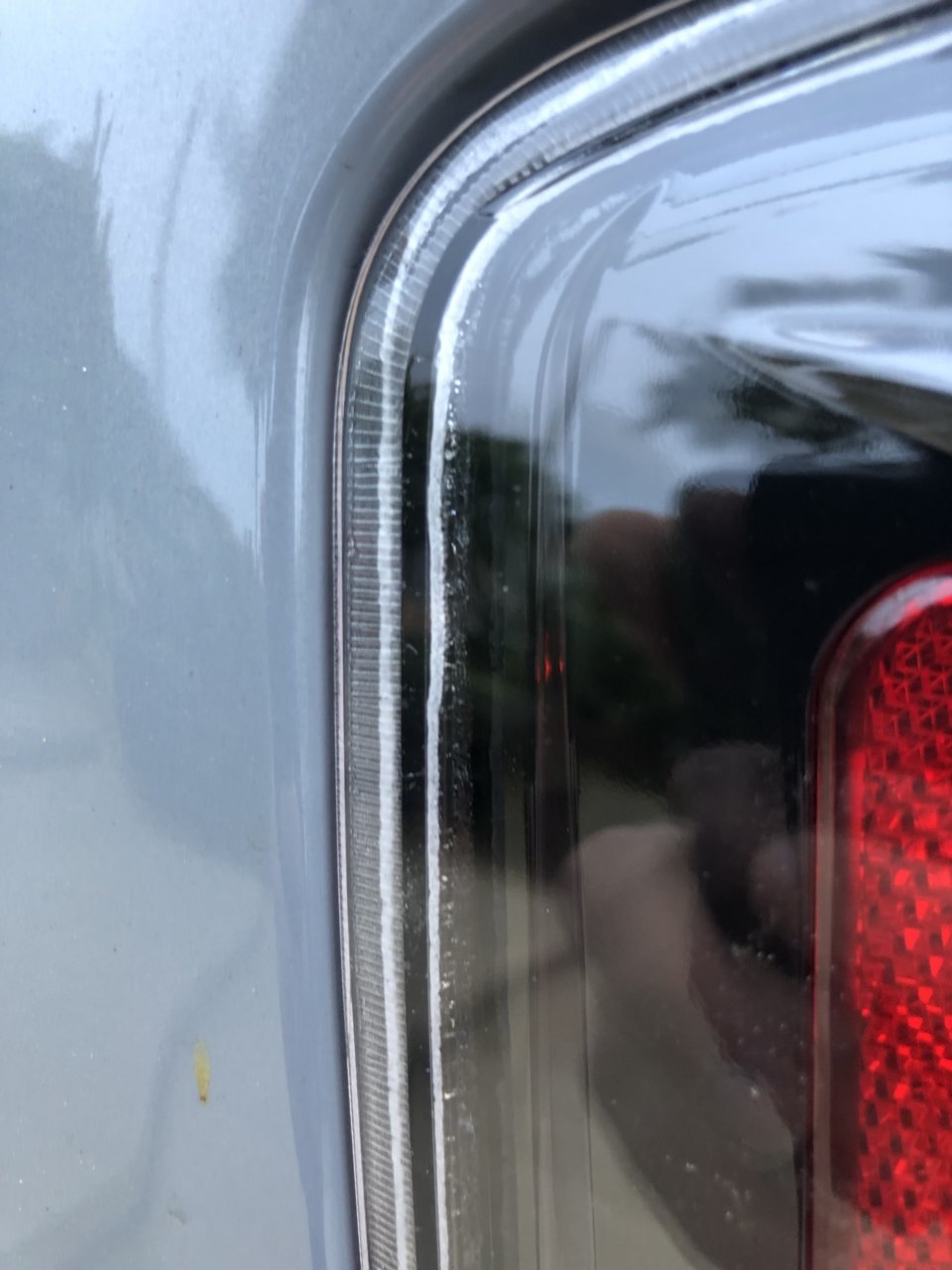

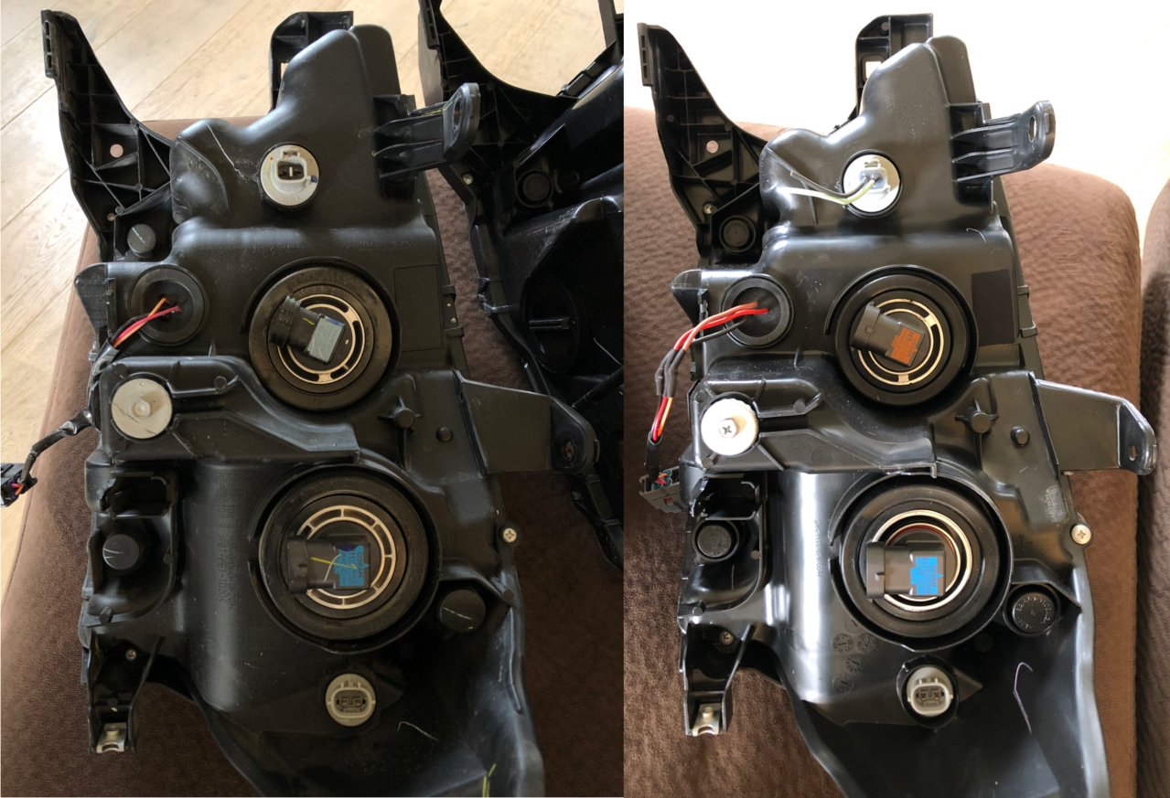

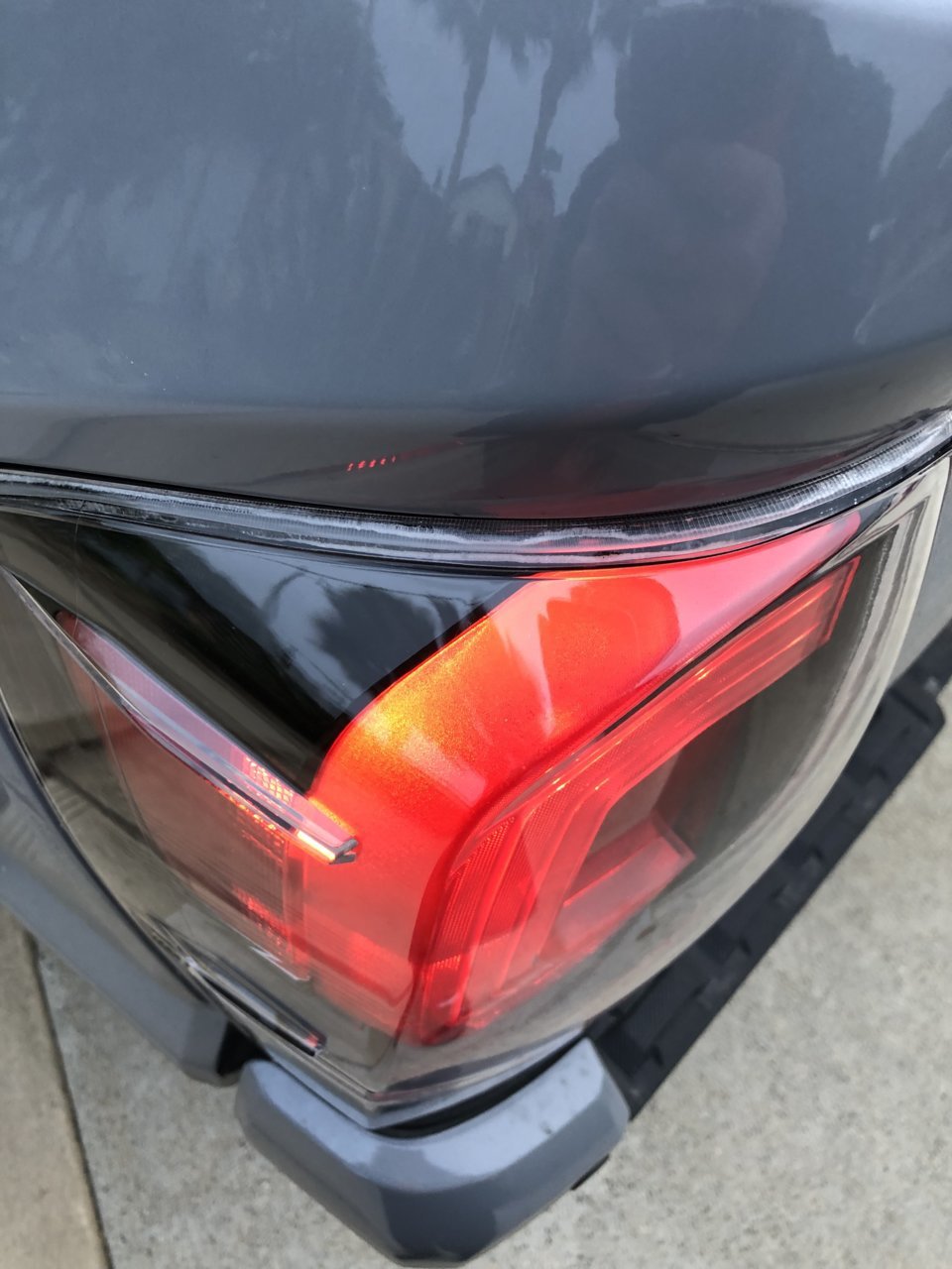

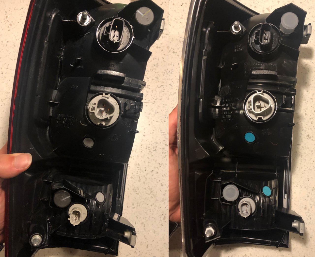

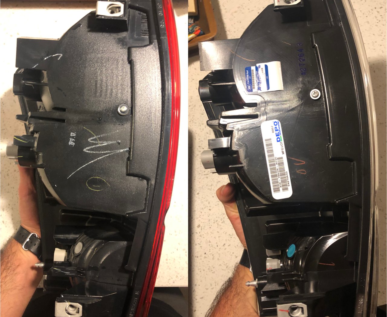

    Here are comparison pictures of the rear. The injection molding seems nearly identical, the only thing that seems different is the glue they used. You can see in the picture that there is white residue from where they glued the housing and the lens together. I've had them on for some time now and there is no water inside. They also came with bulbs. In the last two pictures, you can see little white covers on the depo lights, they are cheap caps. I swapped them out with the OEM rubber caps that seal better.

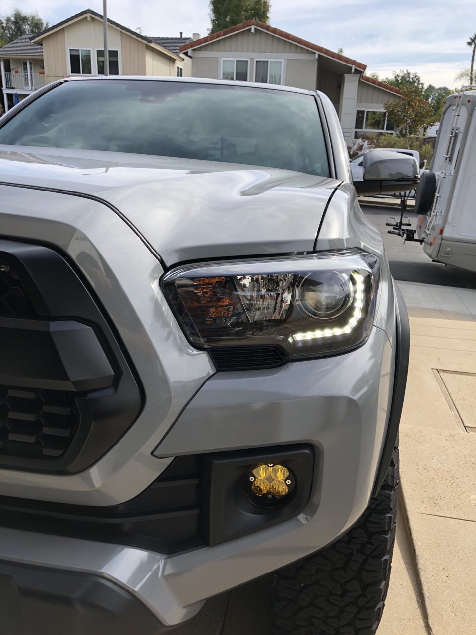

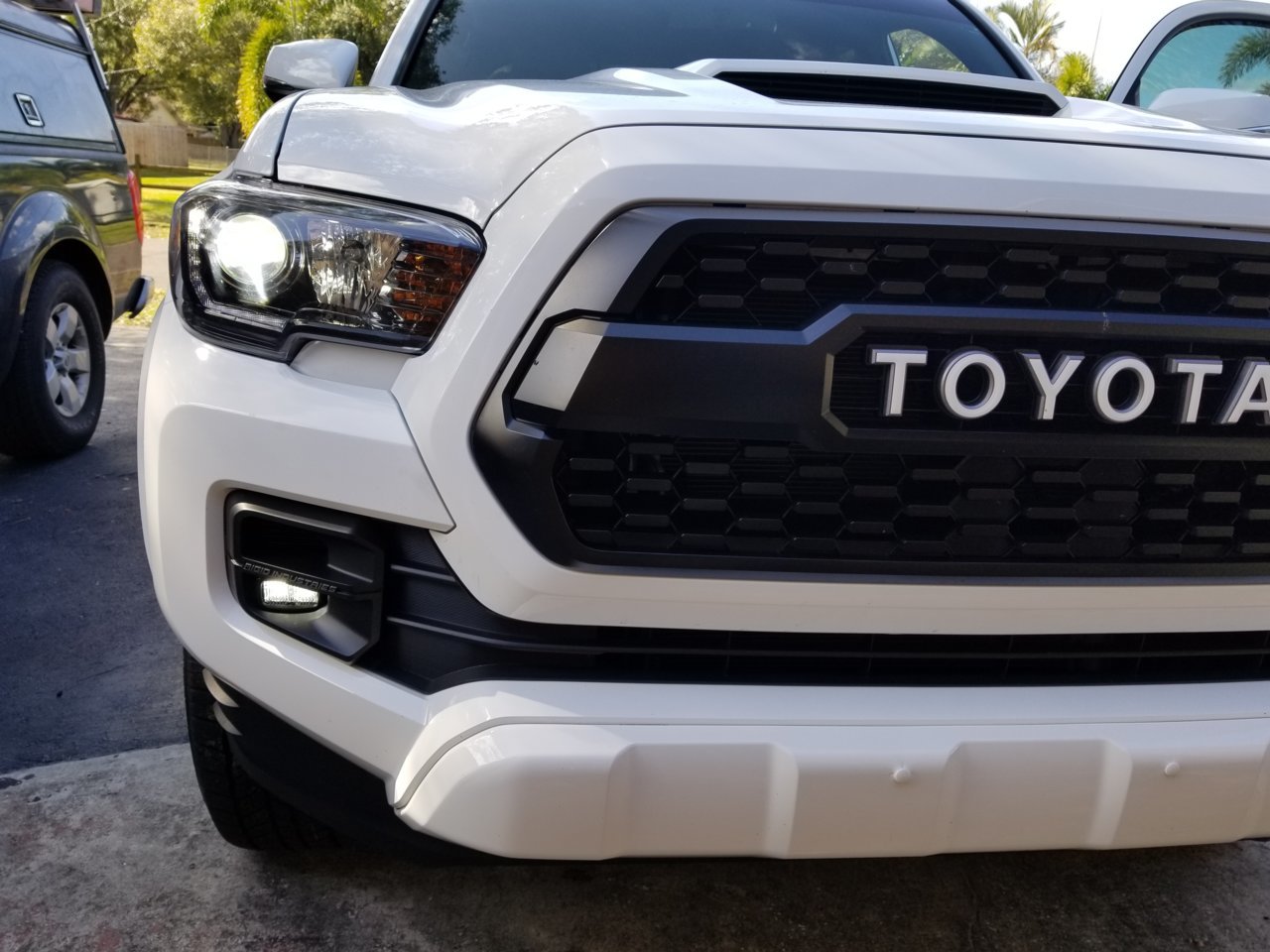

    And the front! Front didn't have the glue problem, they look really good. The LED strip is a little brighter than stock. Like the rear, i swapped out the plastic caps (headlights had black caps) for the OEM rubber ones. These were the ones that have the DRL connector, so they were plug and play. I ordered through Unique Style Racing, they came in about 2 days which was surprising for how big the box was. I also live in Southern California.

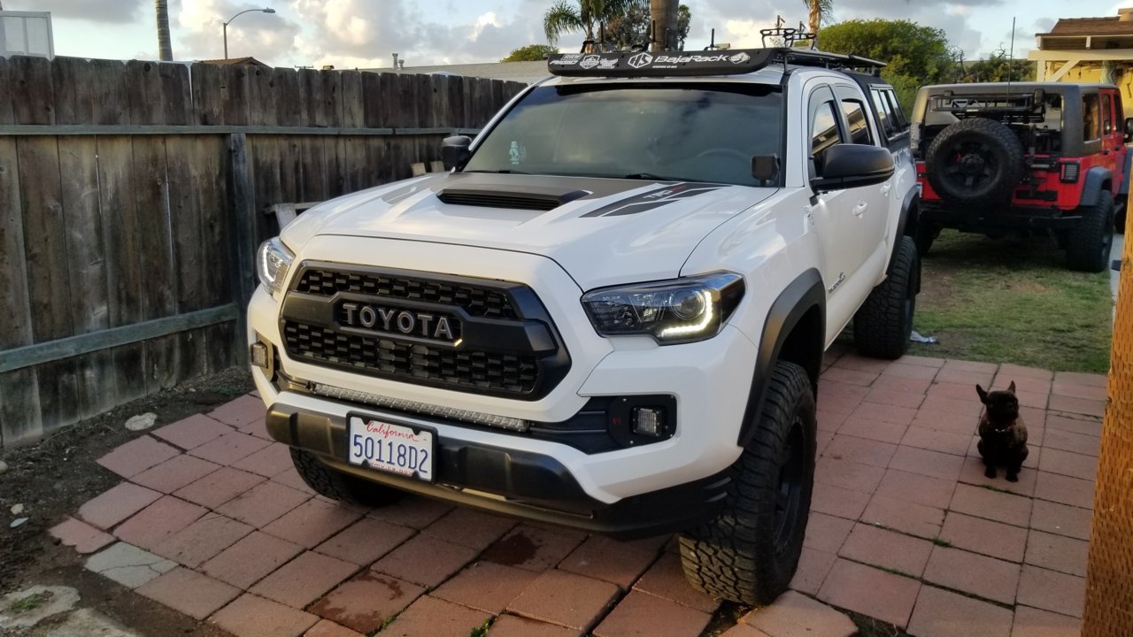

    Paired with Meso's under the headlight plate. Loving my Depos
