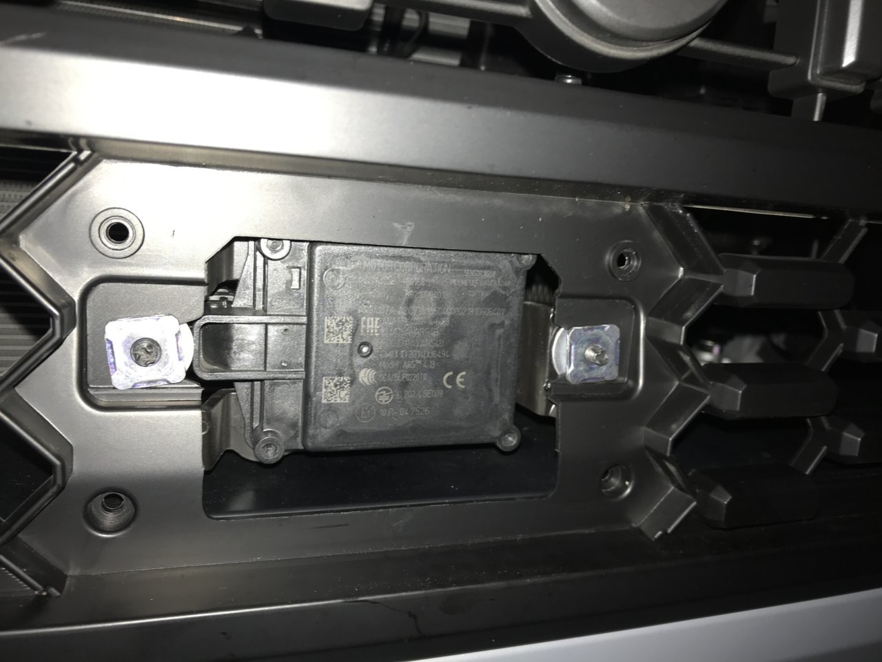

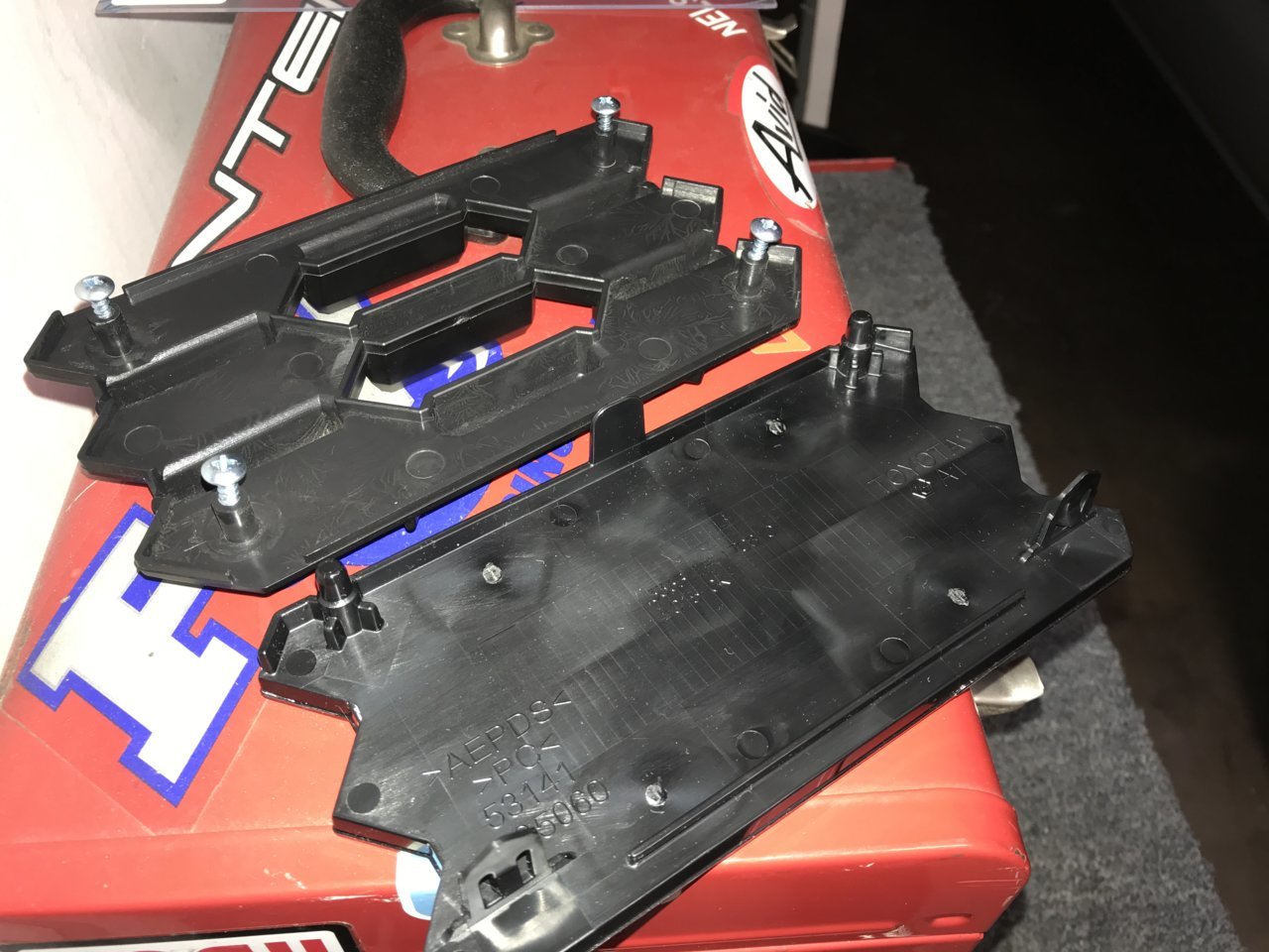

    So I bought a TRD Pro Faux Grill from CaliRaised, installed it, looks awesome. Being that I have the 18' Tacoma the TSS Sensor went off and left it's mark on my dash. I talked to CR and they told me to use the Toyota garnish(PN 53141-35060), so i ordered it thinking it would pop right in place of the Faux center garnish that is removable. When I got the recommended garnish(PN 53141-35060), I came to find that it doesn't even work with the CR Faux Grill. I know some of you have probably had this issue. My question is what's the best fix spending the least amount of $? The image with 2 Garnish's, the one on top is the original Faux Garnish. Any help is appreciated, thank you.

    why not dremel a slit on the bottom?

    Same thing happened to me. I used a combination of drill and dremel to create the slots and used the Garnish. No issues as of today with the sensor or adaptive cruise control. Be careful with the 2 tabs as you are modifying it and test fitting.

    You need to return the grille and get one that works with the garnish. Unless you got it for $50, why should you have to hack into it to make it work? If it’s advertised to work with an ‘18, that’s clearly not right. If it wasn’t, then that may be on you. I got a knock off Chinese one from eBay for $101 and it had slots to accommodate the garnish perfectly (got that on eBay too—$50).

    I have an 18, the garnish a actually requires crush nuts, instead I used 3m double sided tape with the red backing, just cut some small squares of it, make a small hole in the center of the squares, push through and be be Donesk, I have no rattle also my pro grille was factory

    My china grille had the SLOTS at the bottom of the radar sensor opening and fit the OEM garnish piece perfectly. The garnish piece has little clips on it similar to the entire grille itself and should click/clip in place at the bottom, through the slots. I then followed the advice of a member on here and went to ACE hardware to get the "star washers" or "star locker nuts" or whatever you want to call them. They were like $0.24 ea. versus $1 ea. from Toyota and waiting 2 days for them to arrive.
    I would say that if the grille was advertised as working with an '18, that's misleading since it doesn't. I read that some of those grilles did NOT have slots at the bottom to accept the OEM garnish. The one I ordered on ebay specifically showed them, but I was still skeptical since a lot of those sellers just take other people's pics and reuse them for their items. Turns out, the one I got DID have the slots and that's why I cancelled my OEM grille order. I later read that others had ordered from the same dealership in FL and had their orders cancelled for them due to the 'stop sale' that Toyota has on the grilles.
    At this point, you have a couple of options: 1. Modify it to work with the garnish piece (or modify the garnish by removing the bottom clips that go through the slot) and rig a way to keep it in place. or 2. Return the grille if it was advertised as working with an '18 but doesn't.
