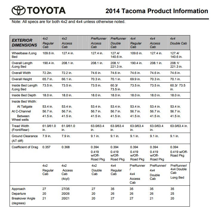

  4. Sep 6, 2023 at 7:13 PM
    TnShooter
    TnShooter The TacomaWorld Stray
    Sep 2, 2010
    #42625
    21,360
    Deogee
    07' TRD Off-Road, Auto
    STOCK
    Jimmyh likes this.

    Well the measurements I got are actually wider than the printed specs, so thanks for saving me the hassle of taking it out
    Never in 50m years did I think there was a composite bed on there

    Well, the dimensions above are what you need:thumbsup:
