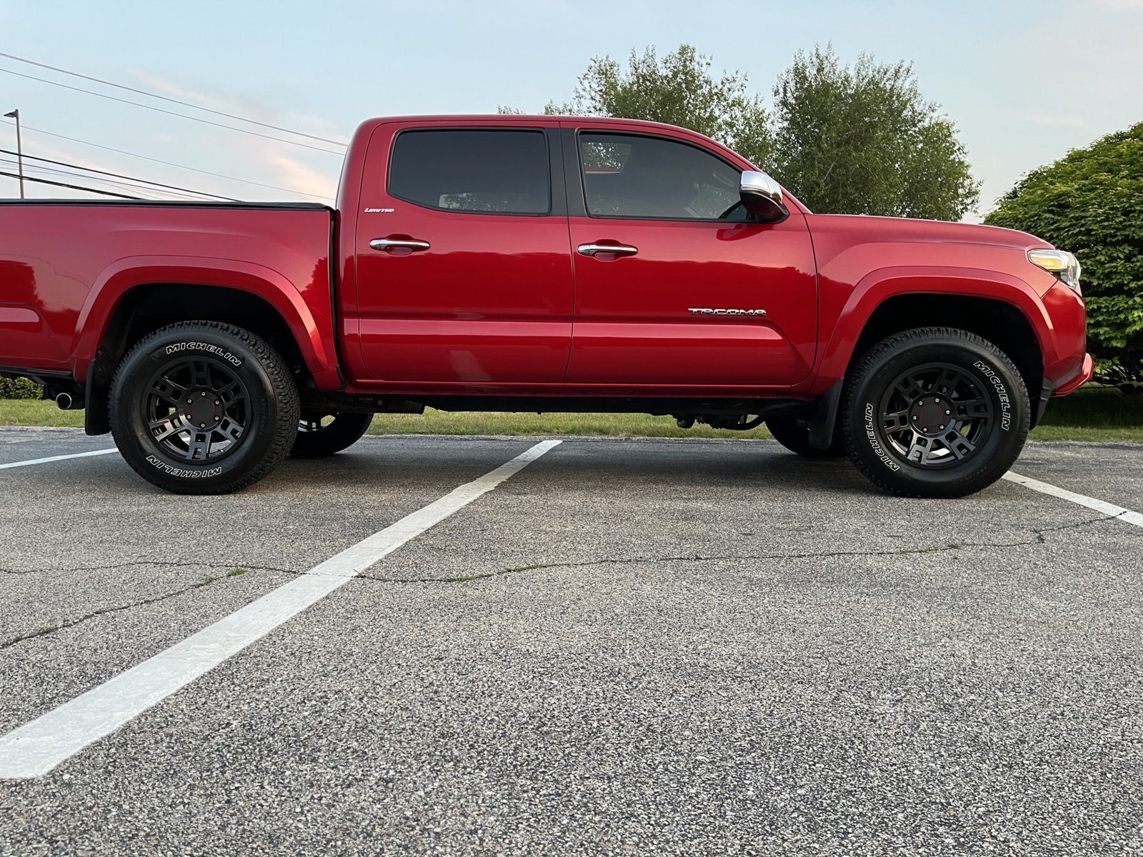

    Can you ask you for specifics on the Michelin tires you chose - they look good on what appears to be a stock suspended truck....thanks
  13. May 24, 2024 at 11:48 AM
    #53

    No lift.
    Michelin LTX AT2 - P265/65R17 on 17x9, zero offset. Very smooth and quiet.

    If I could impose one more time for a pic or two showing where the wheel/tire sits in relation to the wheel well lip (ie poke). Trying to assess impact of 0 vs -12 offset... Thank you

    Not a problem at all.
    Zero will be about flush with the edge of the flare depending on your wheel width. I have 9” wide wheels so they poke out about 1/4” at the most. An 8” wheel will probably be perfectly flush. I’ll take a couple of pictures tomorrow morning and send them via PM.

    Thanks - I am currently thinking I will pretty much copy your setup but the wheels I am looking at are 17x9 -12 - will spend some time on the weekend looking for 17x9 0 offset wheels - cheers
