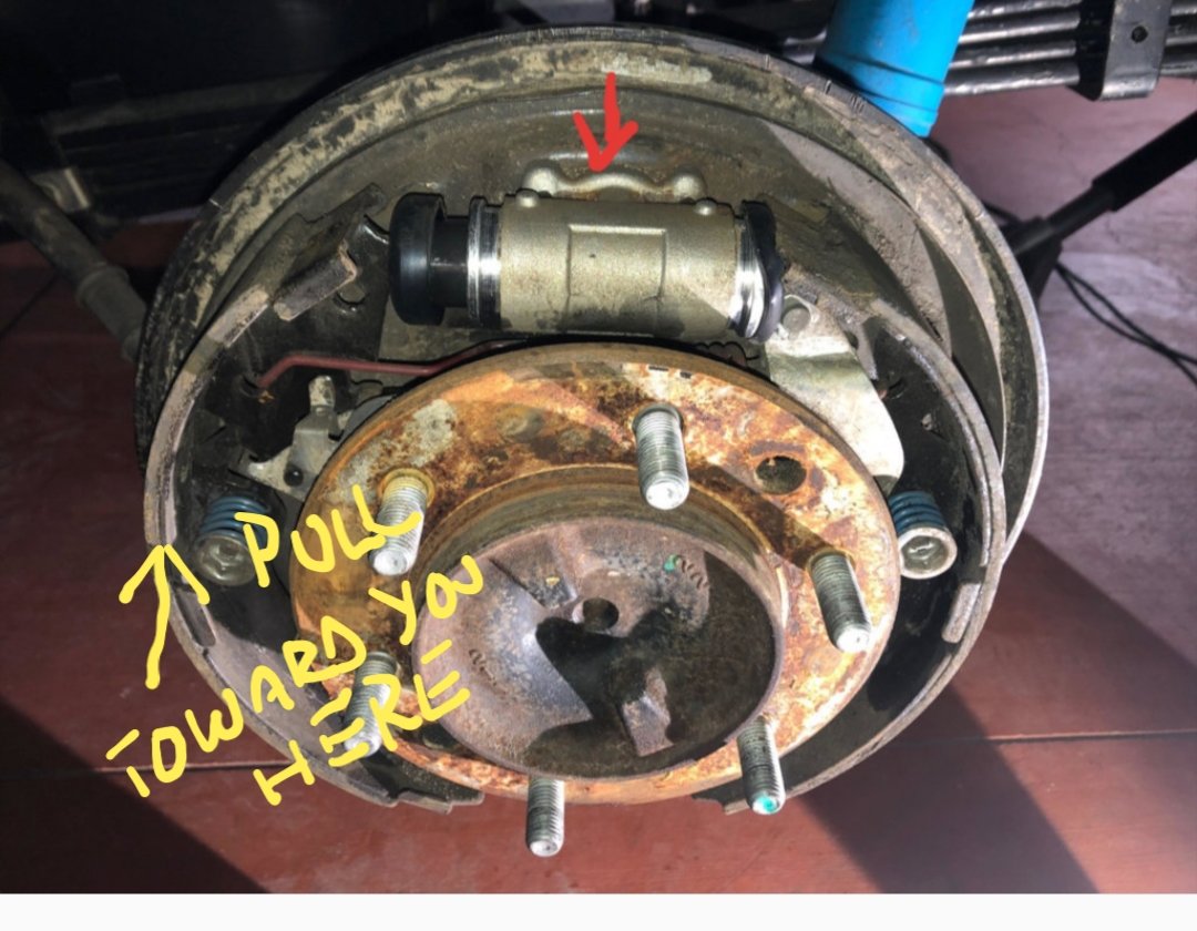

    That's exactly what I was doing tonight. I just made a rookie mistake by pressing down on the brake pedal without the drum cover on.

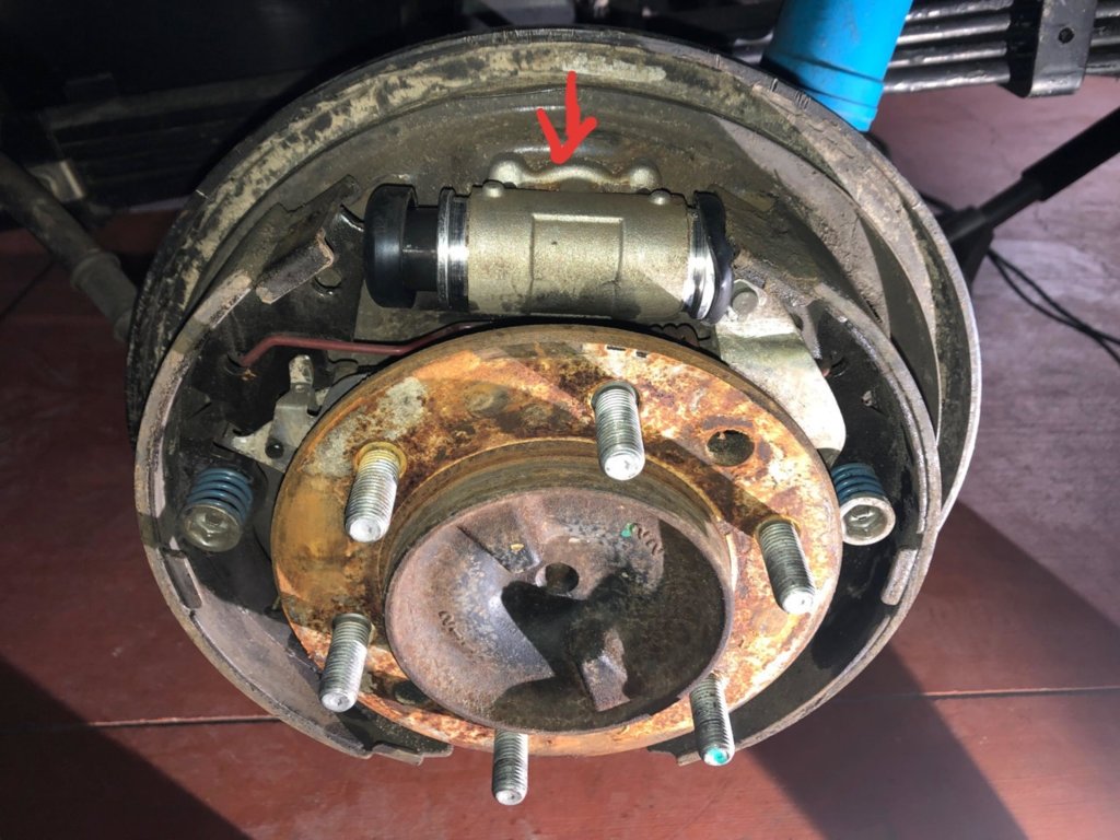

    Bleeder us the little tip on back of wheel cylinder on picture red arrow. Only use a boxed end wrench if you don't have line wrench.

    I was able to bleed some fluid just now, however even with the bleed valve completely removed, no amount of force on the ratchet strap will get the left cylinder to compress. Any more force and something is sure to break. Also took the fluid reservoir cap off during this.

    Also unless things have changed, you don't adjust the e brake with the star adjusters. The e brake is a cable and should have an adjustment under the truck where one cable split into 2. Just a nut and stud.

    Did you try slightly lifting on the outside of the left shoe as I mentioned? Not much, only about 1/4 inch.

    I did. Do you mean out towards me? Or towards the front of the truck?

    I'd just replace the wheel cylinder if you can find one at a parts store locally, then bleed and go. I just checked RockAuto and they're only $10 bucks.

    Pull towards you about 1/4 in.

    The only force holding the cylinder out should be fluid pressure, therefore the “stuck” force is probably from a misalignment of the components. Check how everything is aligned and assembled (brake contact points with the cylinder especially). Take your time going over all components... you can always Uber to work tomorrow morning if necessary.
