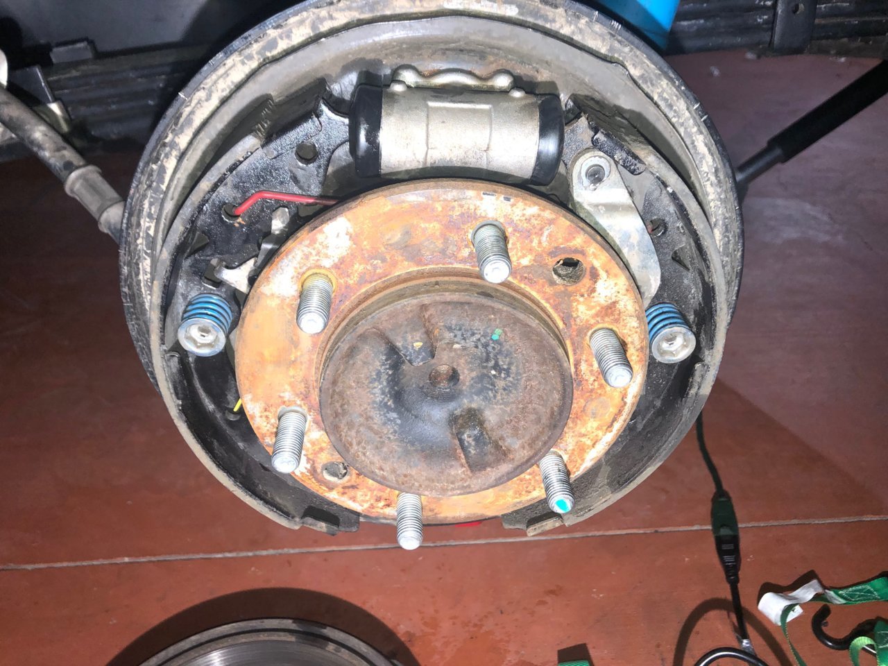

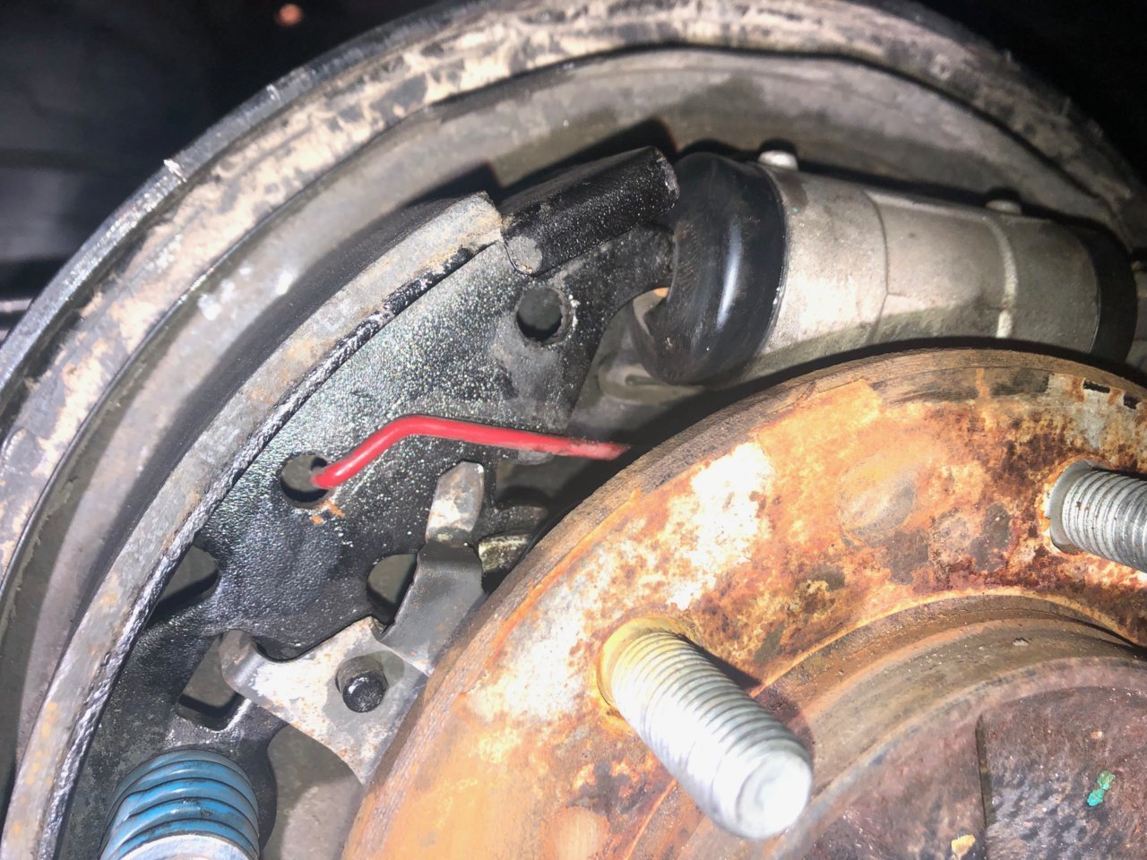

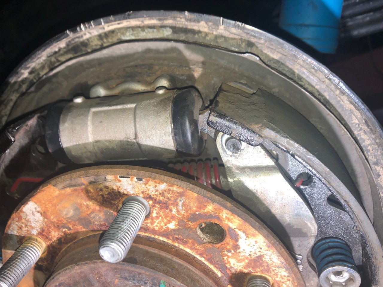

    Alright guys so after a while (and the help of the girlfriend who was sick of me huffing and puffing all night), I think we got it.
    Basically ended up as a last resort putting a c-clamp (actually a caliper piston spreader) over the left cylinder and a notch in the right cylinder. Opened the bleed valve, and began turning the clamp. At one point the left piston snapped back into the cylinder and some brake fluid squirted out the bleed valve. Had her sit in the truck and pull the e-brake up and down a few times and both shoes move back and forth as they should it seems like.
    Below is how it looks right now. Anything else I should do before putting the drum cover back on? Some of you mentioned bleeding the rear brakes afterwards but what is the goal in doing so? Not sure I understand the basic theory behind bleeding brakes in general.
    Regardless though, I'd like to thank every single one of you very much for your input on this. As simple and probably laughable as this probably is to some of you, I could not have made any progress without your help. Cheers!

    Did you bleed that brake? Looks good from pick. Keep an eye on it for fluid loss just in case seal got damaged. Good job.:hattip:

    I opened the valve a few times as I tried some different things, so a decent amount of fluid did come out. Then like I said, when it finally popped back into place, a good stream squirted out of the valve too. But other than that, I didn't do any other bleeding. Should I have? The reservoir under the hood is still full.

    Looks good OP... return the drum and have your GF assist with bleeding the brakes (removes the air in the line). Pump the brakes with the bleed valve closed, hold the brake pedal down, slowly open the bleed until the brake pedal hits the floor... close the valve and repeat until nothing but fluid comes out in a steady stream. Initially you will hear air and see gaps in the fluid stream. Once you’ve completed that, replace the tire and top off the brake fluid in the reservoir... nice job, we were all pulling for you!
