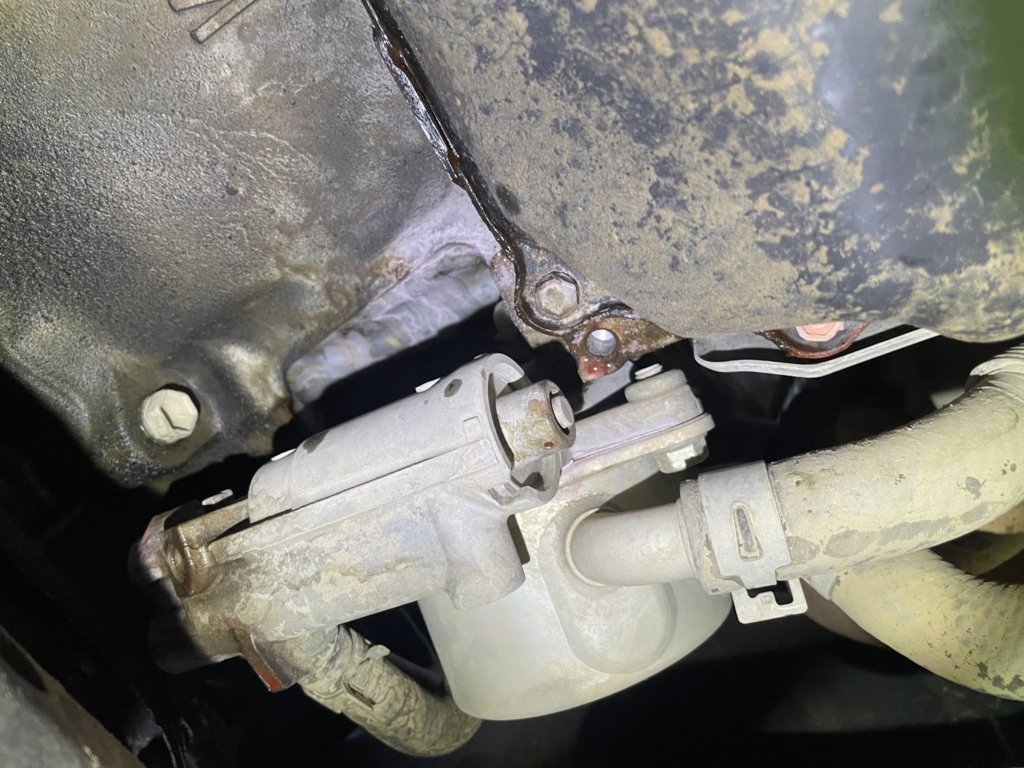

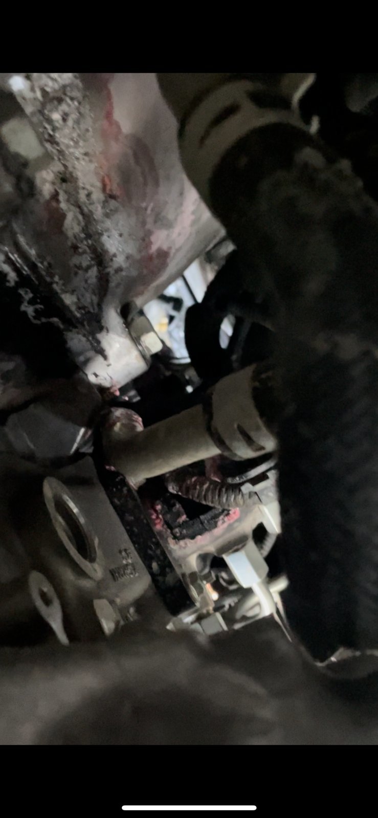

    Hey y’all, so I discovered a coolant leak unfortunately. Seems to very slowly drip even with the truck off. Definitely a bit faster drip with the truck running but not continuous drip (at least on a cold start).
    I tried to track it but having issues. Due to the general location of the drip and noticing some evaporated residue on the side of the transmission- I am beginning to fear it is the bypass coolant hose..
    Any ideas if I can test or isolate that area to confirm if the bypass is what’s leaking? I looked around to inspect the hoses back there but it doesn’t seem to be coming from any hose as far as I can tell- but it’s and to see & maybe there is some hose or other connection somewhere back there that might be the culprit.
    Not sure how long it has been leaking for- but I just noticed the spot on the floor yesterday, and it gets driven daily.
    Truck has about 130K miles 2016 V6.

    Its the infamous coolant bypass leak, it mostly affected 2016 and 2017s . Its gonna be atleast 1k bucks or more :(

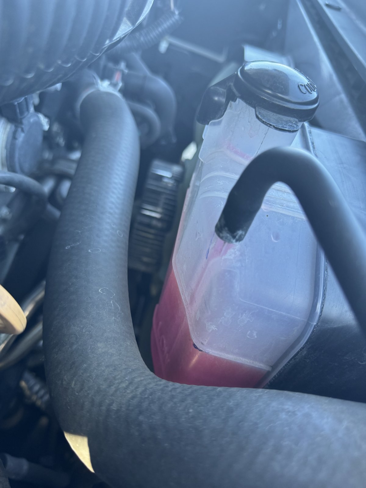

    wait do you have a picture of the coolant reservoir? And not that its boring without pics it just gives everyone a general idea what were are looking at fyi

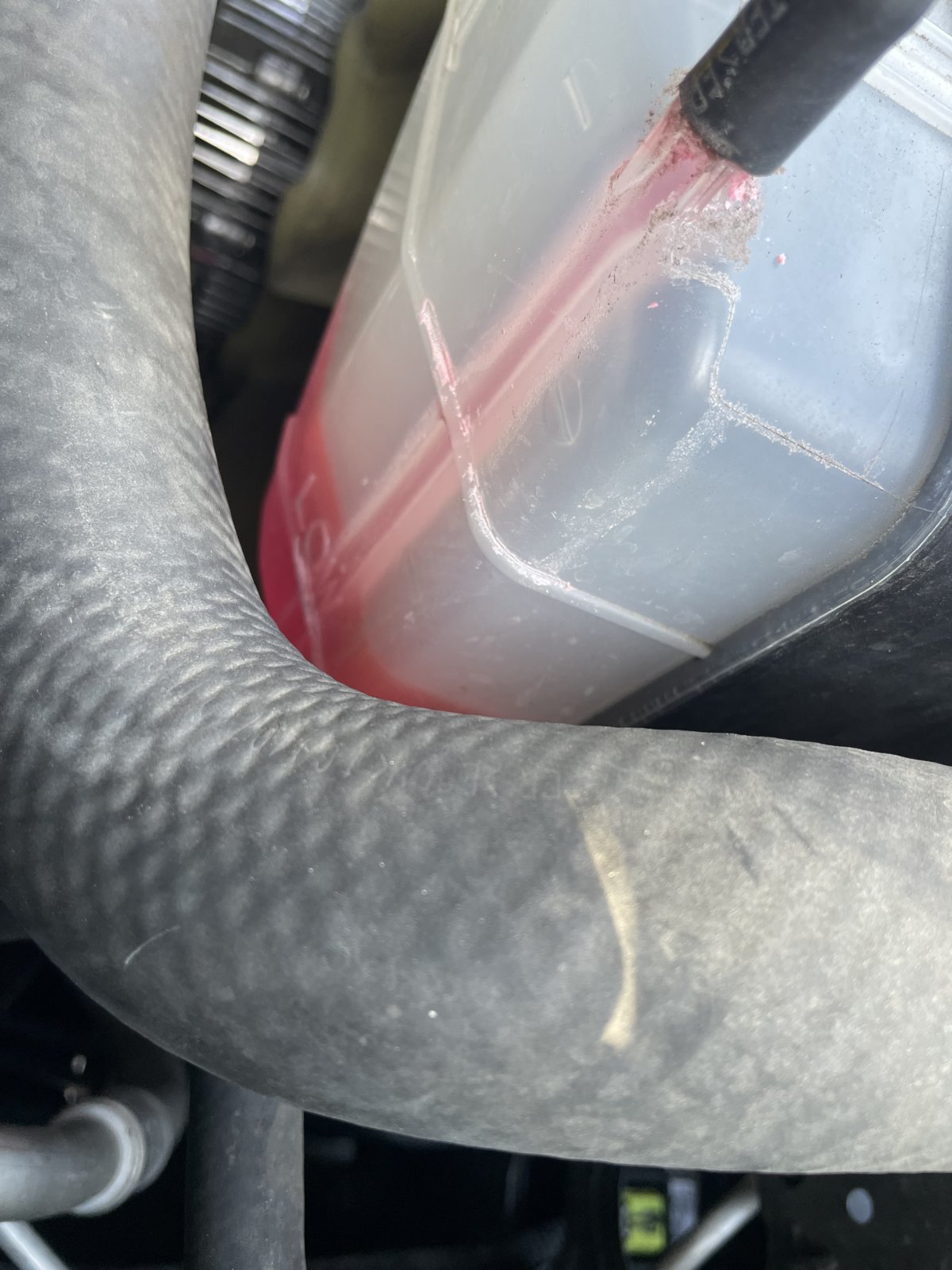

    I do.
    I actually took the picture to monitor how fast the level may drop while I figure out what I’m going to do.
    the coolant reservoir is leaking a bit at the hose connection.

    keep i mind so of the coolant can be still in the hoses and radiator , but honestly its hard to diagnose over the internet. I would take it to the dealer asap and let us. if you dont mind

    dont try to refill it unless your 100% its really low , like previously stated sometimes some or most of the coolant stays behind in the hoses and radiator. I also know that some coolant will leak around the reservoir and hose connection , theres people on here that tightened it with a hose clamp

    Doesn't matter if it's the pipe or a connection, you'll likely have to remove the intake manifold to get in there and see what's going on. Either do it yourself or pay someone..

    Just wanted to enter an update. Had the coolant pipe replaced at an independent shop. Saw the old part, didnt think of taking a pic. There was crystalized pink coolant along what appeared to be a seam in the old plastic pipe. They pulled the intake and went that way. Cost about $1250. Had to do it. Hope to keep the truck for awhile longer (2017 TRD Off Road AC, 45000 miles).
