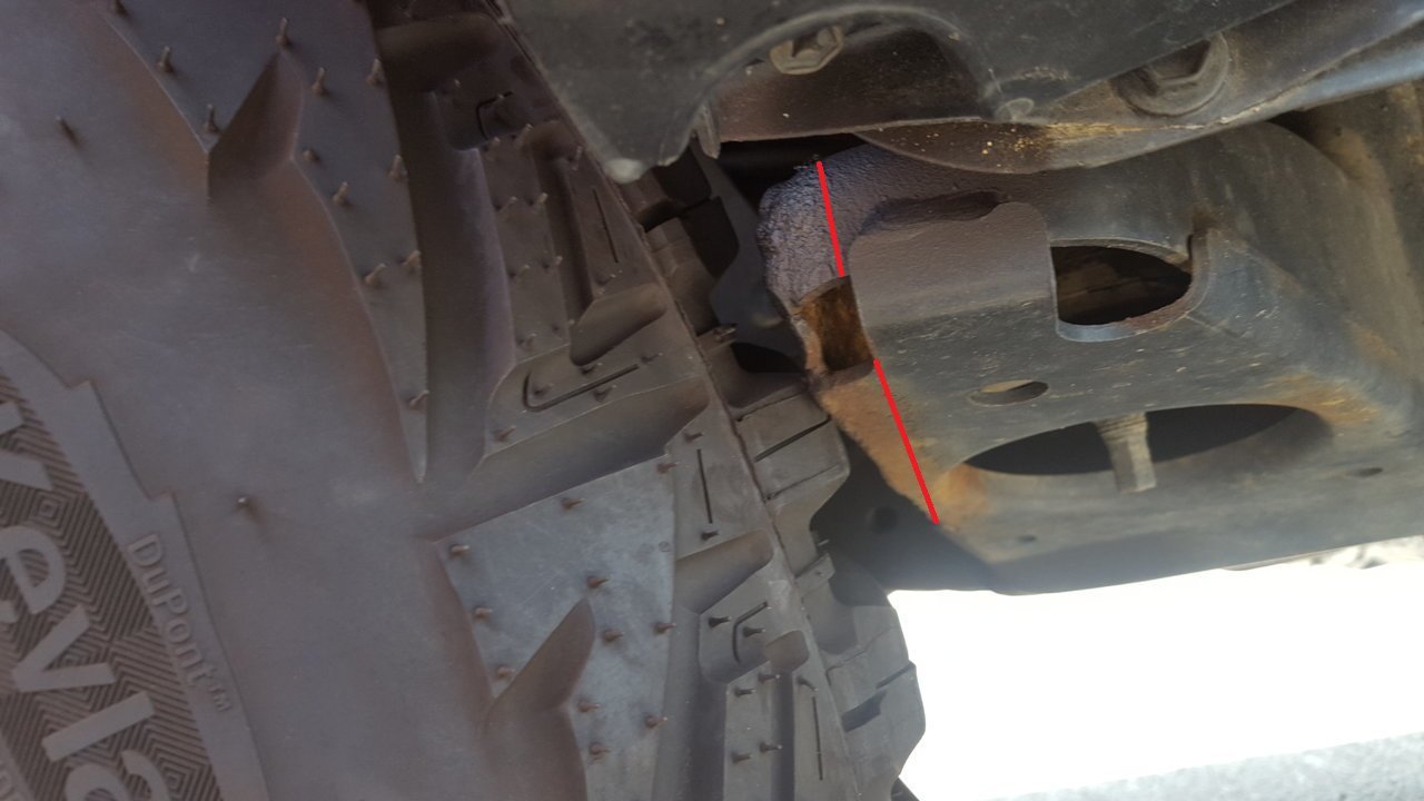

    He didn't cut enough off. This is where I cut them for a standard 285 CMC. Pictured below is Brians cab mount before I got my hands on it.

    Picture doesn’t show for me but that makes sense I thought perhaps CRS had kicked in again.

    What about now??

    So where the red line is is where you cut and all the rest was left after the first time? I usually cut all that face off all the way back into the bolt opening. He should have good clearance now

    Yeah I cut back to the red line! Get as much clearance as I can without having to box it in.

    We all do it a little differently. This is why I make the plates myself. It allows me to cut even more of the mount away and then I replaye sith 3/16. I try to cut even back into the hole, leaving enough to temove the hardwate if need be, and angle the plate back at the bottom a little. For 34’s or 35’s i cut the whole end off also and do the whole thing with a rounded taper.
    For these i cut all the way back to the frame as well. In the cut pic thats as far back as I go for like 285’s i just don’t cut the end off. Fun stuff cool your staying busy with it

    Yep, zero rubbing now! :cheers:
