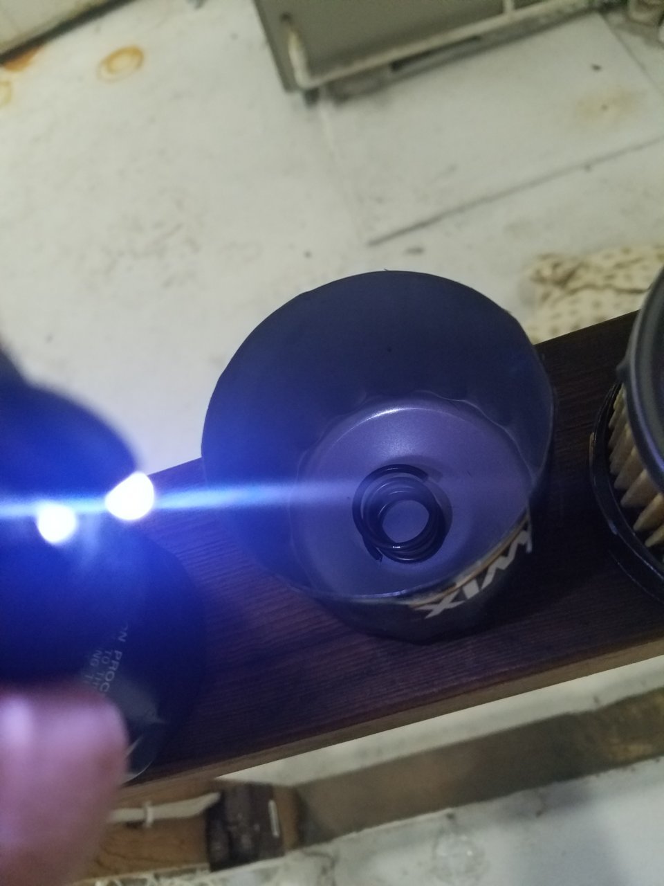

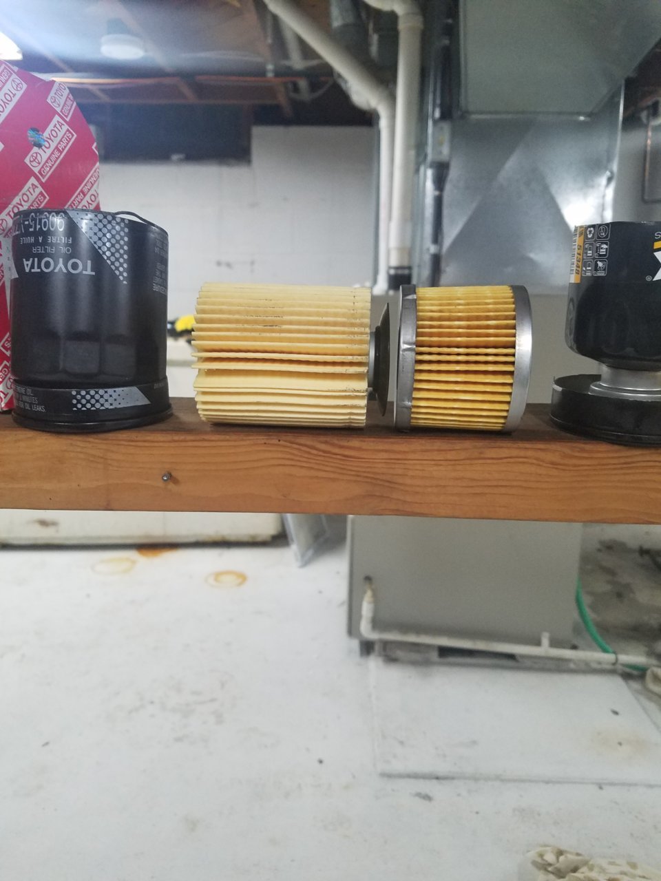

    What did you find? Here is a good video already done yet it only compares a few aftermarket ones

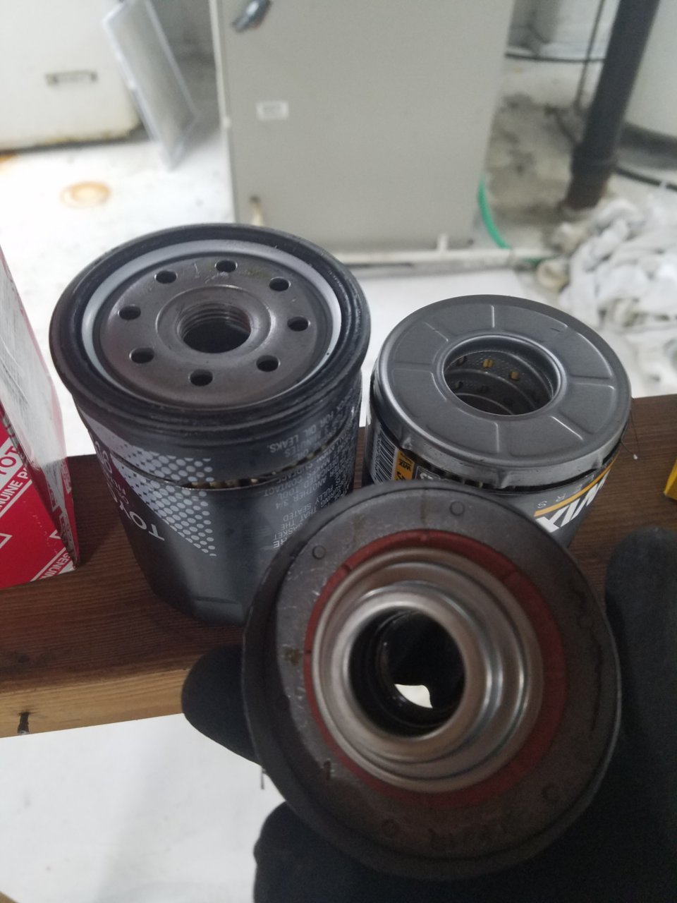

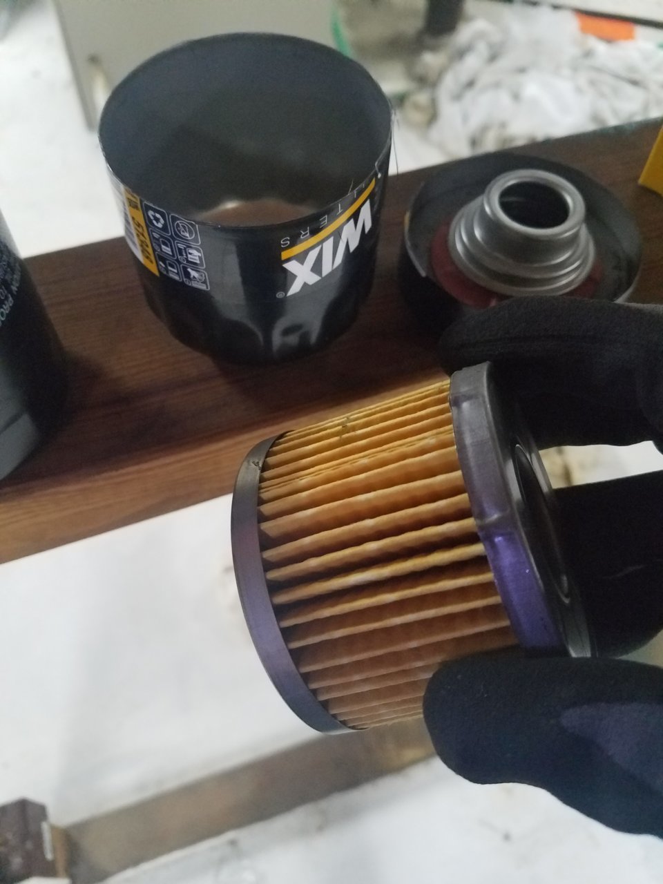

    Mixed results wix has a better seal thicker can n top better valving and pleats. Toyota one just all pleats no valve cheesy top globbed glue. But better than alot i have seen.

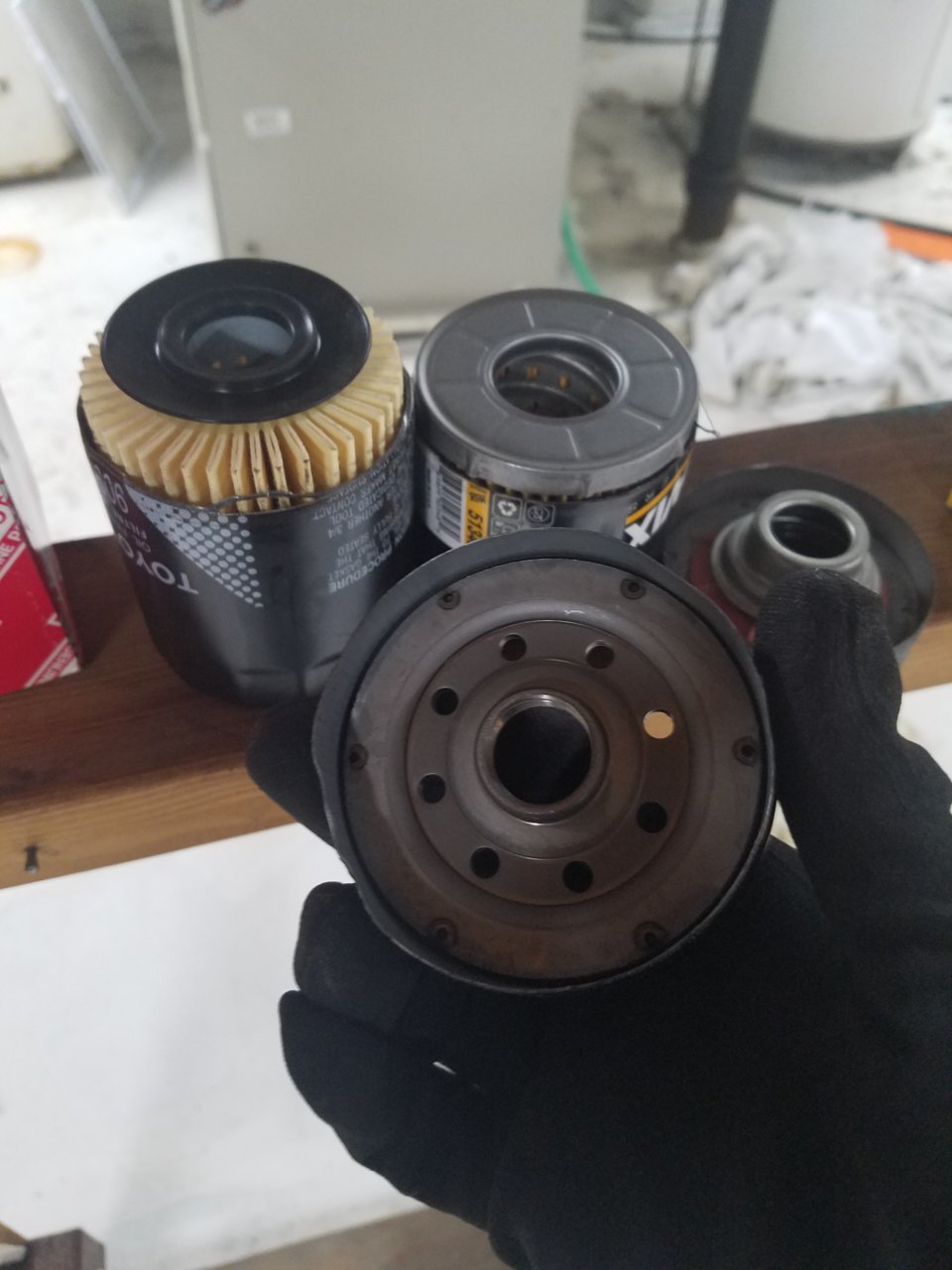

    :worthless: I am surprised there is no bypass valve. Oh I've cut open a ton of filters most are very unimpressive and I would never put on my vehicles.

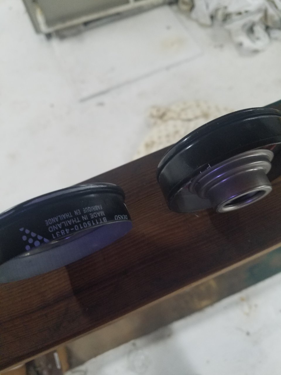

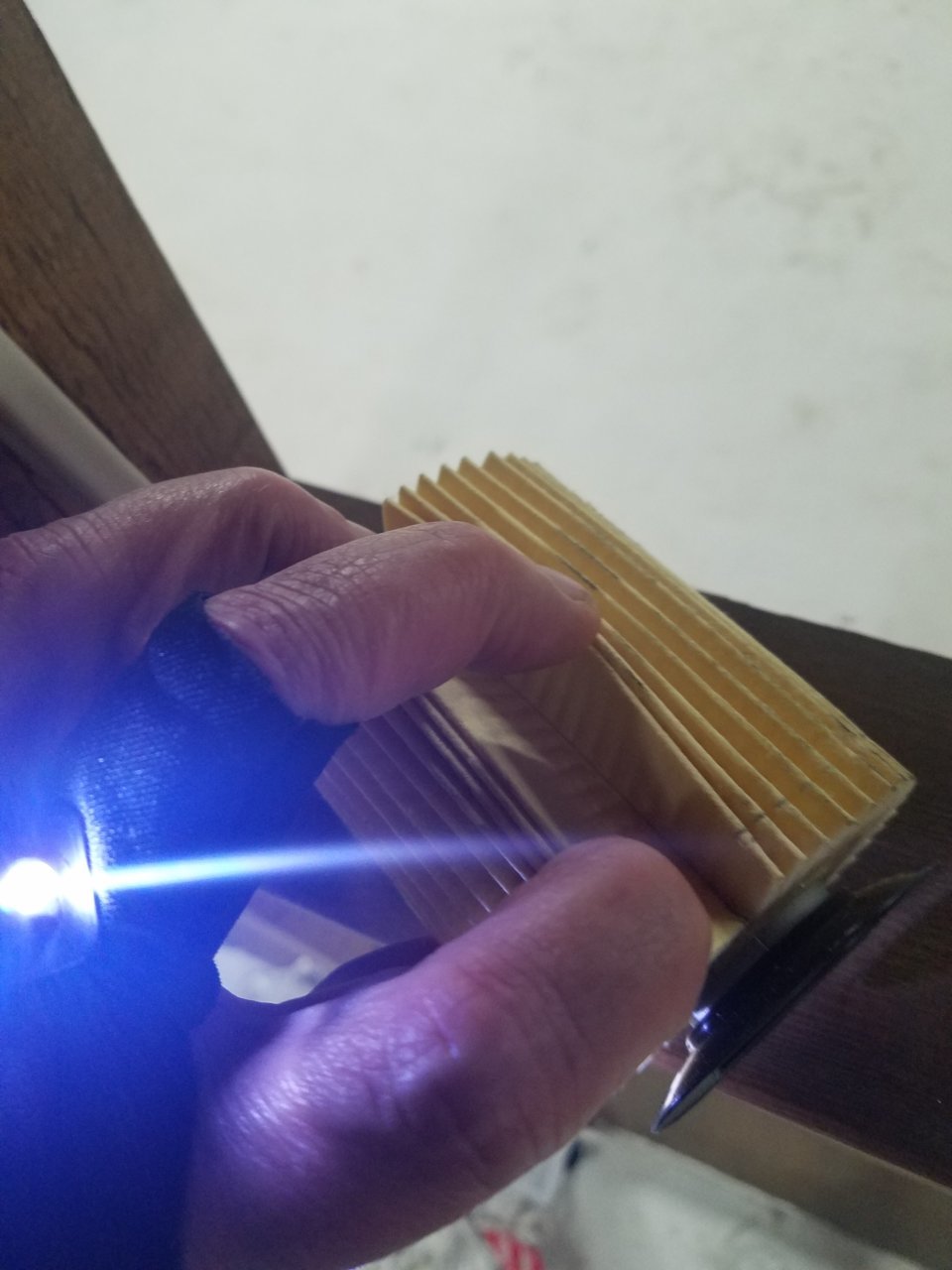

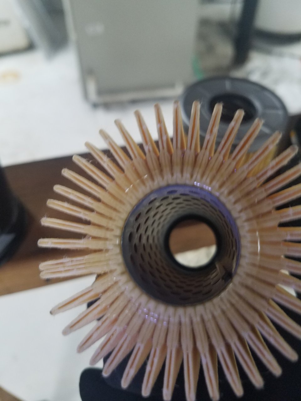

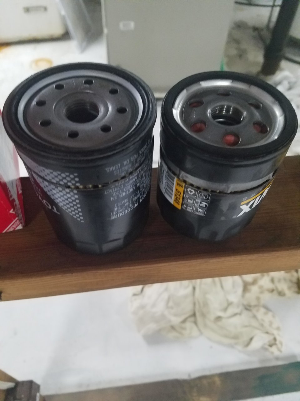

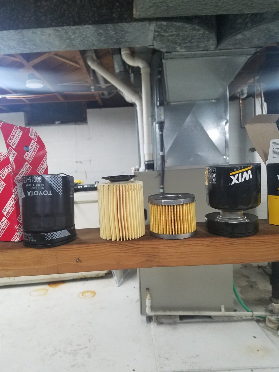

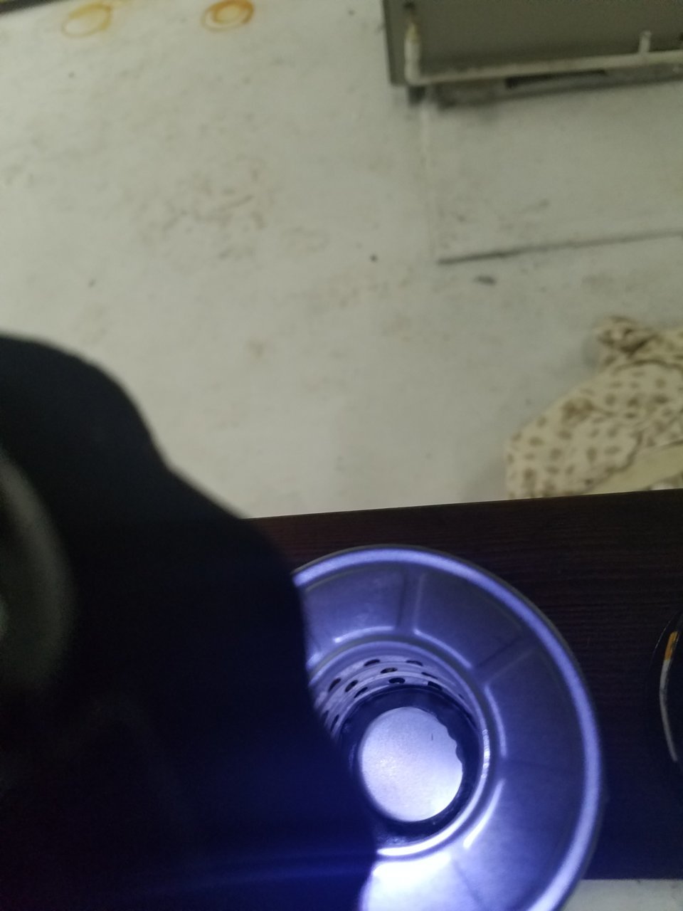

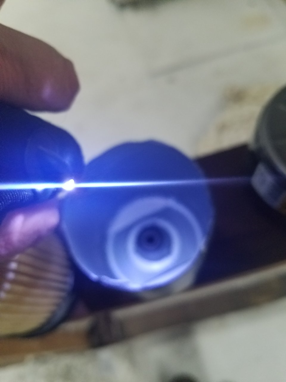

    Ok fine ask n recieve. I wont comment.
    Enjoy the photo bomb
    20181213_203218.jpg 20181213_203229.jpg 20181213_203241.jpg 20181213_203243.jpg 20181213_203249.jpg 20181213_203325.jpg 20181213_203351.jpg 20181213_203335.jpg 20181213_203356.jpg 20181213_203414.jpg 20181213_203423.jpg 20181213_203426.jpg 20181213_203432.jpg 20181213_203436.jpg 20181213_203444.jpg 20181213_203510.jpg 20181213_203525.jpg 20181213_203535.jpg 20181213_203621.jpg 20181213_203640.jpg 20181213_203701.jpg 20181213_203711.jpg
    If you want more or have questions just ask

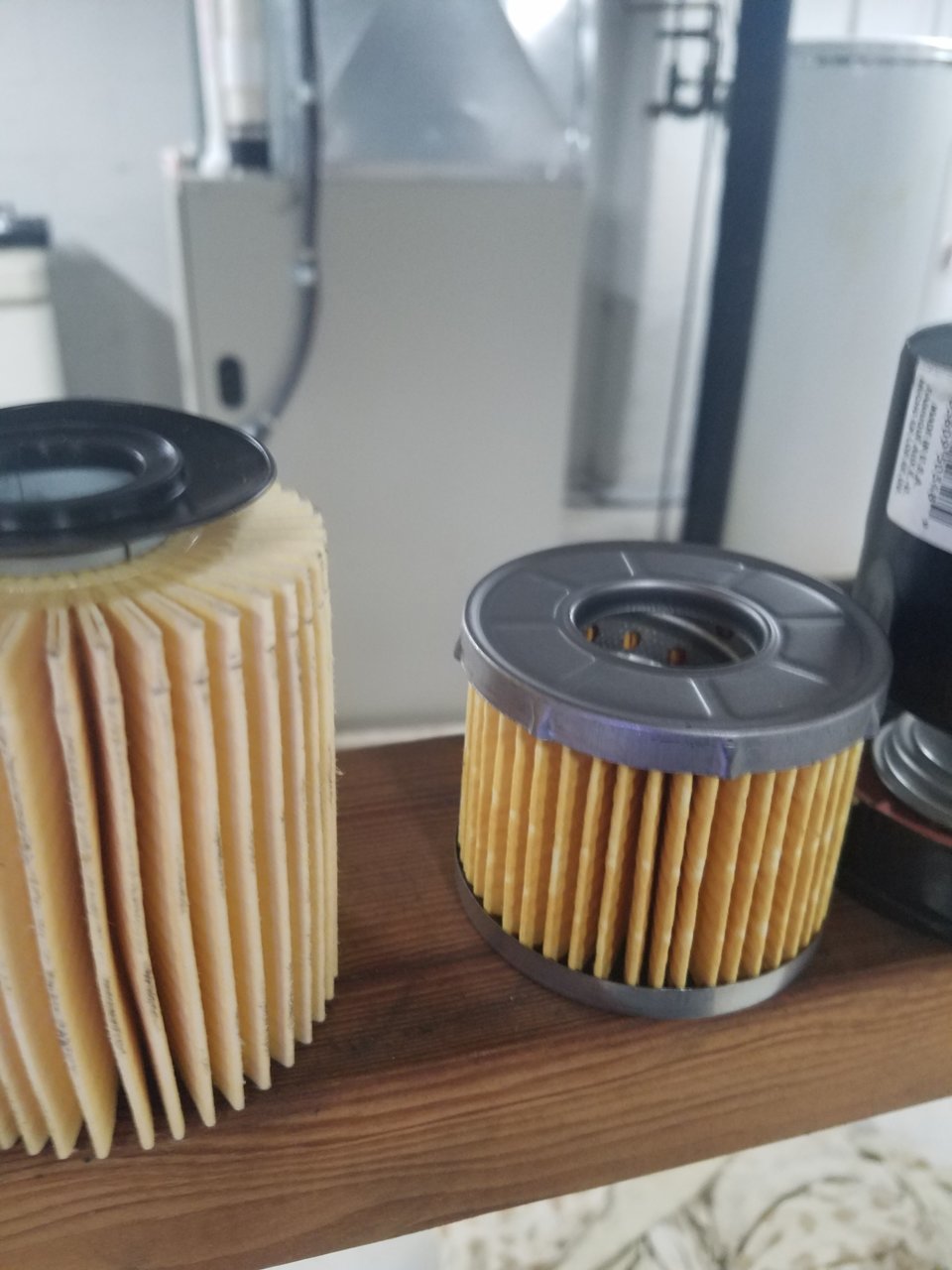

    Looks like the Toyota one has 2x as much filter material.

    I was thinging the same thing but could be different applications. Also filter media only tells half the story. Not having my hands on the material I will tell ya there is a difference in some of the elements within filters. Looks like toyota doesn't use a bypass valve system which can be concerning.
    Is that wix filter the same application as the toyota?

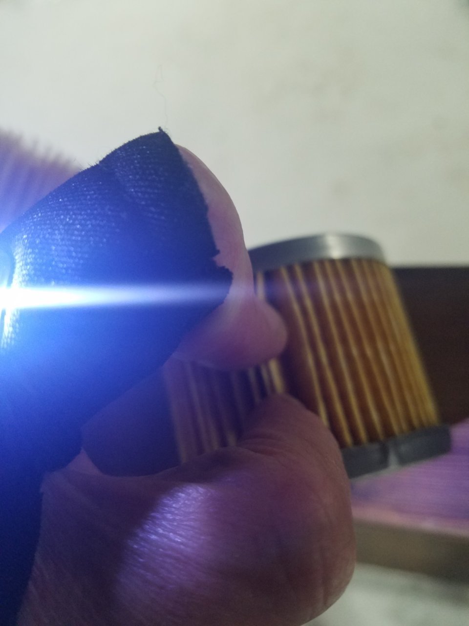

    Yes booth fot the toyota. And yes the toyota has a longer material, half the pleats and you can see through the material. The filter bottom is what concerns me the most. Wonder how much goes through without being filtered.

    Does height/length of the filter matter? It's interesting that Toyota has a longer filter but that half of it isn't filled with filter material. I guess height/length doesn't matter if it isn't filled with anything.

    Seen alot of filter like that. Big can. Its the media and valving that makes the filter.
