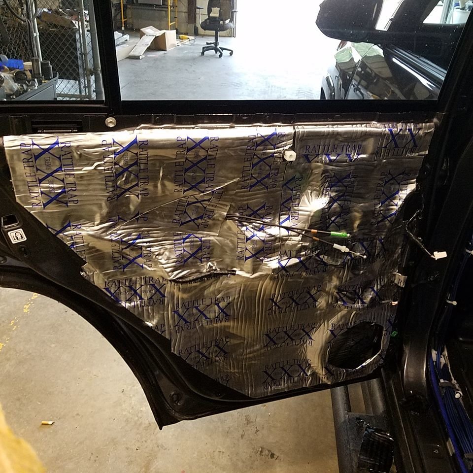

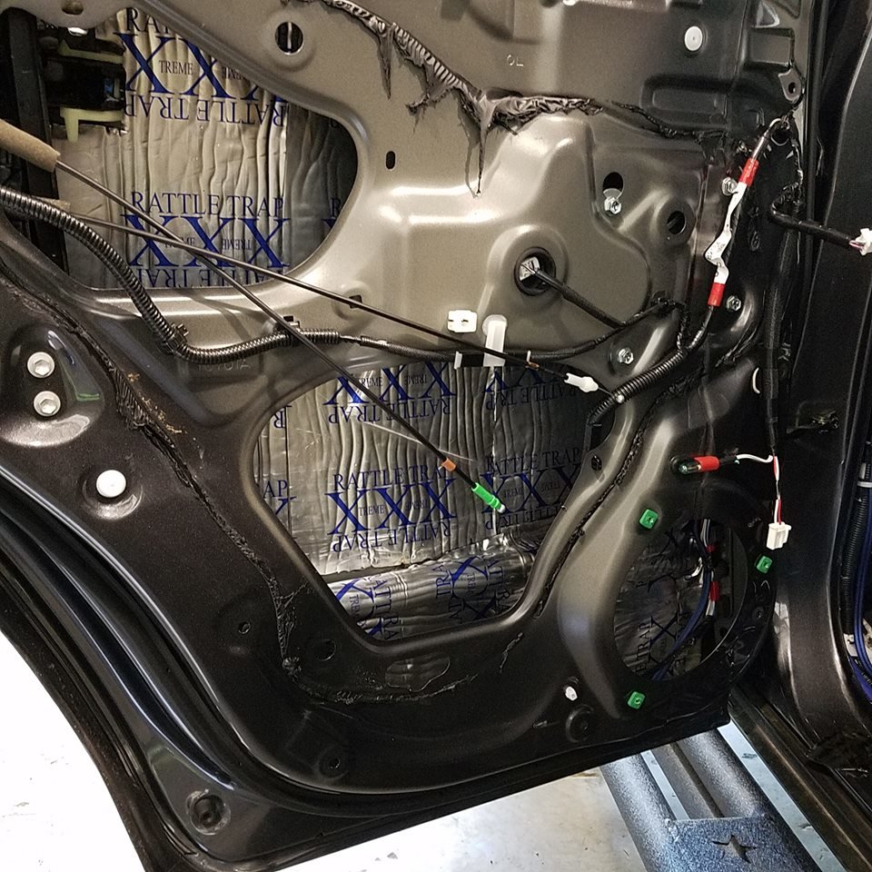

    For sound deadening, see pictures below. You do not want to leave those huge holes in the doors. That actually hurts sound quality. Deaden the inner door skin and the outer door skin. These are the door on my 4Runner.

    Good to know. I've got plenty of the sound deadening material leftover so will probably fill those areas in. :thumbsup: Any tips for getting that tar-like glue off (that holds the plastic sheet) in the summer heat?

    No reason to remove it. Stick the sound deadening right over it.

    Even better! I hate that stuff.

    Personally I wouldn't put sound deadening over those holes. What happens when you need to replace the window motor or the regulator? I commented on your video about keeping the plastic that went there it is a moisture barrier.
    With the speakers you have you'll be good with just doing some of the inner skin. Stinger fast rings or similar will help a ton at directing the music into the cabin. If you really want to cover those holes get some 1/8" abs cut it to the shape drill some holes in the abs and the door and put some threadcerts in the door so the panel can be removable. Just put some foam on it where it touches the door so it doesn't rattle and will seal up.
    You need to go and watch Car audio fab and 5star car audio before you get too carried away with the sound deadener.
