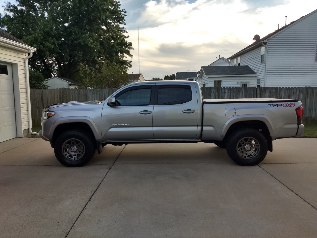

    IMG_20181009_181855269_HDR.jpg IMG_20181009_175650950_HDR.jpg I rode in one with 885 and Bilstein set on the lowest setting and a leaf in the rear. It rode great. I was on the fence about what to do and the off road shop assured me that the stock coils and a one inch block would be fine. Guess what he was right. Mine rides awesome, floats like a Cady and soaks up bumps, allignment was dead perfect, no issues at all. PM me and I will give you the info and you can call them. I very content with my decision. Also we achieved about the same amount of lift and we both used the same wheels and tires are size.
