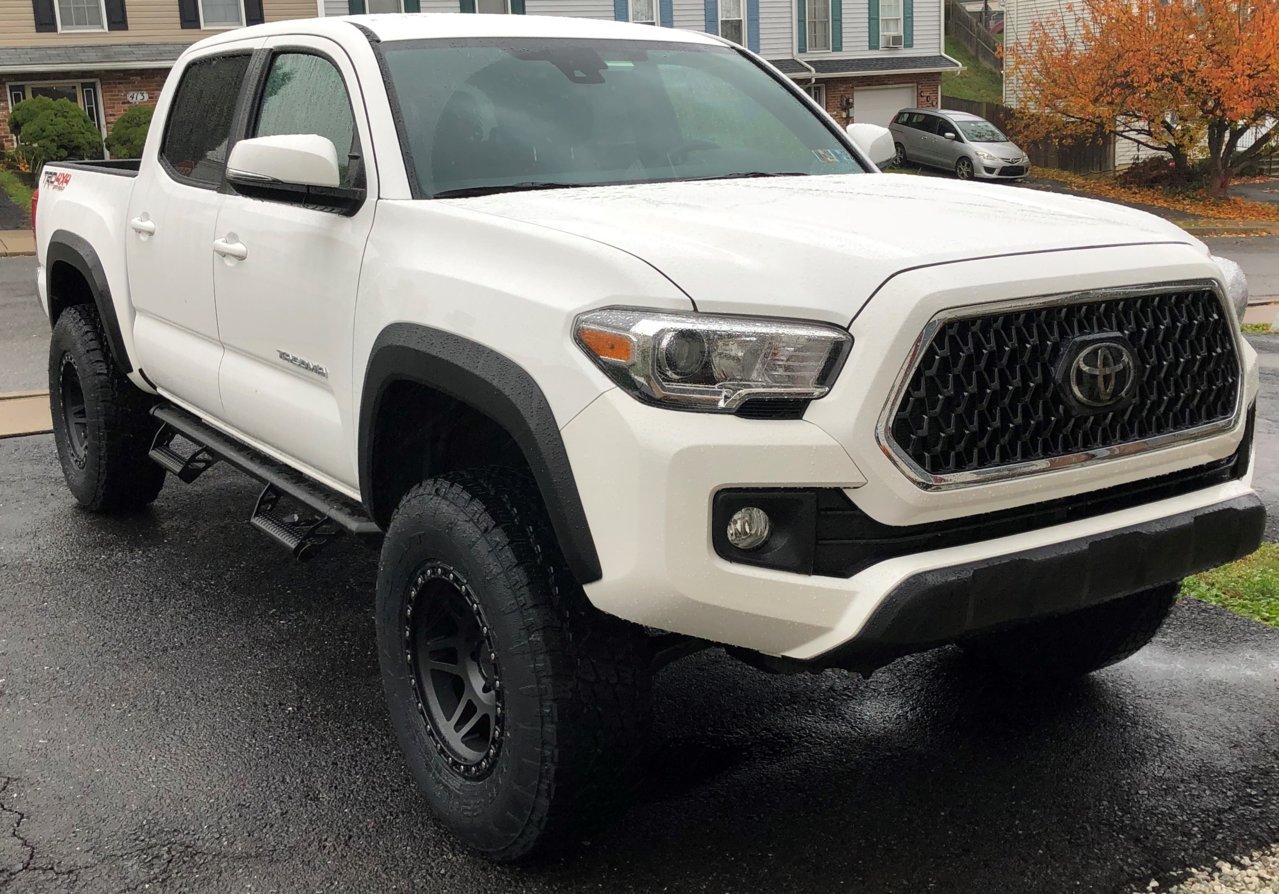

    ProComp 3/1 Nitro Level Kit Diff Drop Spacer 17x9 Method 312 -12 Offset 285/70/17 Nitto Terra Grappler G2
    I have the Pro Comp 3" Nitro Level Lift kit (1" rear block). I also had this same kit on a 2016 SR5 which required me to do the needle bearing swap with the bushing. So far my 2018 OR doesnt have the needle bearing vibration but does have an annoying decel vibration and highway speed (65 mph) vibration. I'm being told its my pinion angle but this isnt supposed to be a problem when only using a 1" block. So now I am chasing the vib and trying to figure out how to correct it. Other then that Ive had no problem with the lift kit. I kind of wish I went with the Low Range Off Road level kit though. They mill a 1 degree taper in the block to correct pinion angle. The pro comp block is flat. Hope this helps
