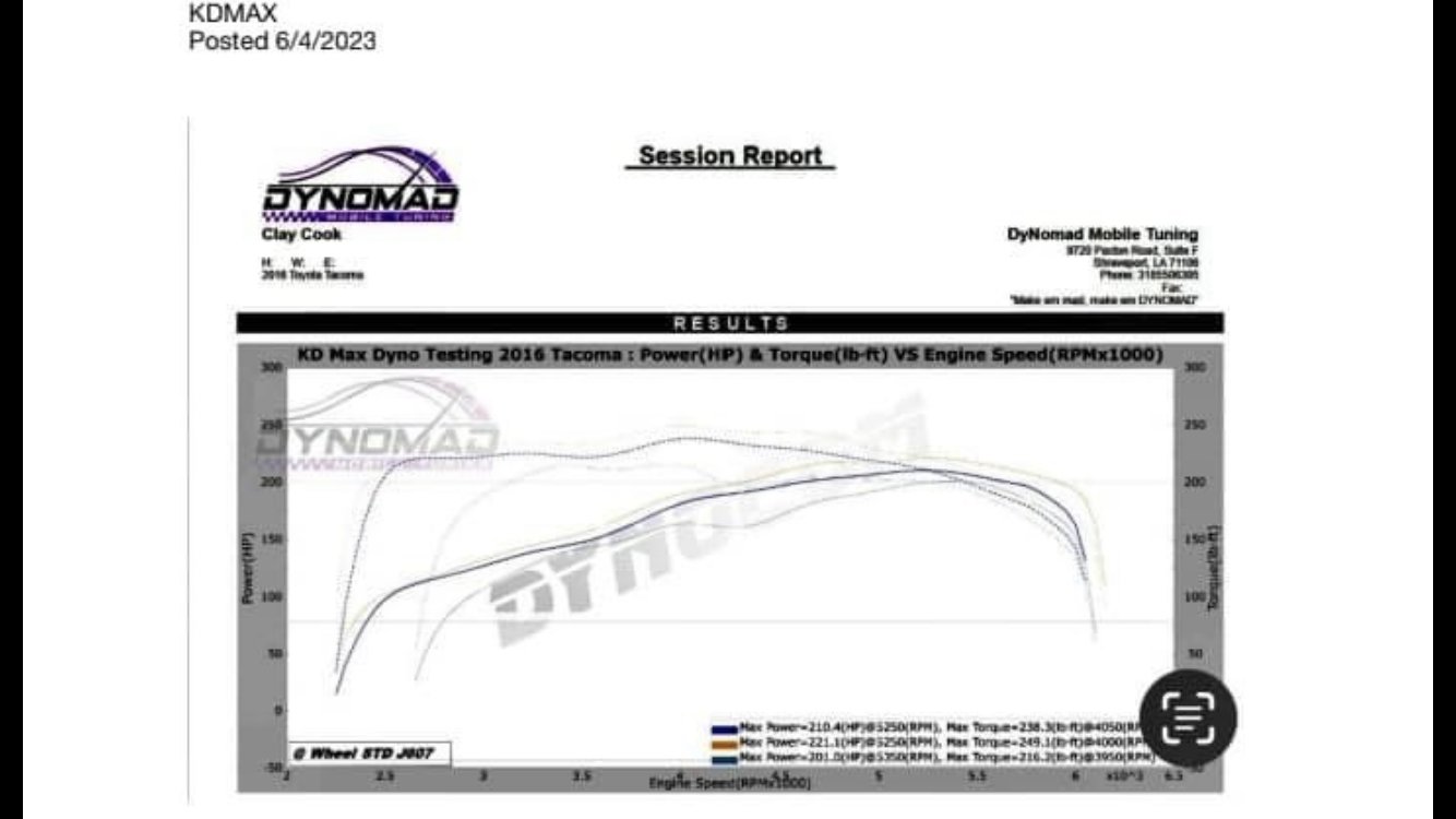

    I printed out the dyno test results of the 3 major tunes shown in the "Truth be told" graph and from an engineer's point of view the OTT tune provides on the average of 10-13 ft-lbs of torque increase over the stock tune. In the 3K - 3.5K range (which is where I tow the trailer at on a good day) OTT and stock are both the same ft-lbs of torque.
    It seems the bottom line is, will the $325 for the OTT tune pack be worth it to have that small increase in torque outside of the 3K-3.5K rpm range as well as the improvements in shifting points and throttle response????
    Too bad OTT doesn't offer a try before you buy option (like one of its competitors has) so we can buy with confidence knowing if the tune is not performing as hoped we can get a refund.

    Will a tune help with shifting? Yes. However as others have mentioned it'll still be a 1/4 ton truck. Getting tuned made a big difference but it doesn't turn the truck into a V8 per say.
    Also even tuned you want to be using ECT. Depending how often and how committed you are to towing a special "tow tune" can also be provided for you.
    Reach out to your local tuner and see if they'll let you try it out. Maybe even have the trailer dropped on the hitch for the test drive.
    Also if you're curious this is an actual dyno run of our tune, it's also posted on our page in the performance section of the forum. We do our dyno runs in 4th (1:1 gear)
