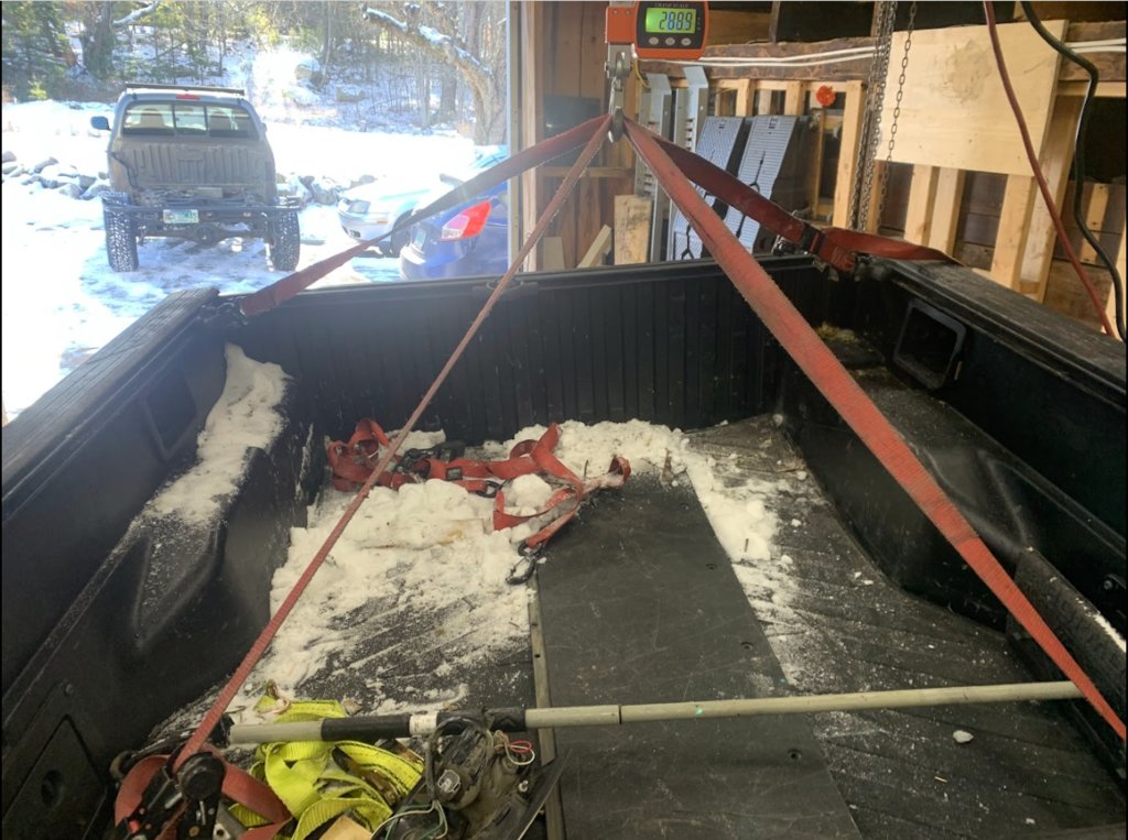

    I am in the process of designing one too and that is going to be real heavy. I actually decided to go with c channel for a few reasons.
    • For the comparable strength c channel can be slightly lighter with a thicker wall thickness(making welding easier)
    • You can coat 100% of c channel easily for corrosion issues
    • Its typically the way steel flatbeds/trailers are made in industry
    24 FT of 3x3x11 ga is 114 lbs alone

    According to the google 07 DCLB has a payload of 1350, but check your door sticker. My cut up short bed weighed 288 with my typical bed junk, taillights, and tailgate. You will also be taking off the stockbumper (33 lbs) and hitch (50 lbs).
    You have lets say 380 lbs to spend before you start eating into your OEM payload.
