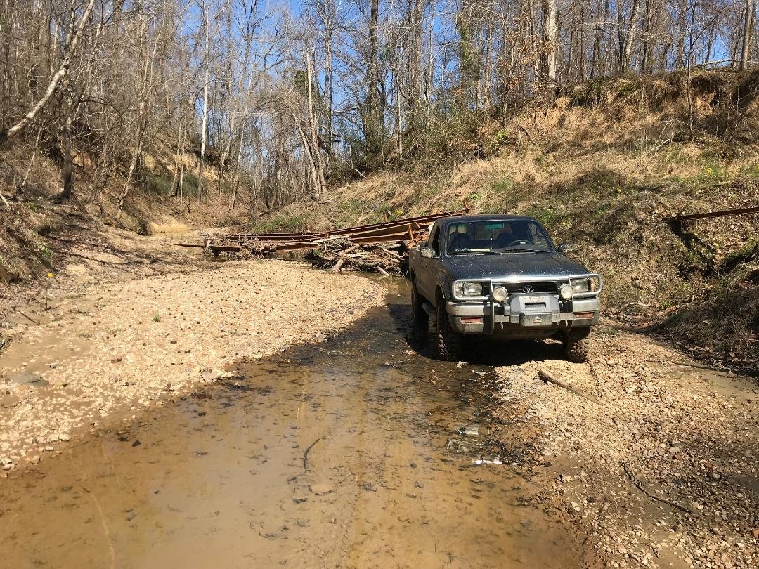

    I appreciate the feedback. Having a posi/locker in the front would give me a bit of extra capability. I rarely get stuck but recently stuck the Taco really well in a creek bed while scrounging gravel. Once you step off the gravel bars, you will high center in the blue clay if the tires spin much at all. It only took a few minutes to winch out. But having a posi/locker in the front would have been of value to me. If I am going to get a posi/locker, the perfect time to do it is while the bearings are getting changed out.

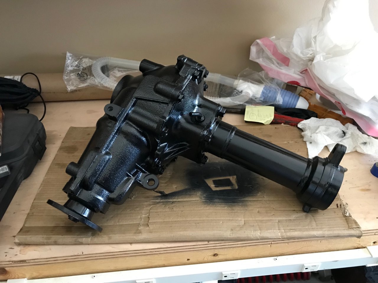

    I narrowed it down to either a Spartan locker or Detroit True Trac limited slip. ECGS stated that if what I needed was more traction in the deep mud/high water I routinely wheel thru, then definitely go with a locker. And they thought the Spartan was a better choice than the PowerTrax Lockright for my application. They built a 7.5" clamshell front diff. with solid spacer/CV bushing/Spartan locker. Just finished hanging it on the front end in a set of front diff. mount bracket bushings from DuroBumps. Will start installing the LCAs with the Strongflex bushings after a quick break.
    ECGS 7.5" Clamshell Front Diff. with axle tube reinstalled:

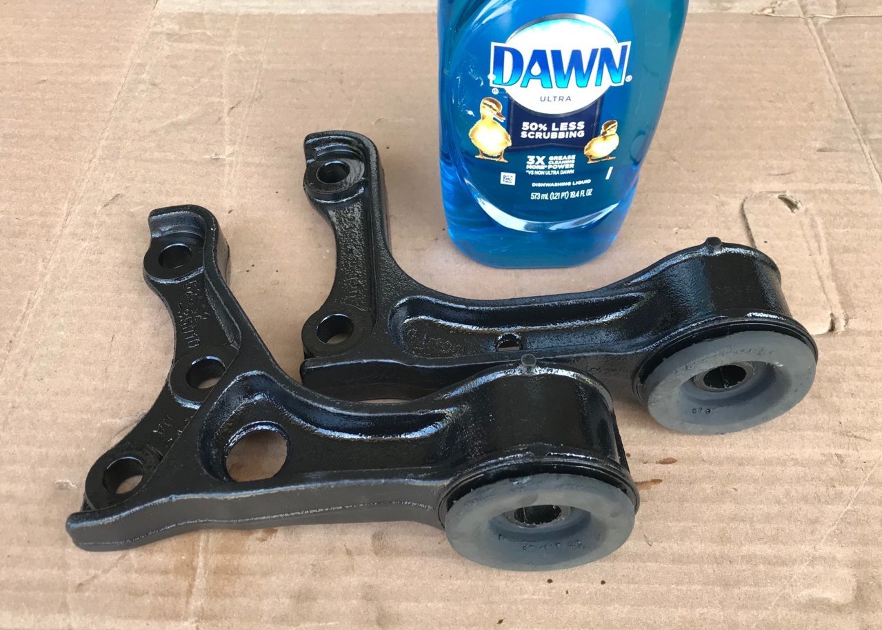

    DuroBumps front diff mount bushings installed in hanger brackets: I used lots of even heat to get the old bushings out intact. The brackets were cleaned and repainted. Then with plenty of Dawn used as a lubricant, the new bushings easily pressed in by hand.
