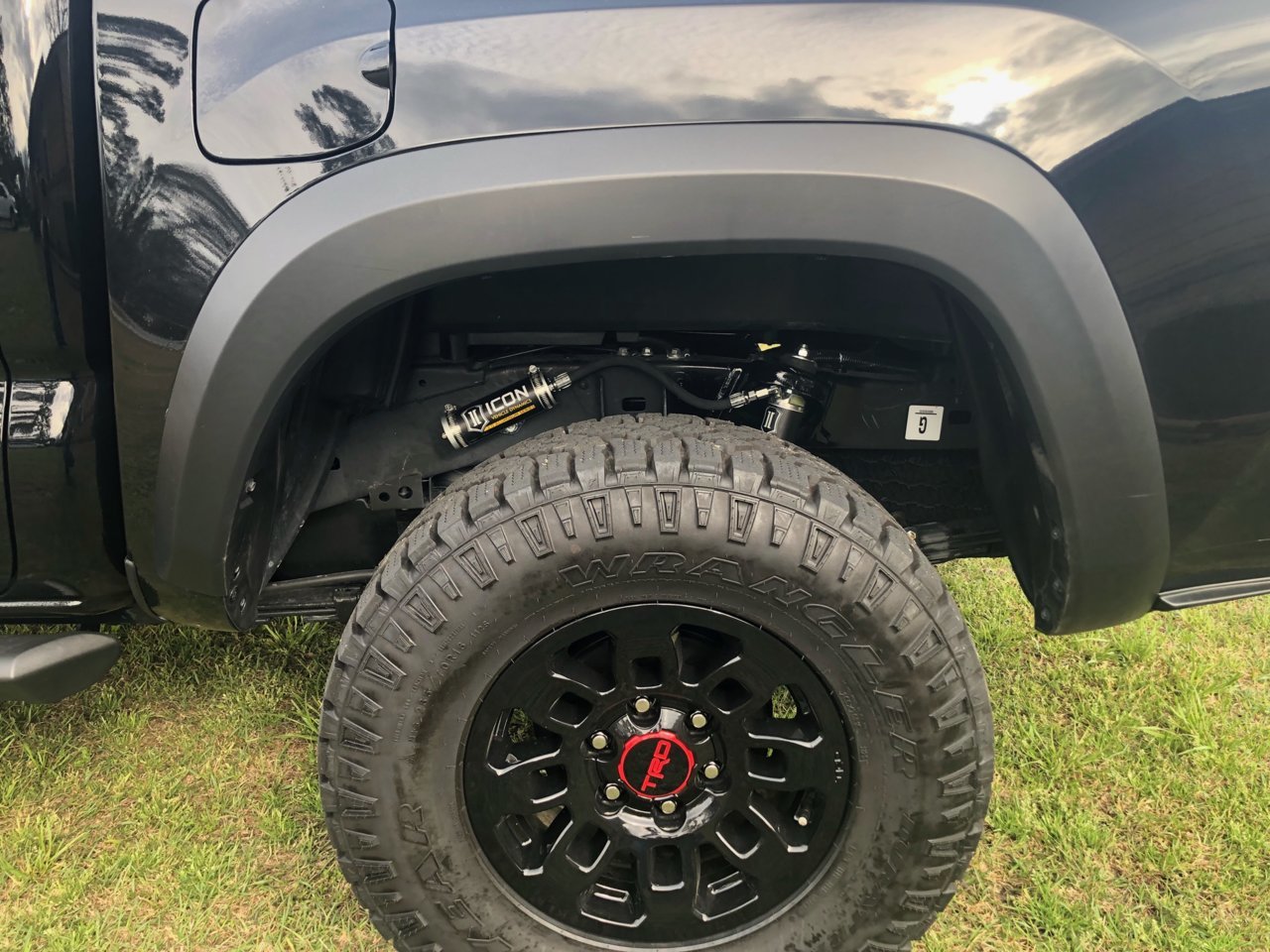

    I did a small lift and I am completely happy. I went with the Icon stage 2 lift and I am only about 2 inches higher than stock. The truck handles perfectly and I can load the bed a little bit heavier without sagging. I didn't want to go big as I didn't need to. No regrets. It rides great, serves my purposes and looks cool in my opinion.
    xcentrk, j-utah and Gear Jamin Jamie like this.

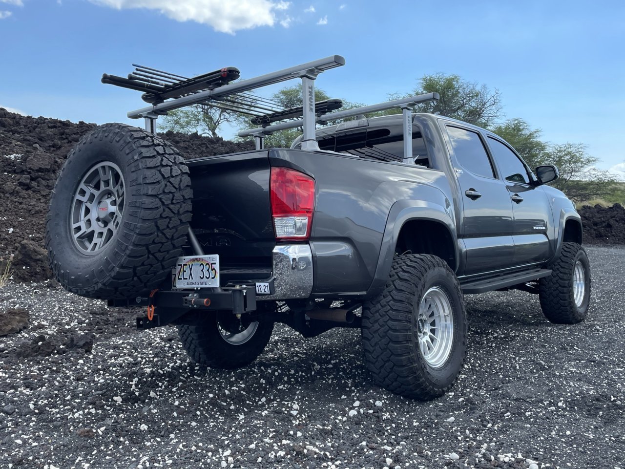

    What are you using for the spare?
    Nice truck!

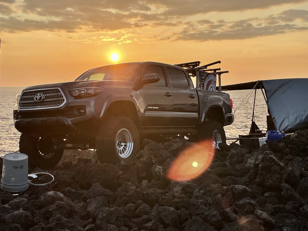

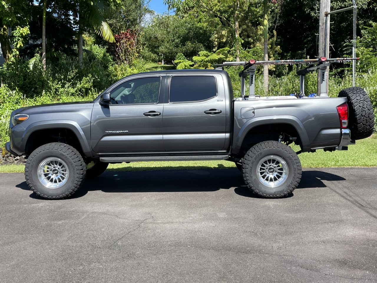

    Pro Comp 6", full length 5100's with OME 888 w/ taco lean spacer, 5160s w/ Alcan custom pack, HS extended brake lines, Summit offroad Dakar 17x9, 315/70/17 Falken Wildpeak MT, Nitro 4.88 regear
    thank you
    is this in regards to the carrier setup? Or the spare itself?
    Carrier setup is from Rigd (shipping was unreal to Hawaii holy crap)
    Spare itself is a TRD trail wrapped in a Firestone 35

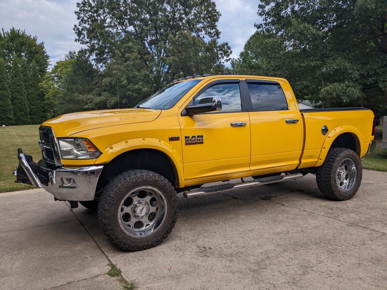

    Here's an extreme example for you. This is my current vehicle:
    A RAM 2500 with a ridiculous 9" lift and 37's. Trading it in for a TRD OffRoad 4x4 and will be keeping the Tacoma bone stock. The lift was fun and head-turning, but I'm over it. My needs have changed and will be happy to drive the Tacoma with its original factory geometry as the designers intended.

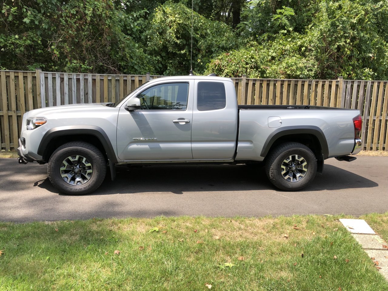

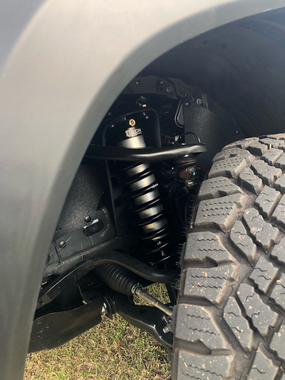

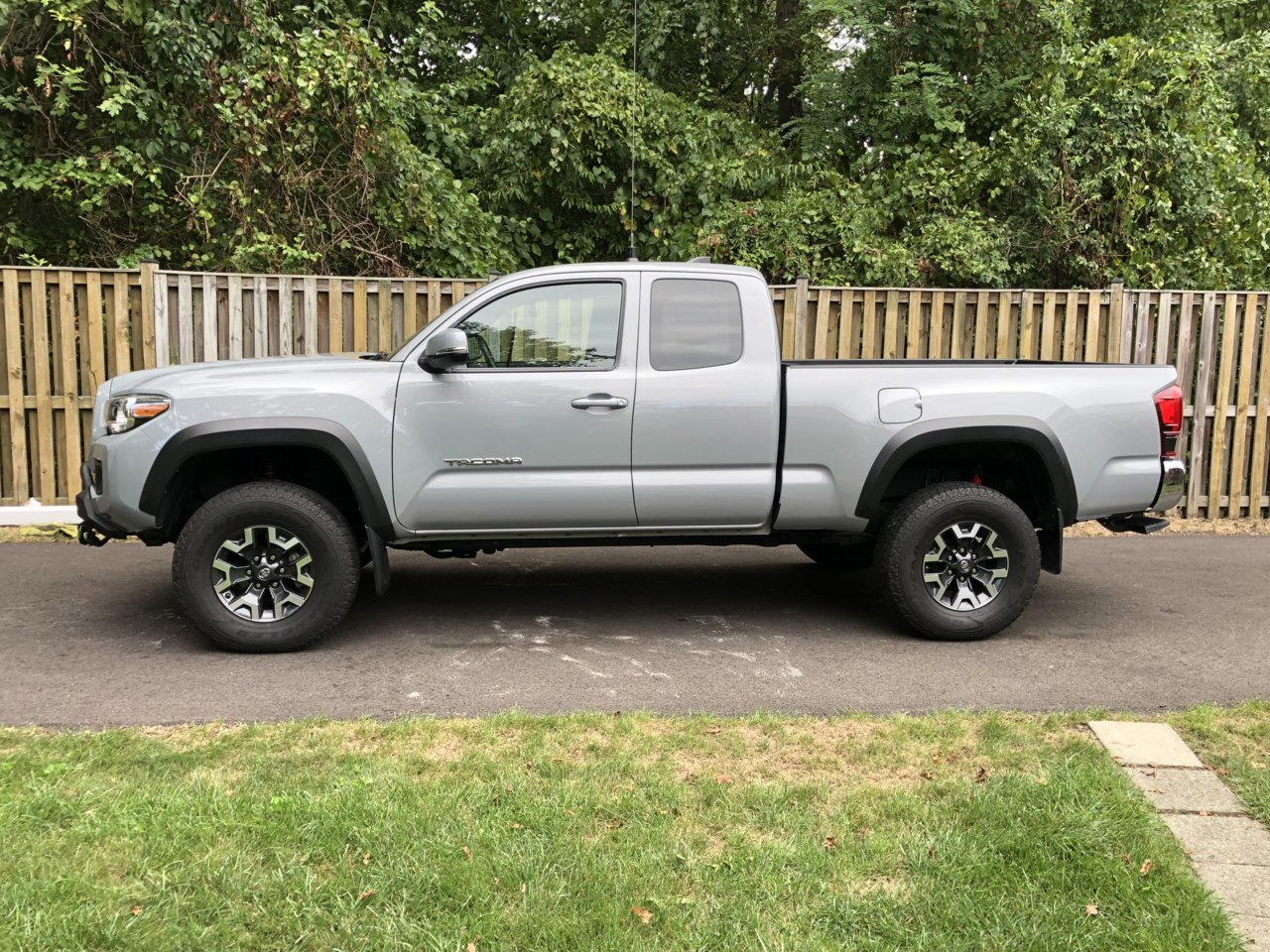

    Installed the OEM 2" lift myself with an add a leaf. Had too, the winch and bumper I installed on the front initially dropped the front end 1/2". Truck rides well and looks good.
    Before:
    After:
