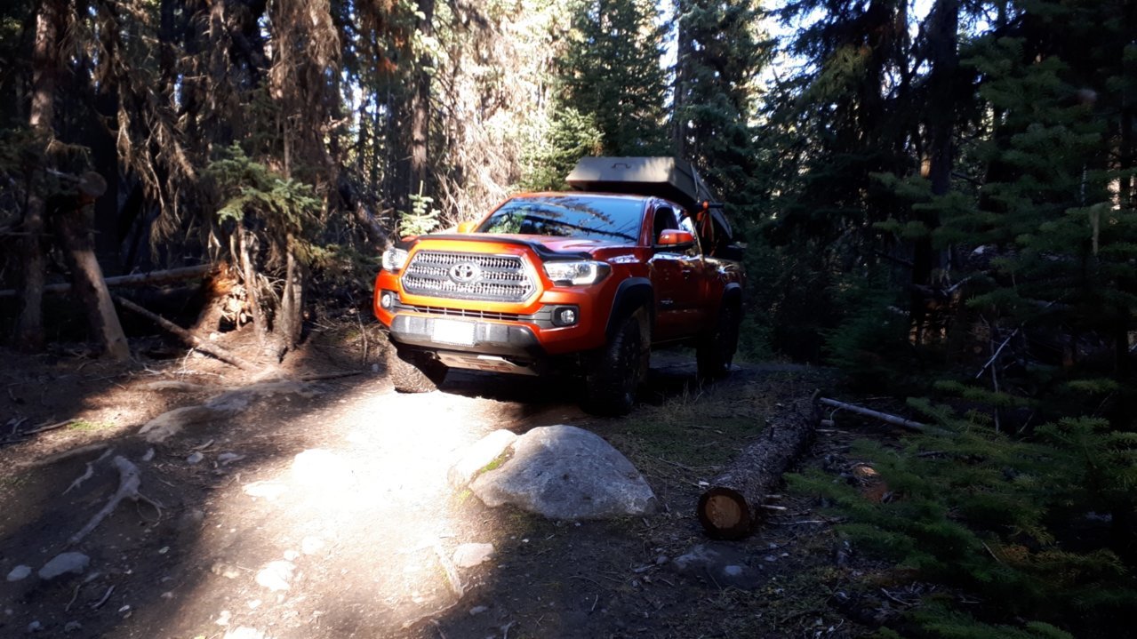

    Just added toolbox and roof-rack to haul my fishing boat 100's of miles into the backwoods every week. Goodrich K02s, Bilstein 5100 front and back, no lift.
    My 2016 TRD OR is my 4th 4x4 in the past 37 years. Two older Fords and a Mazda, all great trucks for off road.
    My only mods are the Pro skid plate (original was destroyed on trails), Bilstein 5100 (not lifted) and 265 75 16 BFG KO2. I did not like the bouncy off road ride with the stock shocks, and I need 10 ply tires for the terrain here.
    Blowing a 4 ply tire on every trip is not my idea of fun. That is an almost sure thing on the trails I drive. Thousands of large sharp rocks on most trips. The Pro skid plate has a lot of grooves in it, but no holes like the stock one suffered.
    I blew 2 of the stock Kevlar Wranglers on my first outing with my Taco, and both on the same day. Since that time, I have over 130 trips on the KO2s (my second set now) and no flats. That reliability is a great thing as I am solo remote on every trip. If I was not off road, I would stick with a 4 ply tire for comfort.
    None of my past 4x4's have been lifted. I am a fisherman and a hunter. All my trucks were used extensively off road. My Tacoma is off road twice per week from April to November.
    Here in BC, I drive terrible rutted deep pothole and washboard deactivated forest service roads before I even get to the 4x4 trails. I hate those roads. They are so punishing, slamming into deep potholes and brutal hopping on washboard. Like riding a bucking bull every trip but for hours and not just seconds.
    Now the 4x4 roads are a pleasure to drive. Into 4-lo 1st gear and just crawl over some obstacles. None of that hammering like the FSRs.
    Every trip I need 4x4 traction for mudholes, deep washouts, steep and loose rocky inclines, etc.
    If you often drive terrain that requires a lift, then get one. Makes sense and a simple decision in that case. If it is for looks only but that makes you happy, go for it. Life is too short to be concerned about others BS. Sometimes my own BS concerns me, but that's a different topic...
    So I am driving a lot of trails like in this pic. Truck width with no pullouts so you have to go over everything, but the stock ride height is still sufficient for me. It rides hard with the KO2's and the stiffer Bilstein 5100, but that works for the 4x4 trails. A softer 4 ply tire would be better for the washboard and pothole roads, but no good for the 4x4 trails to access my fishing lakes. A lot of sidewall rubbing on large rocks and the KO2s hold up well to that.

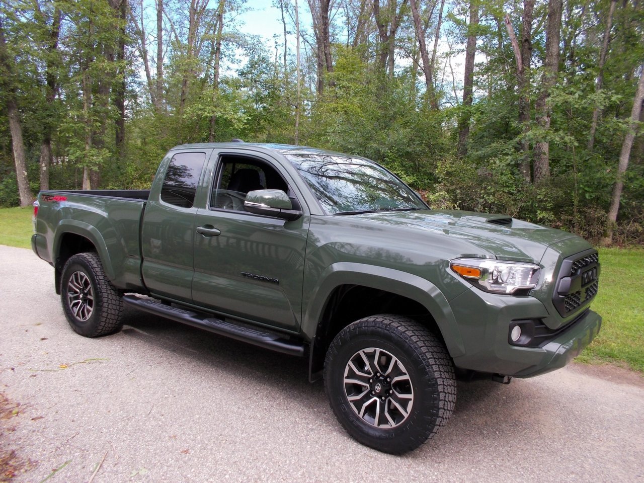

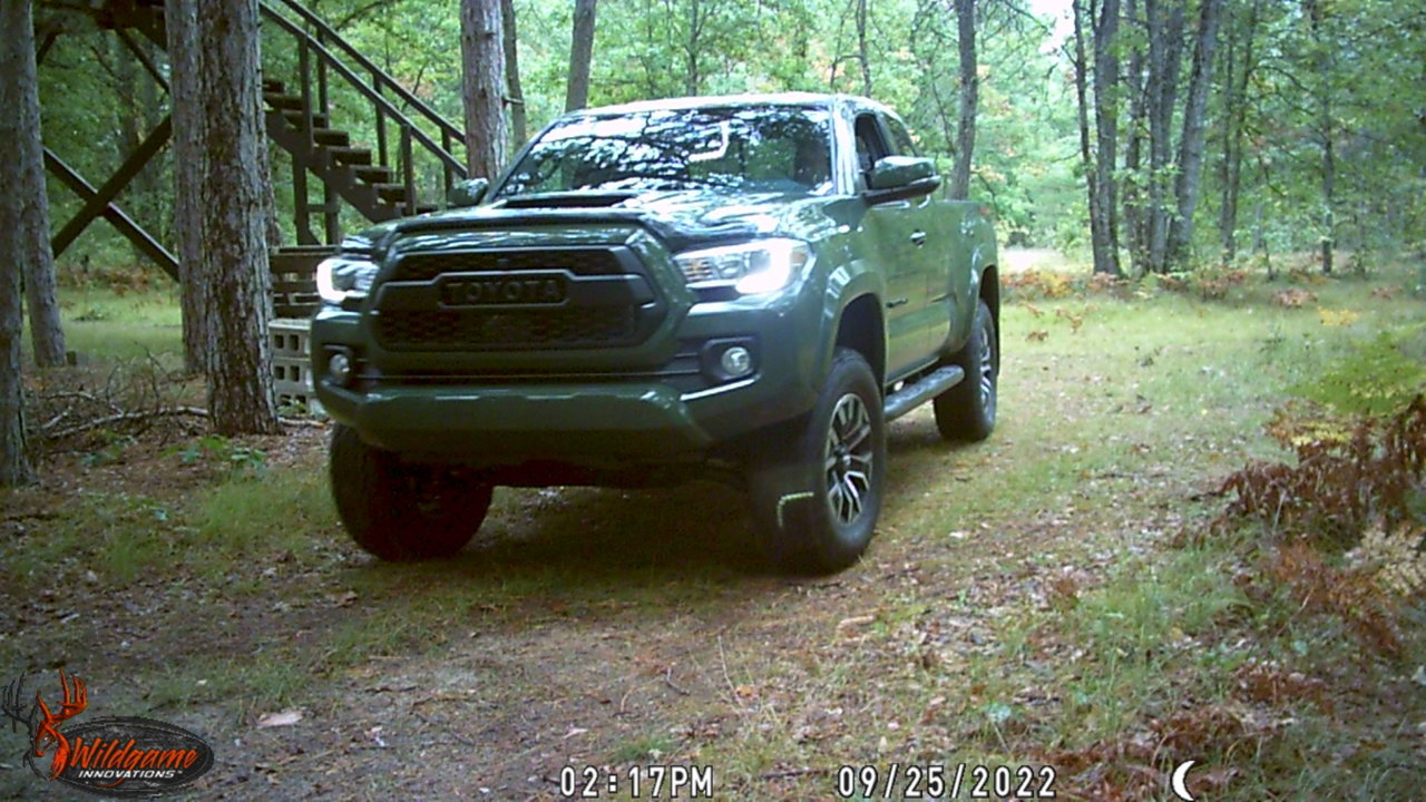

    22 TRD Sport I had the dealer do the TRD lift kit and one size taller nitto terra G2 tires, so I went from 265/65/R17 to 265/70/R17. I'm super happy with the way it looks and the way it drives,
