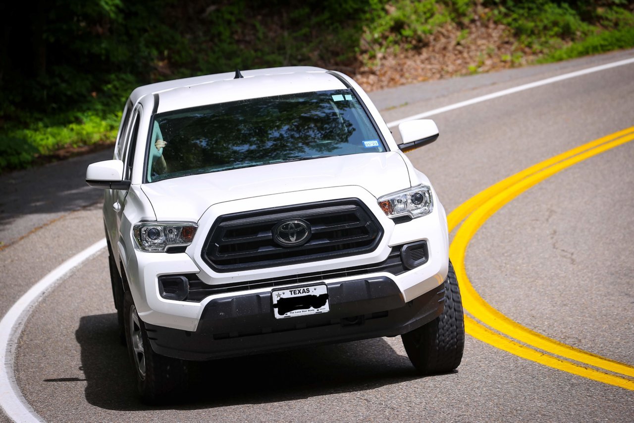

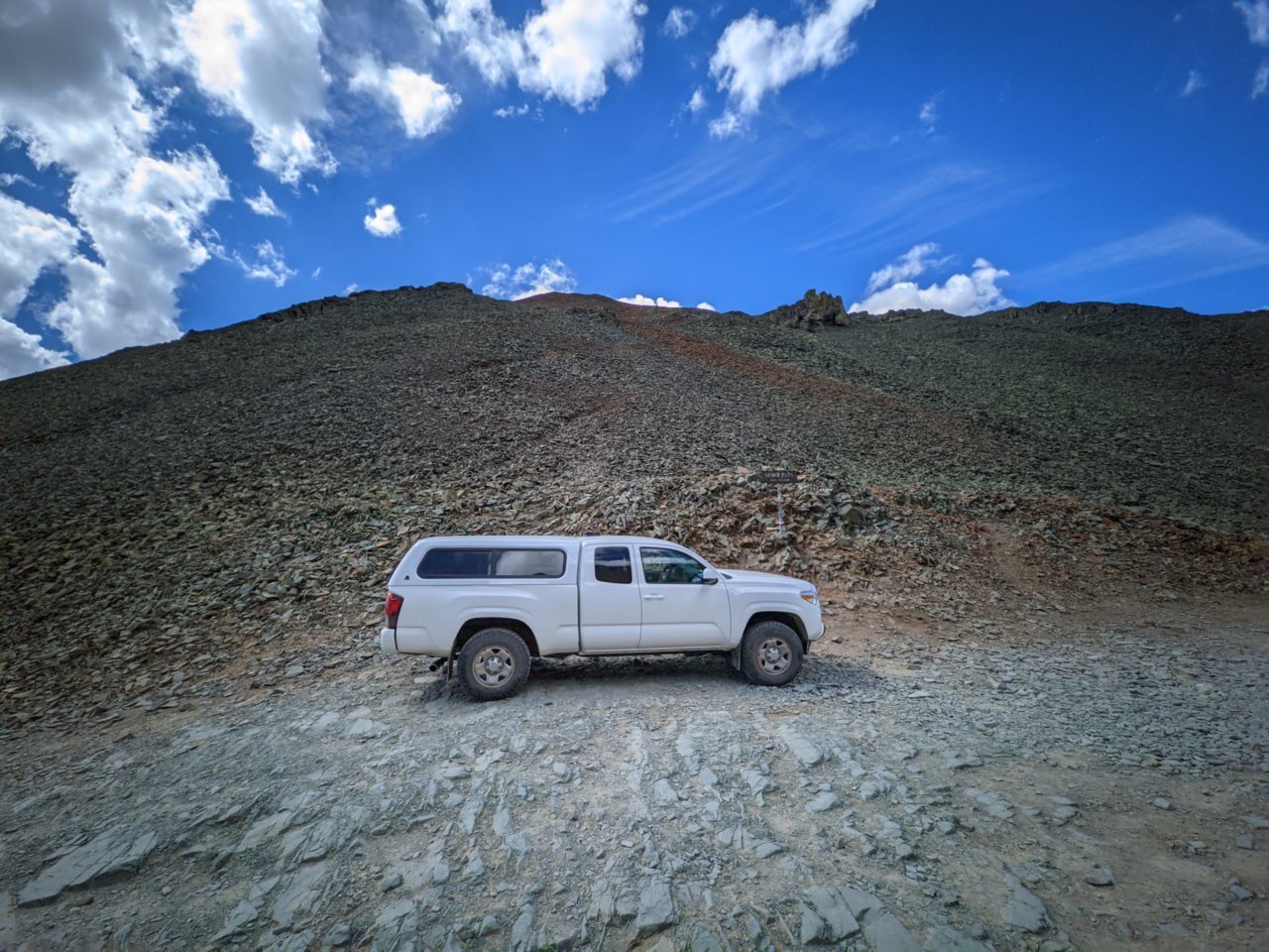

    I have a 4-cyl/4WD SR - I put E-load AT tires on it in the stock size (Firestone Destination X/T which weigh 39 lbs in 245/75-16) and it did everything I asked out in Colorado without even breaking a sweat. Medano Pass, Ophir Pass, lots of the trails around Ouray.
    I have a Leer camper shell (cab-hi, not a high top one) and went with the light-ish tires on the stock wheels and won't be lifting it because MPG is important to me. I lost about 1 MPG city/hwy with the AT tires compared to the stock car tires. It gets 25 MPG at 65 MPH which is great and equals a range of almost 500 miles/tank. Around town I get 20-22 MPG depending on traffic and A/C usage. The only thing I might do at some point is a helper spring or add-a-leaf because the rear sags a little when loaded down for a trip. It's not really an issue with clearance, but I don't like the slight bounce in the suspension it does when loaded and it causes the headlights to blind people on dark roads with the front angled up a little.
    I say just put some better tires on it first and then decide if you want to do anything else. I haven't broken anything, didn't scrape anything, didn't bottom out, I even still have the chin strap/air dam and only brushed it on a few things a couple of times. It is a little stiff/bumpy on rocky roads, but with the E-load tires you can air down to 20 and it really smooths it out. Really happy with this setup, it is great for long trips and camping. While it rides more firmly on pavement, it's nothing terrible (mostly due to the 45 PSI these require) and it has SO MUCH more cornering grip and just sticks instead of the OEM tires that would roll over onto the sidewalls and howl.
    This is at Tail of the Dragon, I couldn't believe how much more grip it had compared to the stock tires, it felt like putting stiff summer tires on a sporty car

  5. Oct 8, 2022 at 5:15 PM
    #65
    snowmatt1
    snowmatt1 [OP] Member
    Sep 12, 2022
    #405636
    12
    I take my Land Cruiser out there... especially when they used to have 100s in the Hills. Good stuff!
    I'm fine with that trade off. That's why I love my KO2s. Having a really solid tire is a game changer.
    adrew[QUOTED] likes this.

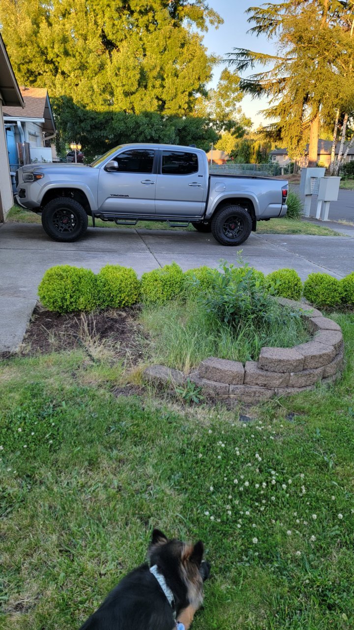

  10. Oct 9, 2022 at 9:10 PM
    #70
    Integerdy
    Integerdy Aspiring "SR5 Pro"
    Jul 31, 2021
    #372781
    867
    Eric
    So-Lame, Oregon
    21 SR5 Silver Sky DCSB

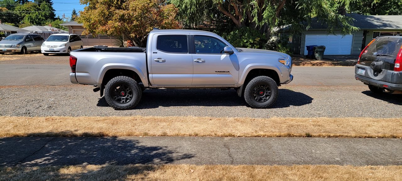

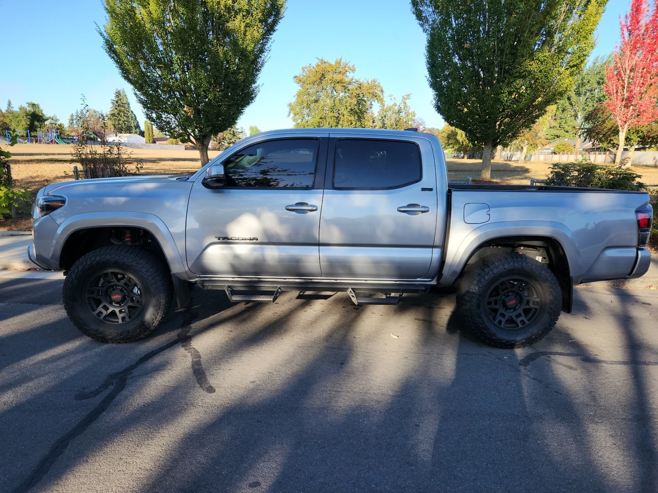

    I spent $2400 on the TRD Lift Kit in Salem, OR last year. That included the kit itself, the pro grille, the labor, the alignment and TSS recalibration
    Wheels $660 shipped, tires $1000. Most will say avoid a spacer lift. And I don't do any offroading so I can't give you any feedback in that department but as my daily driver I love the way my truck feels now. I still have never experienced any rub since it was installed last year. I use the OEM Mud flaps and I did not do any trimming, cutting, or heat gun.
  11. Oct 9, 2022 at 9:16 PM
    #71
    KevKev_22
    KevKev_22 Well-Known Member
    Oct 9, 2022
    #407674
    104
    2021 Tacoma TRD Sport
    Thanks for the info. $2400 seems way more reasonable.
    With that TRD lift kit your truck is sitting completely level now? Hard to tell in the picture because of the slope. Also, I would love to see any additional pictures you have of this.
  12. Oct 11, 2022 at 5:01 PM
    #72
    Integerdy
    Jul 31, 2021
    #372781
    867
    Eric
    So-Lame, Oregon
    Yes it's level.

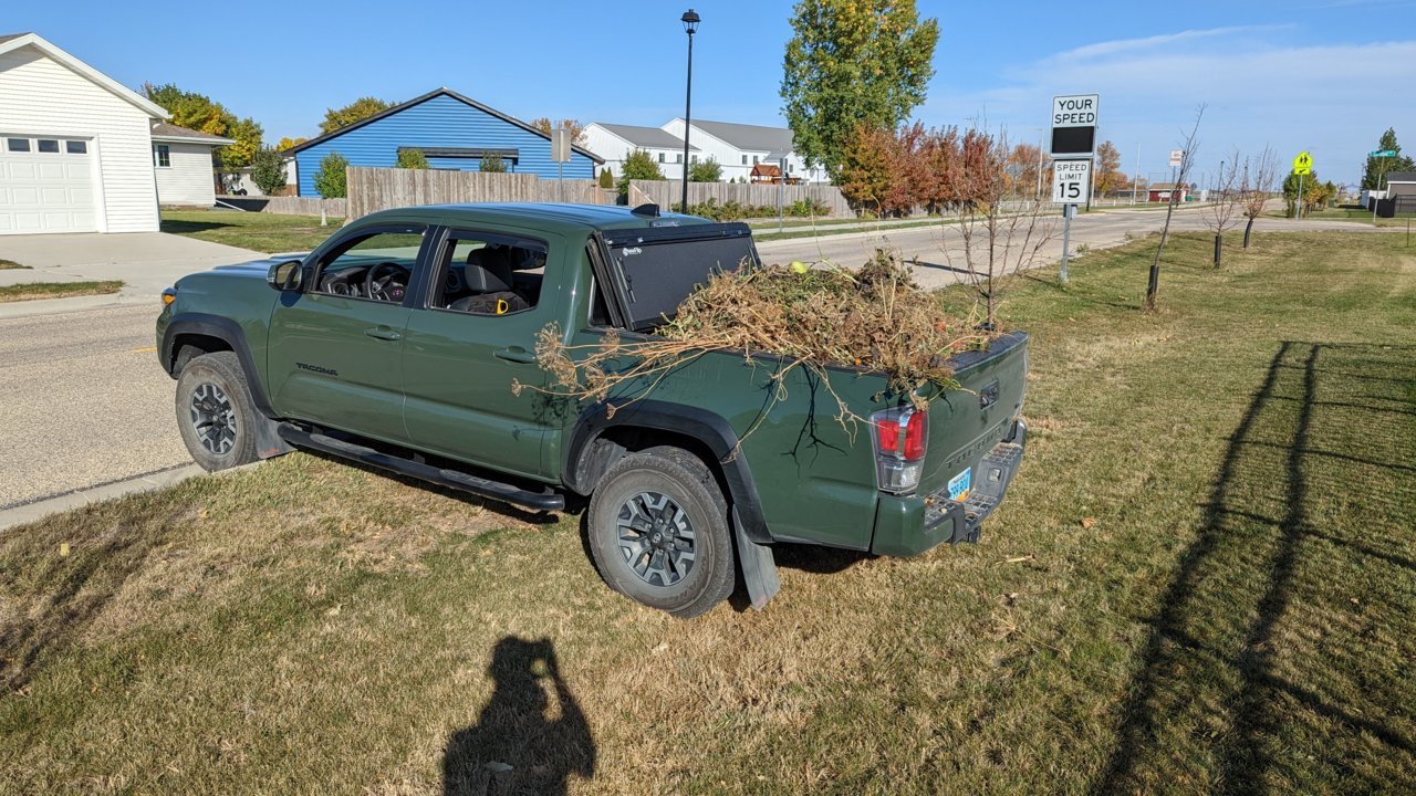

    21' OR DCSB AG 6MT
    All stock for now. Hopped this curb like a champ!

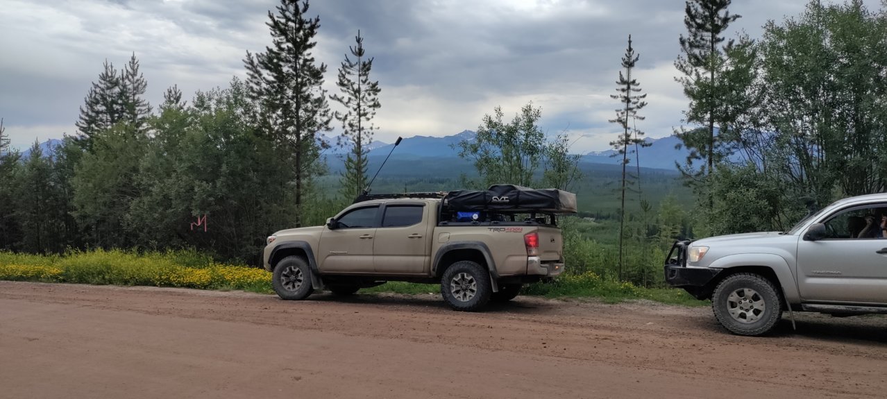

  18. Oct 31, 2022 at 11:32 AM
    #78
    joe.tak
    joe.tak It's not rocket science, it's just rescue.
    Jun 4, 2022
    #398761
    23
    Joseph
    Fraser Valley BC
    2018 DCLB SR5 Charcoal Grey
    How much can you comfortably carry with this setup? We have a similar kind of offroading; researching my options, hoping to get my truck into the shop in the next month. Thanks!
  19. Oct 31, 2022 at 3:21 PM
    #79
    MDFM31
    MDFM31 Well-Known Member
    Oct 15, 2010
    #44696
    1,237
    Chester Co, PA
    16 DCSBOR
    The suspension does great with significant weight and it will never sag because you can change your preload. In fact, the airbags are pretty uncomfortable without weight on them. I've had 750lbs of shingles in it and it felt fine. You will not have bump stops anymore though, and they bottom out very hard. It can be tough to find the right pressure to balance the ride quality and minimize the bottoming out.
    I don't think you will find the weight carrying limit of these bags on a Tacoma. I stay around 28-30psi with my full load out in my previously posted picture, which is getting real close to GVWR. They are able to go up to 100psi, as I recall.
    If you have a good idea what you payload will be, I'd consider getting the proper leaf springs. The air bags are good, but they have some particular drawbacks.
