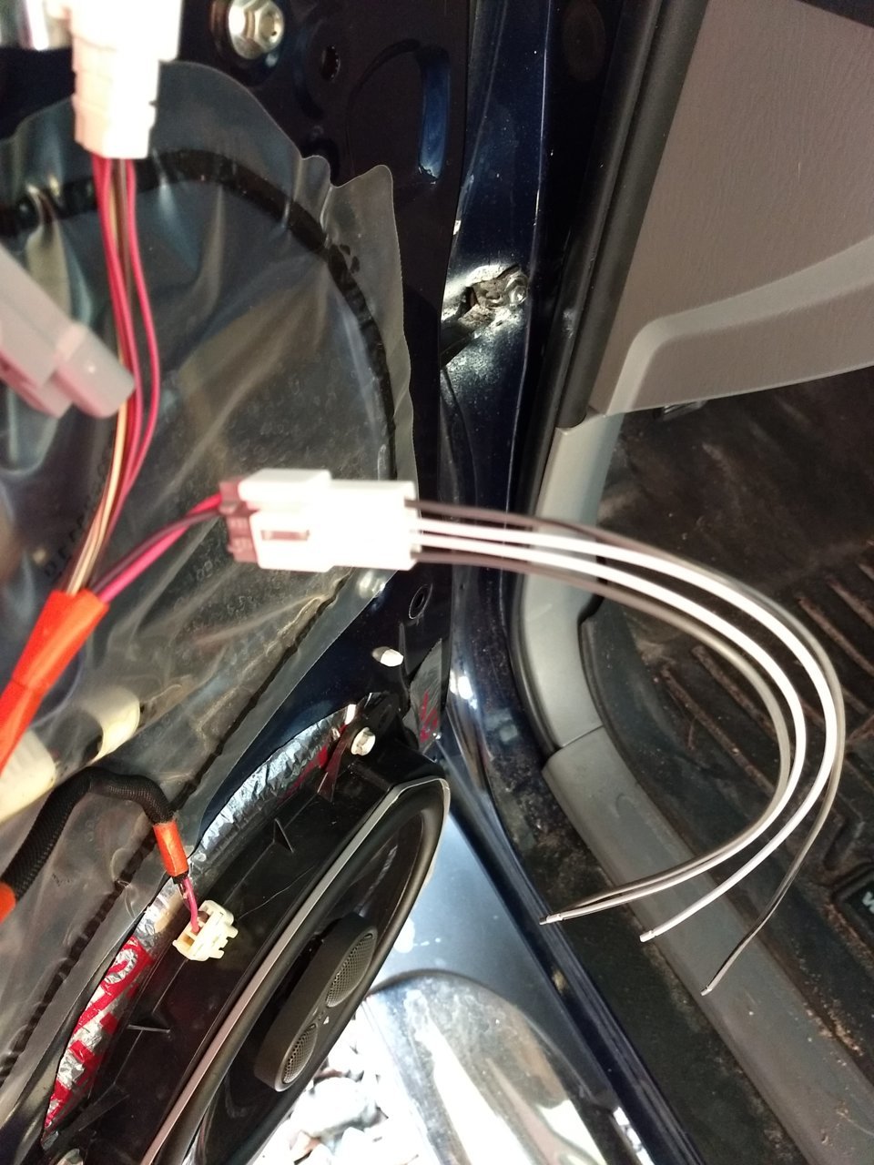

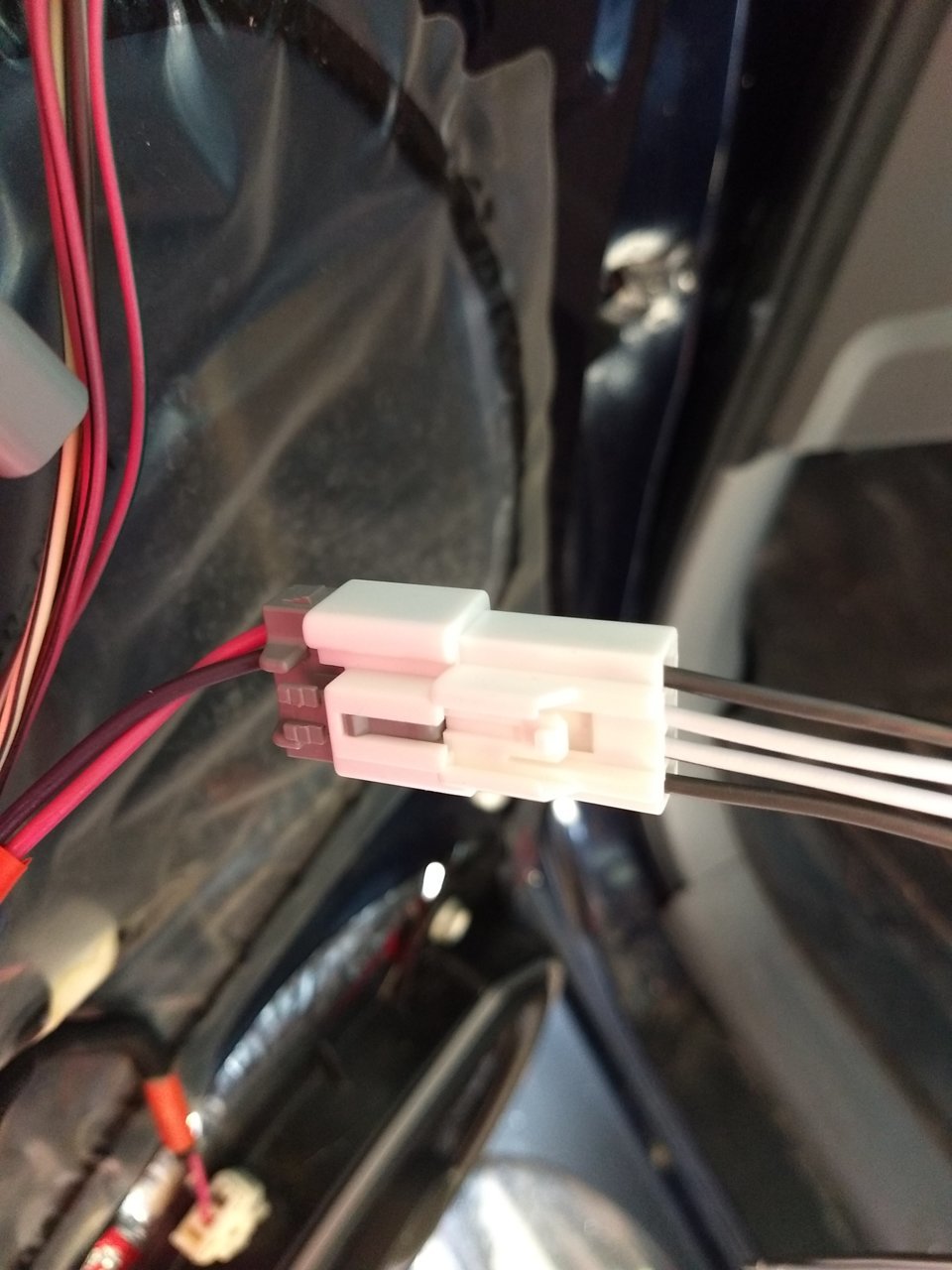

    Have a supplier that will sell these for $12.00 a pair plus shipping which should be priorty USPS at $3.50. Qty of 10 pairs or more. These fit my 2013 JBL system but I think they will fit non JBL also. Save cutting the harness. If there is a want for these, they will create a product page to purchase them.
    Probably could set up a group buy to get the min 10 pairs.

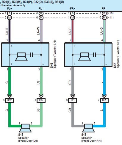

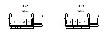

    I looked up the wiring diagram for both JBL and non JBL and they both use the same plug. S19 for LH door and S20 for RH door. The only differences between JBL and non JBL is JBL only has 2 wires to the tweeter while non JBL has 4.
    I don't have a 2016+ wiring diagram but we should be able to find the connector part number and order it and then pin it accordingly to plug right into the Subaru tweeter.

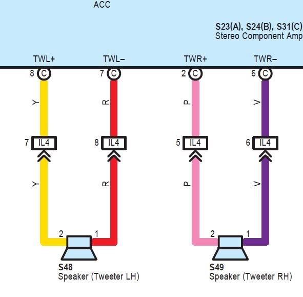

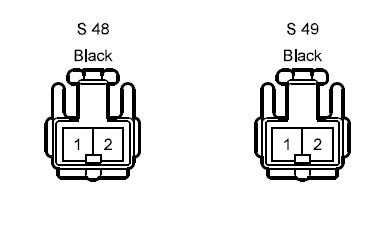

    Actually, I did find a 2016+ JBL wiring diagram. I don't have a non JBL. If any does, please post it. We already know the subaru tweeters work in a non JBL with a 4 pin connector. Just need that connector part number and then could easily wire it up.
