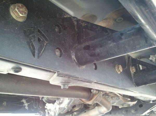

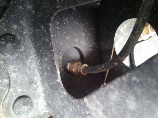

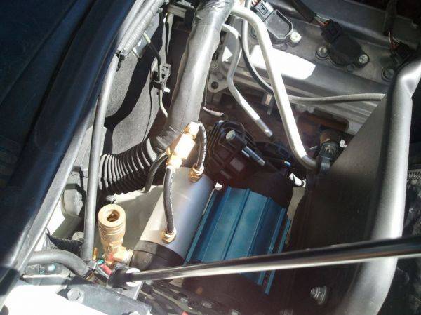

    Currently the sliders are only being used for the storage of air. There is only one hole in the sliders. Air is pumped into and out of the same location. The quick connect is still on the compressor. Remember, I was simply using this set as a test set. I wanted to keep 100psi in them as often as possible, to see if they fail. If I do these for production, they will have a bung on each rail for hooking up to. Also, a pressure relief valve will be used to empty the sliders of moisture.
    I will post pictures of the ones currently on my truck tomorrow to give all of you an idea of how it is done. :D

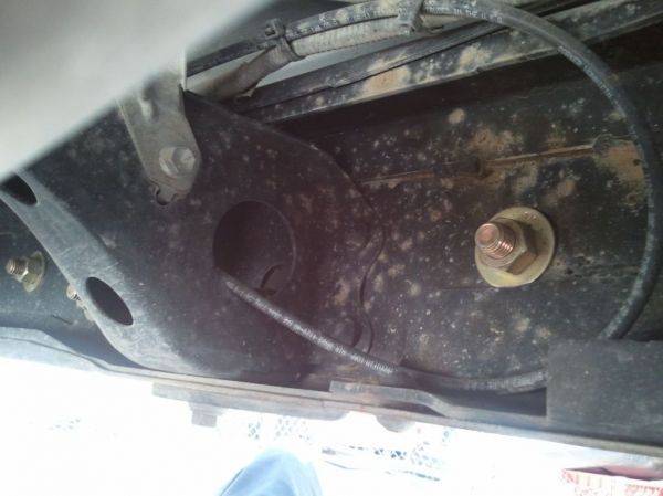

    400psi is too high. I'm not certain the tubing itself woldn't seperate. I would have three bungs, in, out, and drain. If you want more, I recommend the regulator below...
    Everything is pressurized except for 3 of the 4 legs from frame to slider. Yes, it's roughly 4 gallons total.
    The picture is the inside of the frame at the carrier bearing crossmember. Like said above, 3 holes in the sliders.
    :thumbsup:
    I would only probably test them at 200psi, rating them somewhere in the low-mid 100.
