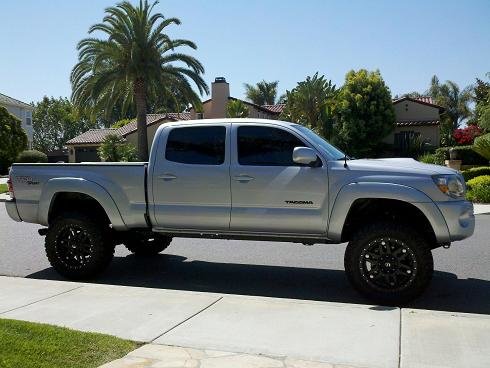

    SanMarcos, that looks awesome! As far as more lift in the rear, I think your only option would be a block. The frame hangs on the shackle, instead of sitting on top of it like the 1st gen.'s, if you know what I mean. It looks great like it is, but if you were to lower the front billies to .85" it would look great as well.

    I would take that billie all the way down to stock, I took my spacers off and put it back to stock shocks and I still have a slight lean back, only temporary until I get my coilovers rebuilt and I lift the back up with the Dakars and a possible shackle flip, but I think blocks are my best option, heres how mine stands now

    Cant take the billys down that far...had to trim some plastic as is and its really close to the body mount. The tires are a hair over 33" and WIDE! Probably will end up getting a 1" block.

    Thanks...yeah i'm thinking 1" block too

    If you like the 1.75" height setting on the front, I would just go with a 1" block or even a 1.5" AAL to give a little better stance in the rear. Those 305/55R20's look nice on there! I remember when I had them on my H3...really beafy. Are you running the Nitto Trail Grappler's?

    Yep they are trail grapplers, and yeah they are beefy! Stopped by 4WP's today and picked up a 1" block, will install this weekend.

    Yeah I will tomorrow, just gone done installing the block and longer u-bolts. Finished up as the sun was setting. Will take some pics tomorrow, measured and its even all the way around, really happy with the stance now!

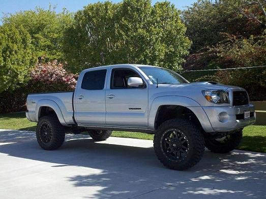

    Updated stance with 1" block

    A tubed bumper would look sic on your truck :D
