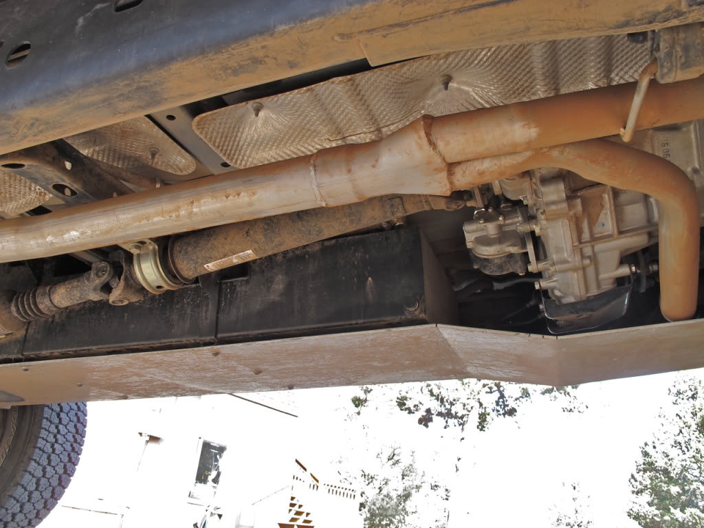

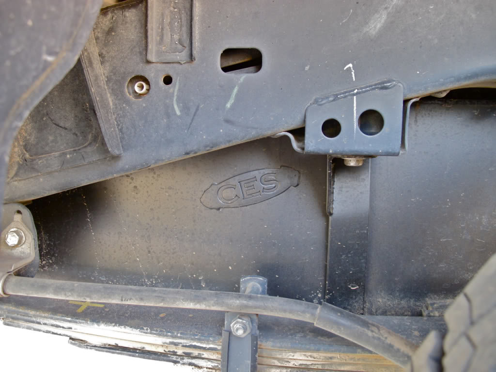

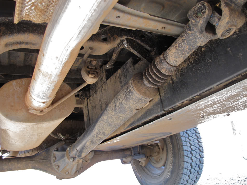

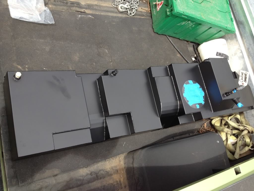

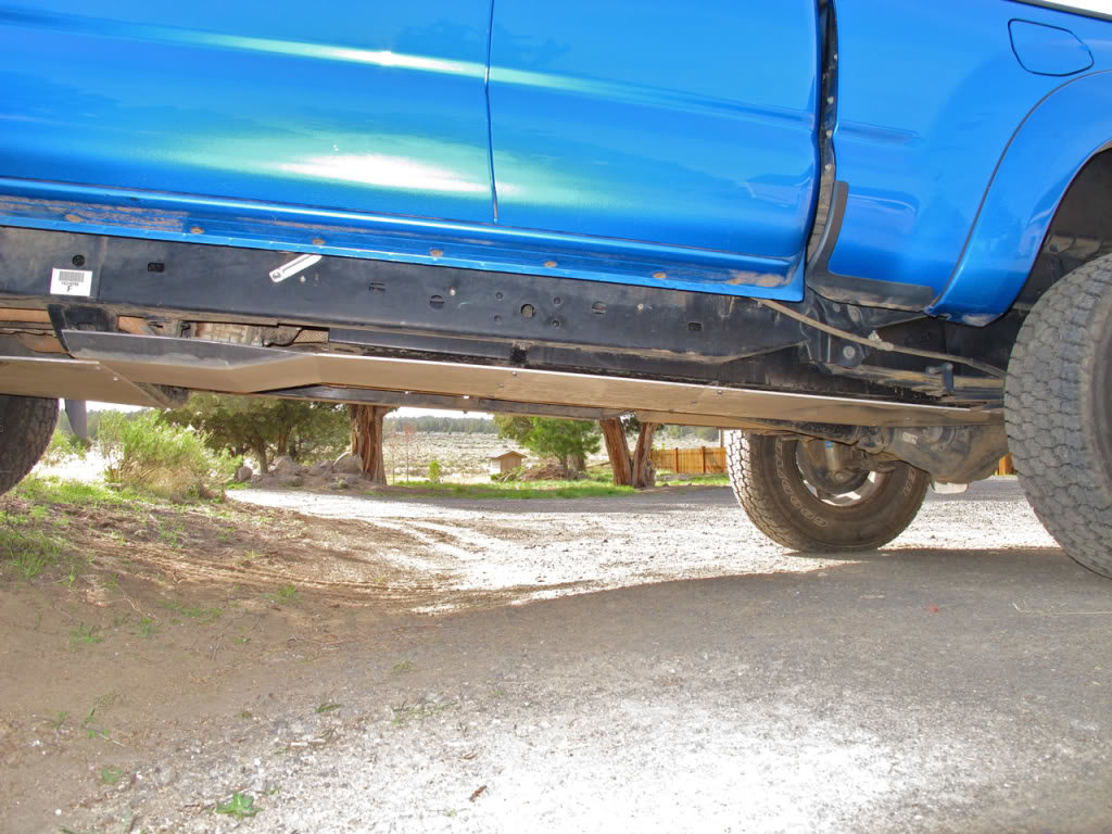

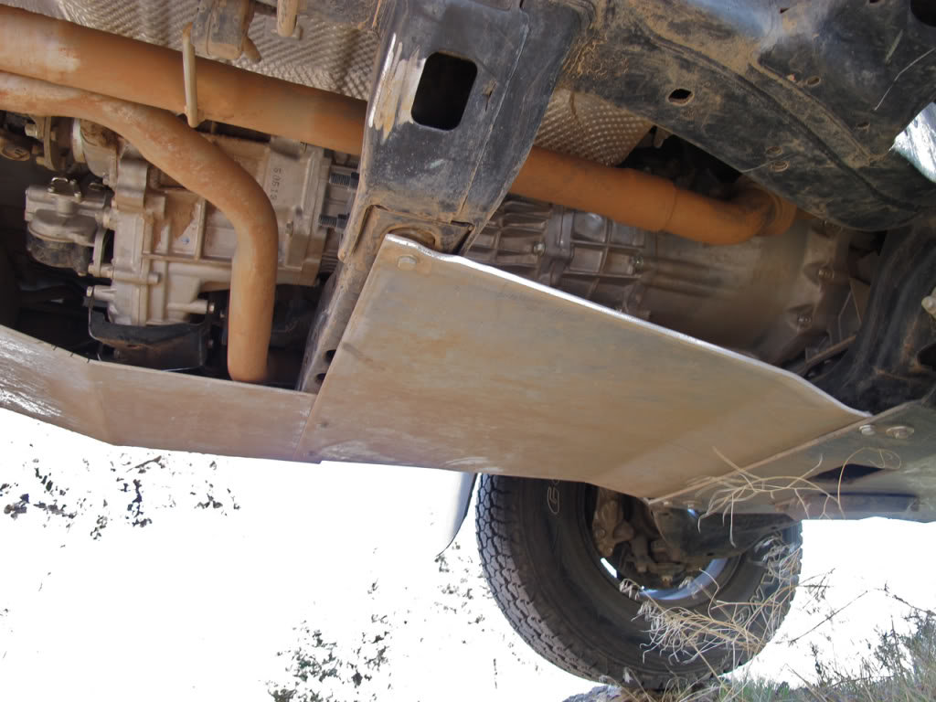

    Here ya go!
    Tank back from powder coating.
    Side shot showing tank and skid plate hang just below the frame rail
    I had Custom Exhaust add a lazer cut logo on the tank that is visible in the rear wheel well.
    Custom Cat Delete/Y pipe exhaust. This is not necessary to fit tank. Some exhaust modification is necessary though. You can also see the drain installed at the corner.
    3 Straps mount the tank, using the stock mounting locations.
    Aluminum skids were built for the tank, and a transmission skid was built to connect the fuel tank skid, and my Asfir front skid plate.
