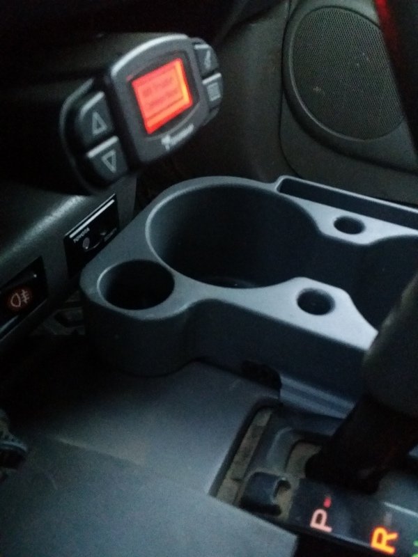

    Got mine yesterday going to install today! Were y'all able to drill the two screw in without removing center console or did y'all remove it to drill screws. Not trynna drill through any wires lol

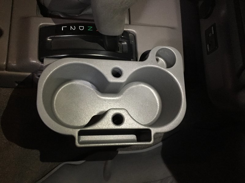

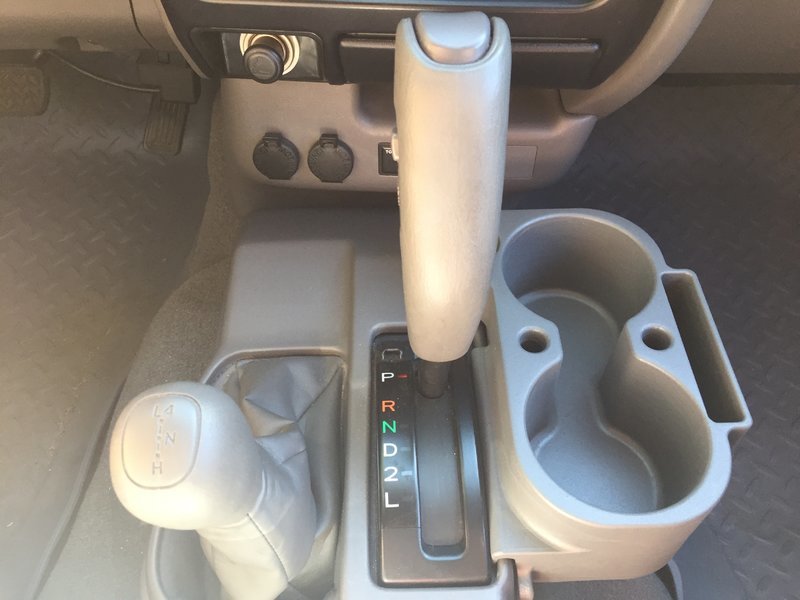

    I used the self tapping screws to start the hole while I held the cup holder in place as a template. Once I had a hole in there I just made sure there was nothing behind the console and then screwed it down snug.
    It's not screwed in on the first pic:

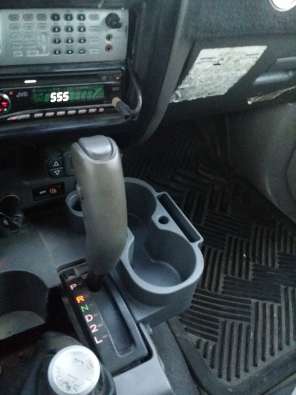

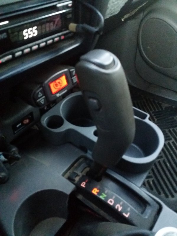

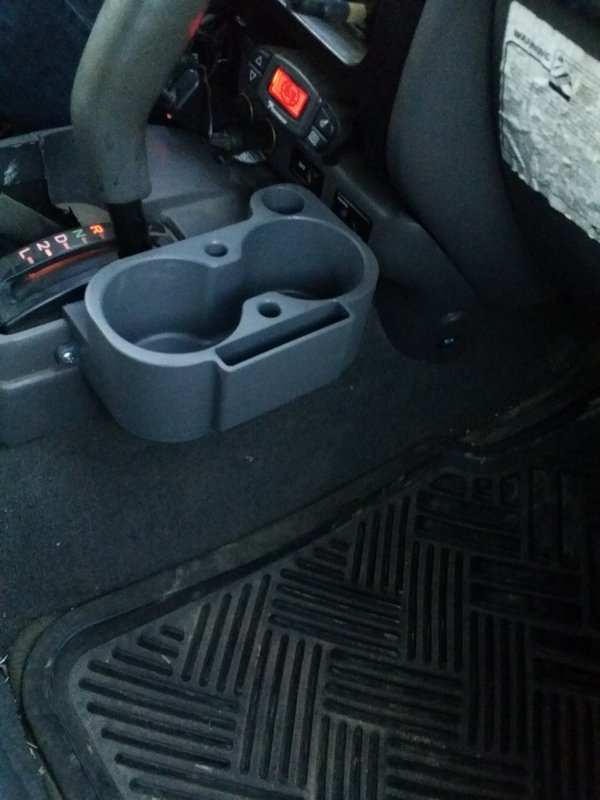

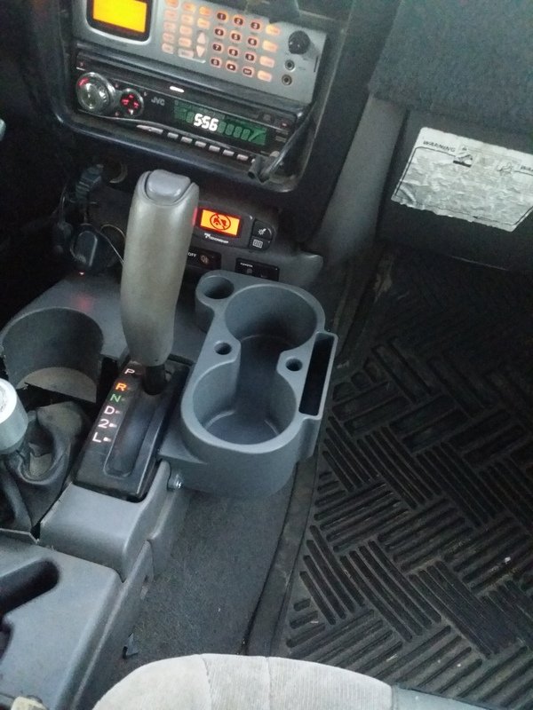

    Installed this yesterday.
    Had to do a few modifications, both clearencing and upgrading the hardware.
    Hardware - 1/8" steel screws w/speed clip on the inside of the console. This tightens up the console alot better.
    Clearencing - The cup holder lip that "clips" onto the groove of the auto shifter needed to be trimmed about 1/2-5/8" from the top.
    Reason being, extended cabs w/passenger bucket seat, slide forward to access the back seat. If the cup holder would of been mounted in the original design position, the passenger seat would make contact with the cup holder. The bucket seat can only move about halfway forward like this.
    So in the pics you will see how forward the cup holder is is order to clear.
