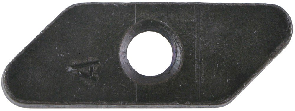

    These are the thule nuts that fit in their tracs. They have allen nuts you can get as well to fit those nuts.

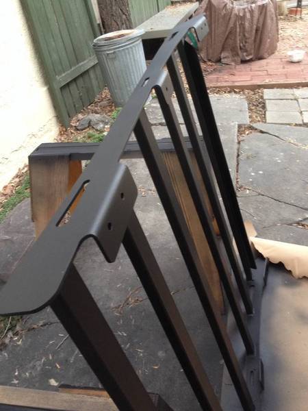

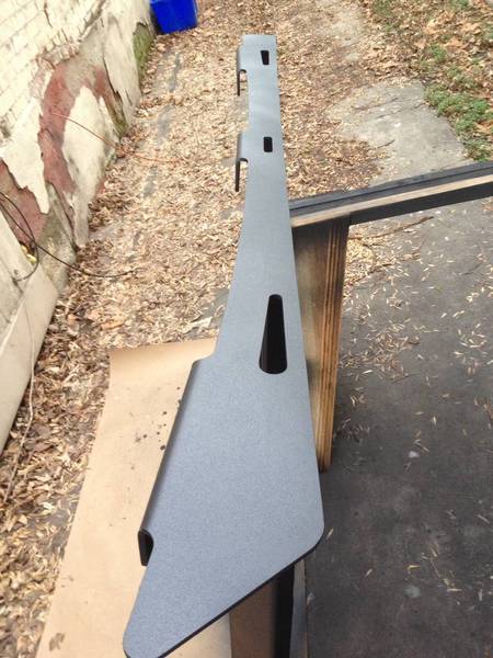

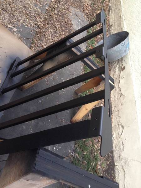

    Got the rack painted with a couple coats of spray on bed liner
    Zach, question about the rubber molding for the roof channels.. In your plans did you intend that the rubber molding be cut into sections & re-installed between the mounting points/feet? Or the channels left open & exposed? I am removing the oem rack to install the new one & realized that I don't have the molding strips on there. Something I hadn't thought of before. Will the mount points be sealed with the rack installed? Thanks!

    Regardless of whether or not you use the weather strips I would plan on using some silicone in the mounting holes to ensure a good waterproof connection. If you have the strips you can cut holes to fit the spacers or you can leave the strips out completely.

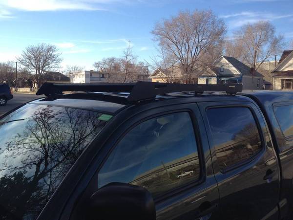

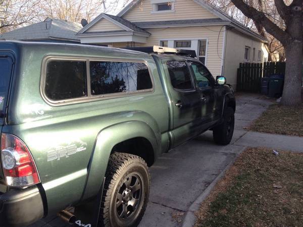

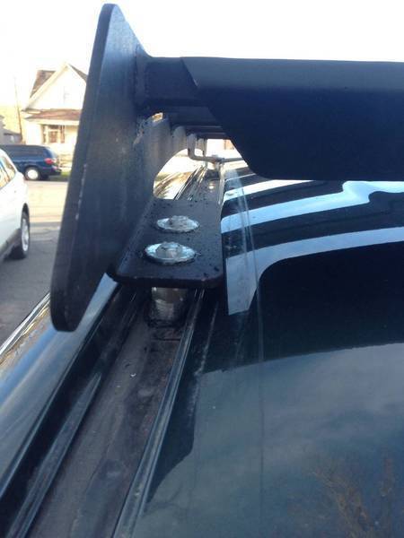

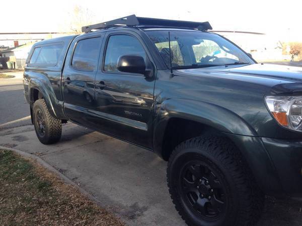

    Ok, got the rack installed!!! A bit trickier than I thought it'd be but very happy with the results.. Looks really good!! Wasn't able to get the basket & awning installed as I ran out our time, hopefully soon tho..
    FYI Zach, I did have to drill a couple new holes in the rack as the pre drilled ones didn't match the factory holes on my roof. Also one new hole in the roof since one of the factory holes was a bit striped from my previous oem rack. Was only able to get one screw in total on the passenger side rear foot. But super solid, I am very impressed with how sturdy it is. Thanks again, I am very happy with it!

    Glad you are happy with it. It looks great. I like the look of the changes better than the first (guinea pig) model. Thanks for pointing that out about the holes. I am going to probably just leave all racks un-drilled so people can make the adjustments themselves. I have test fit these racks on my truck, and one other and now yours. Basing the hole location off my truck it has been off on both your and the other which leads me to believe that my roof holes are a little off. Thanks for posting the pics!

    OP it looks like a carriage bolt is being utilized on the rack? If that is the case (or if it isn't) couldn't you just slot the feet where the holes are to compensate for the differences in tacomas hole location? I don't think it would even have to be the whole foot? Just an idea since I know most will want a more finished product to bolt on and go! I have an OEM rack and it was a PITA to mount because they were not perfect.

    Nice pics Jesse!
    Zach - Any way you can make the holes longer? So that there's some play to mount the bolts.
    edit: that's what I meant - slotted
