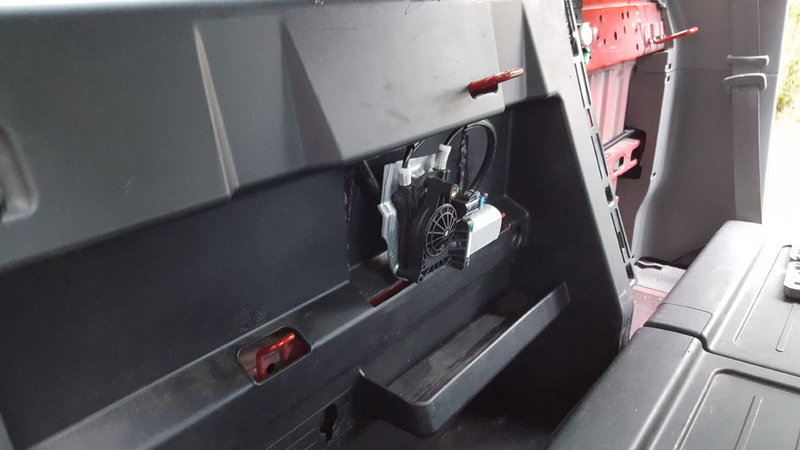

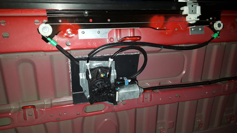

    I just used a Chevy one. Tight fit. The Ridgeline would have been easier. No doubt my most used mod.

    Could you please post a few more details on your set up? What year and model is the regulator assy from? Do you have a picture with the plastic re-installed?

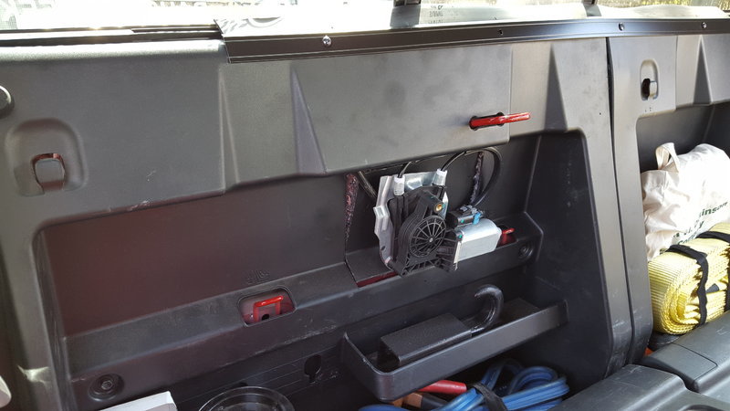

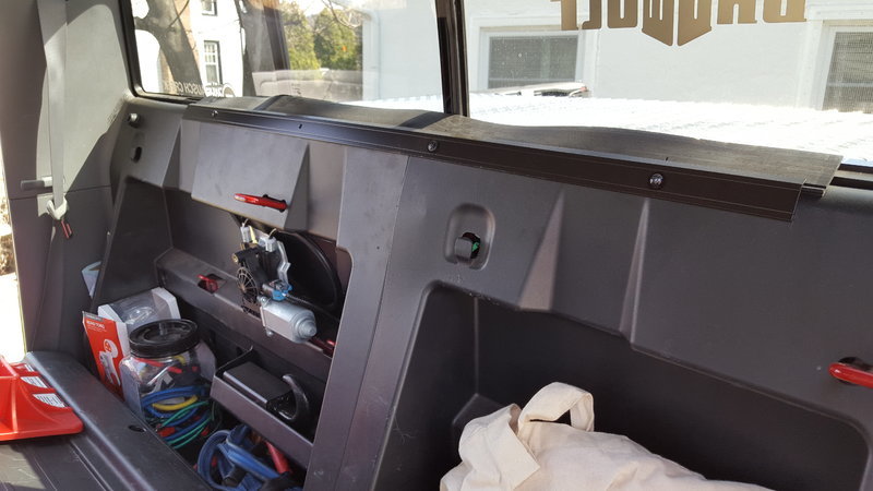

    This is while modding. I'll have to get a pic of it back together, too much stuff in the back seat to drop the seats at the moment. I needed to notch the top of the plastic to get a good attachment to the window, which is covered by a rubber strip. With the seats up you can't see a thing. I could cover the motor if I ran more often with the seats down.
