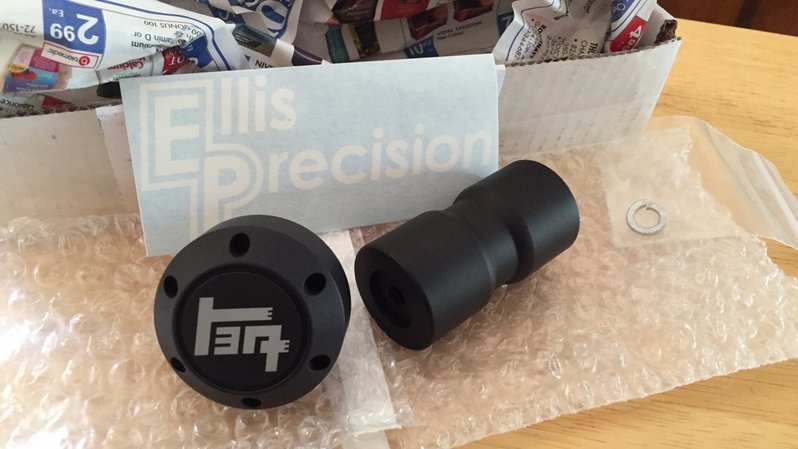

    Got my new shift knob from Ellis Precision to go along with all the new black parts :cool:

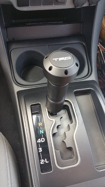

    https://www.tacomaworld.com/threads/nazlax10s-build.408318/

    That looks great! How long have you had it for?
